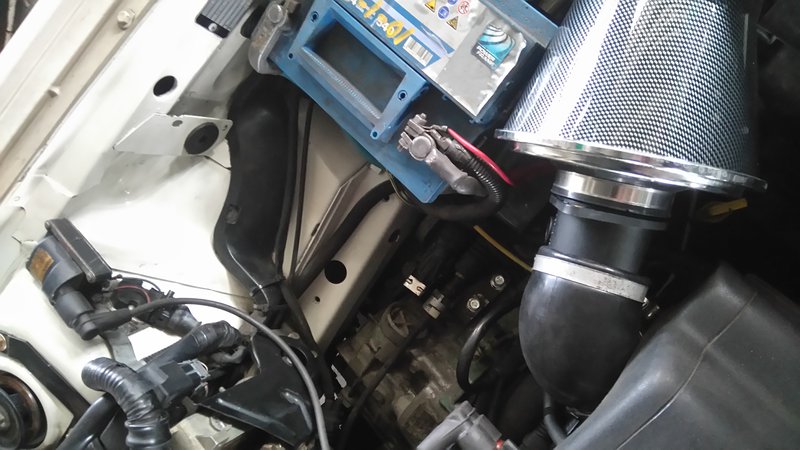

Hmmm don`t drive through deep water. Don`t have that much water in Copenhagen.
My new cone filter is higher up than the original box and intake itseft is in same height as the original.
Now I get the air directly into the throttlehouse.
In the original way the air have to travel 50 cm into the box then turn around through filter and then 40 cm into trottlehouse.
How can my way be more bad ?

Thanks for the details. Looks like a good, clean set up. Since I've dealt with my car's Christmas list of issues, it's time for a little bit of fun.jantt wrote:Re PS78
1. Filter I got from here. Don`t know who produce it : http://www.carlab.dk/shop/sportsluftfil ... 5287p.html
2. On my 1992 maf house is built into the airfilter lock, but from 1997 the maf is in a seperet house : http://www.ebay.com/itm/Mass-Air-Flow-M ... odel%3A850
3. Short hose is like this : http://www.thansen.dk/bil/autoreservede ... 469928642/
4. This is the original hose from trottlehouse to airfilterbox : https://www.aliexpress.com/item/Engine- ... .18.NYOZfK
(You use the bottom part of it with the two connectors)
So filter to maf house with clamp and maf house to short hose with clamp and short hose to lower part of original hose with connectors with clamp :
1 to 2 to 3 to 4 hope that will give you the picture
Havn`t tested it yet, but at the same time I ajusted the cams (exhurst cam 3 gr avanced) That I could fell.
PS the sound you hear in video is not only from the airfilter. Got a 2,5" simons exhurst on.

I see what Robert's saying - as with 99,99% of things that Volvo does, the stock setup is very well thought out and reasoned through, so for someone who's the "poster child for maintenance", experiments like this might be not be their thing.
That said, Volvo tends to err on the side of extreme caution. The V70s and 850s were marketed as luxury cars, but they still thought that they should allow for someone to be stupid enough to drive their car into water reaching 6 inches above the front bumper. Also, they set up their T5 engines to produce 226 HP, on an engine where a tuning will yield 300 HP and on stock internals that easily handle 400 and an automatic tranny that can handle 300 (not to mention the manuals...).
Most things that we do, like replacing the stock filter and box for an open cone filter, will probably override some of Volvos intended "margins", but only extreme modifications will actually make something fail. All my own, unskilled opinion, of course.
I like the cone filter - even on an NA, but I see Robert's point. So OP better not be driving through water above waist height.
