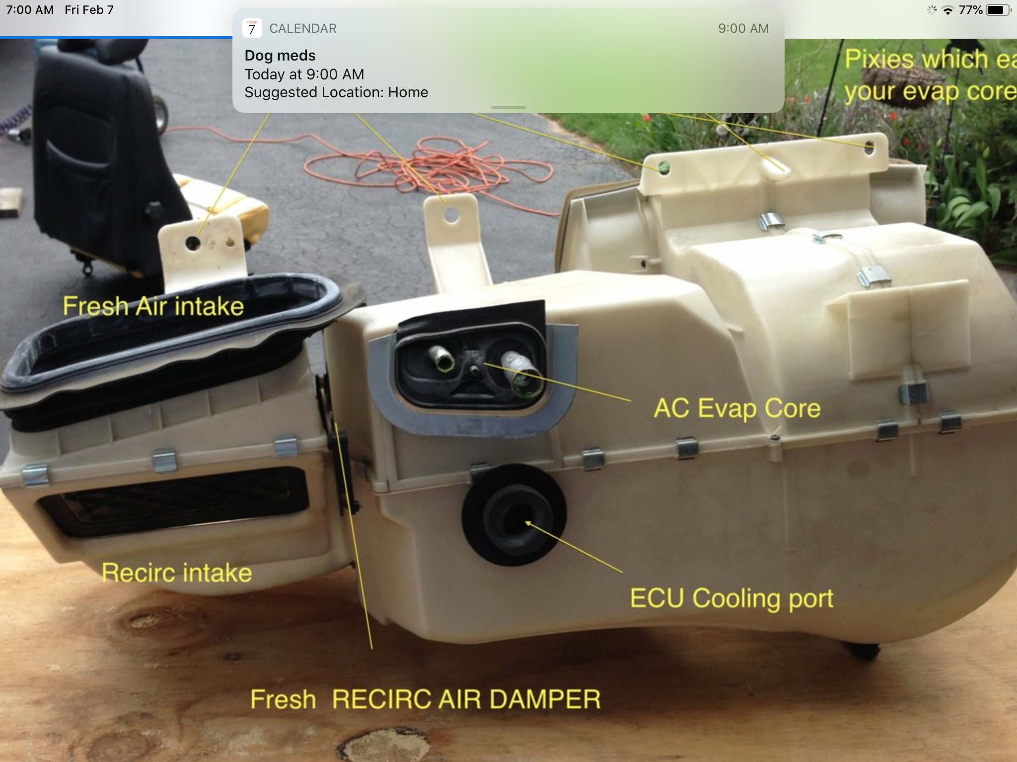

Starts in the 1999 model in North America, I think it’s called after run AC blower or something like thatRattnalle wrote: 05 Feb 2020, 05:23 Not using the AC is when stuff grows on there in my experience. Plus it's not good for it to be turned off for long periods. Just leave it in auto.
And hook it up to Vida and turn on the feature where it dries the evaporator by running the fan a few minutes after the car is parked. Or nvm, just realised that might not be relevant in this forum section.
Thanks!abscate wrote: 04 Feb 2020, 18:35 The air damper door right above the fan motor closed off the outside air and opens the interior ine
And the interior air door that is opened is located where?
Does it air in from the passenger side under dash?
I'm looking to put an ionizer next to it.

Passenger side just above your feet. Trying to remember if there is a kick plate to remove, I think there is on my 1999

I knew I had a good picture from my April 2013 AC evaporator replacement
The flap pivots down to close off the interior vent to let in fresh air, and pivots up to shut off the cowl vent and allowing recirculated air.
