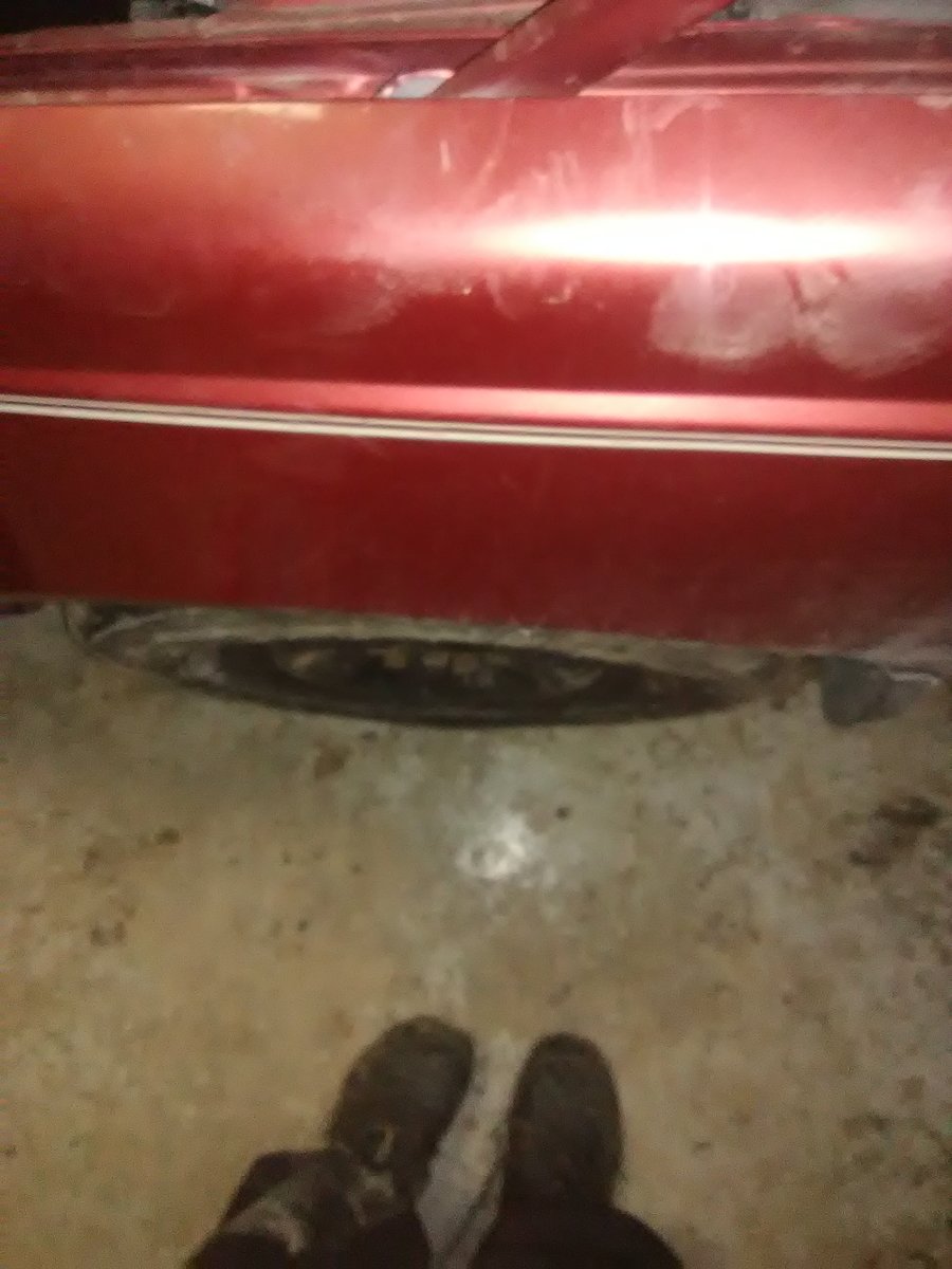

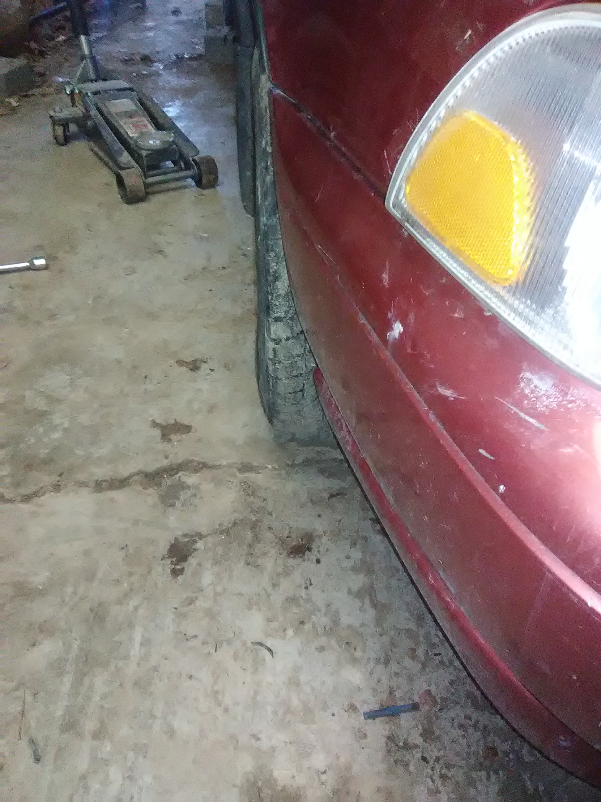

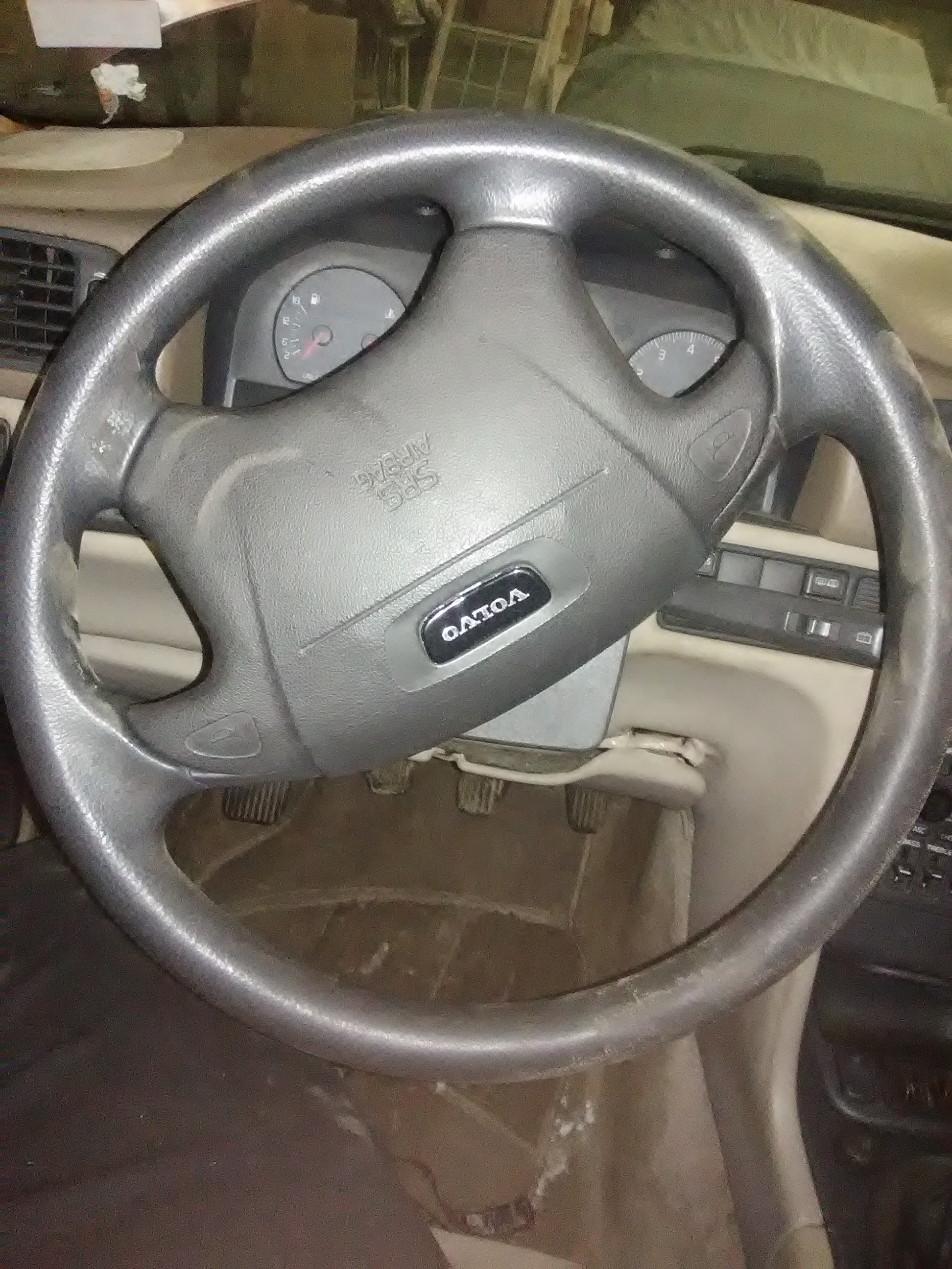

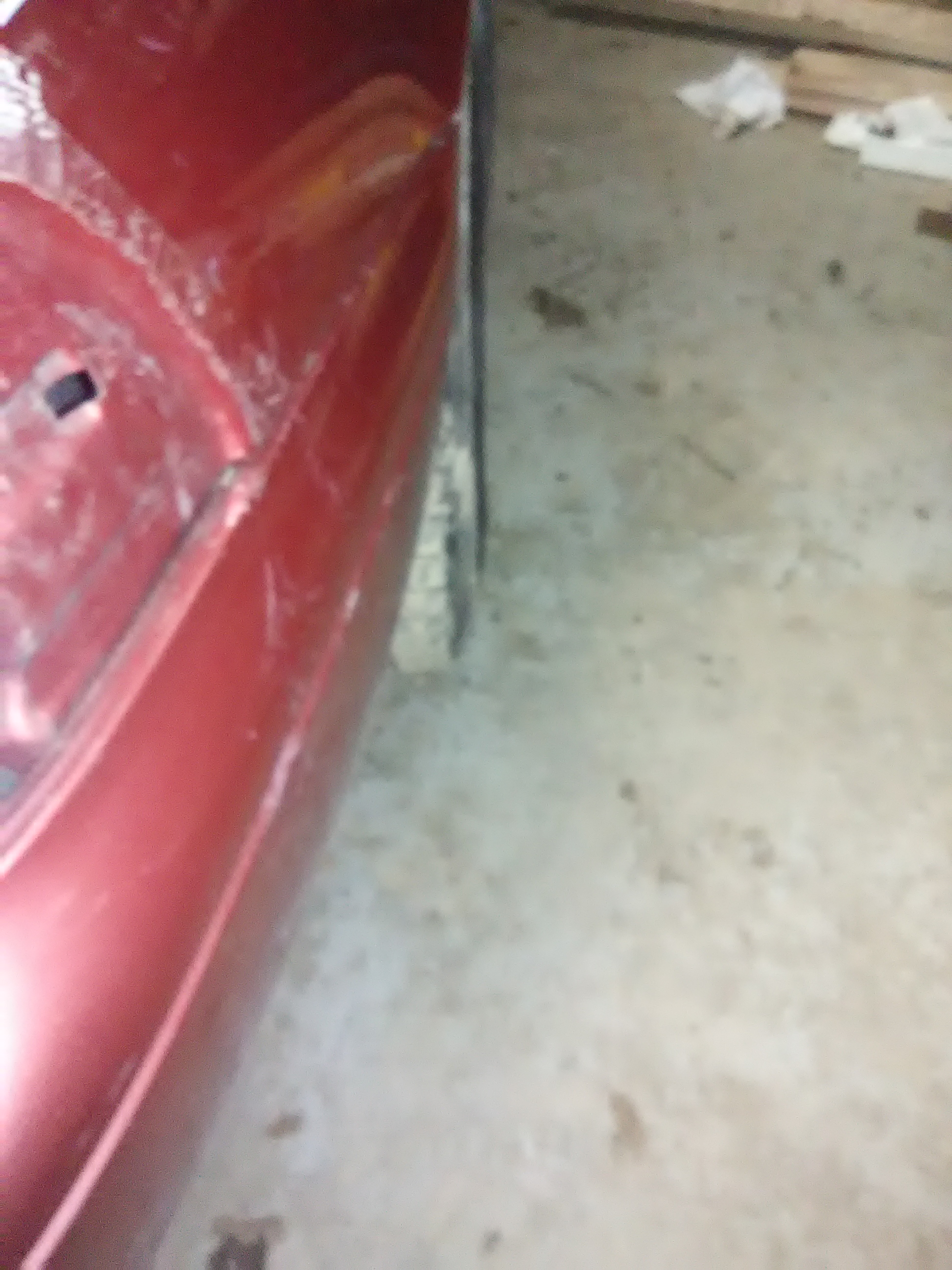

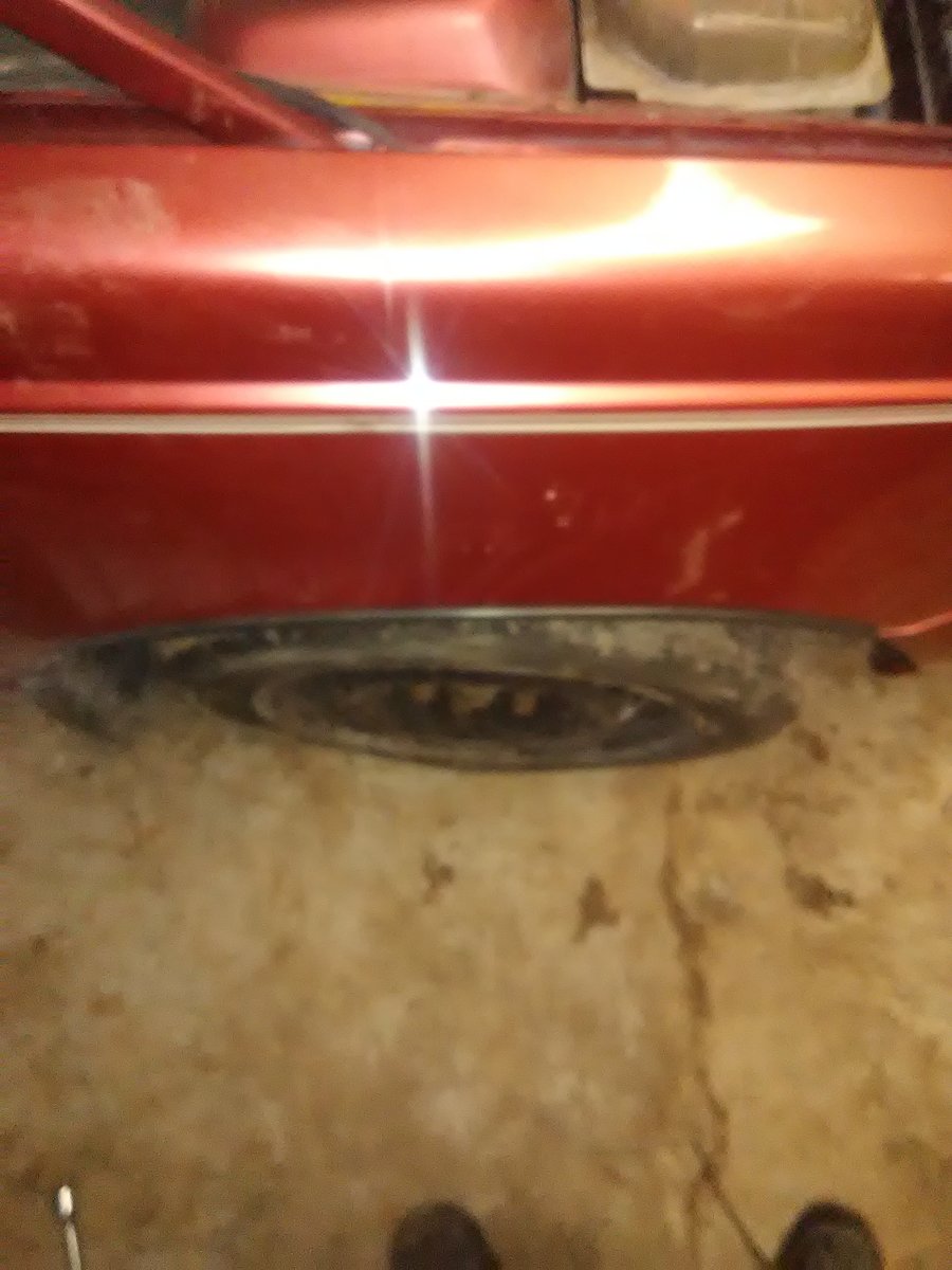

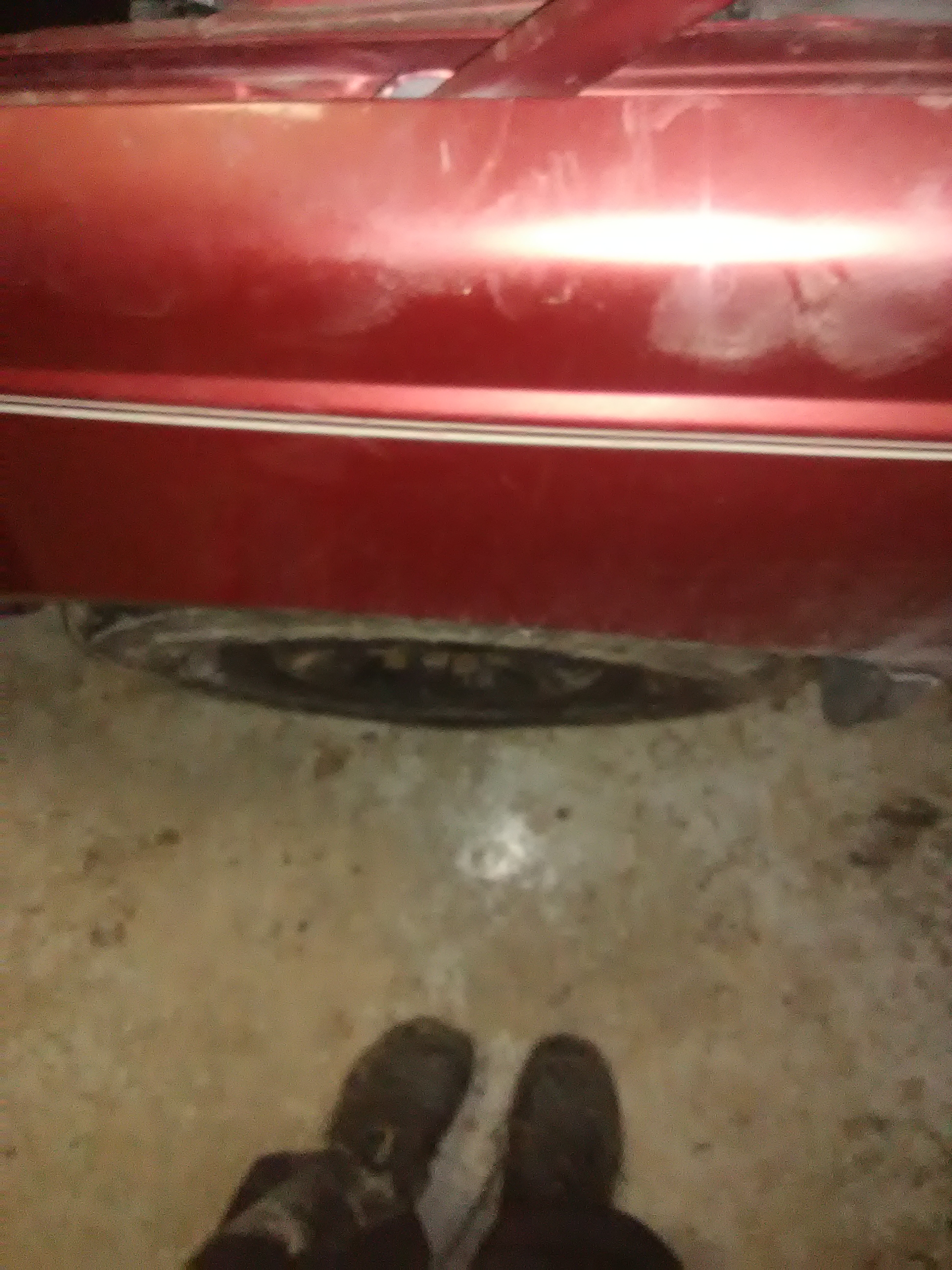

So I didn't have time to get the rotors off to get to the wheel hubs and really look at them but with the rotors on everything seemed tight and together, no excessive gaps I could see or movement I could feel. I put the wheels on and bounced it around a bit, the strut mounts seemed solid, my driver side sticks up further than the passenger but it's been like that for a while and I know it needs replaced but with the impact being on the passenger side I don't believe that's my current problem. I also took a few pictures with the wheels on incase anybody was curious how much my wheels were out. First is where my steering wheel is at, then the next two are my driverside, followed by the passenger side where I hit.
