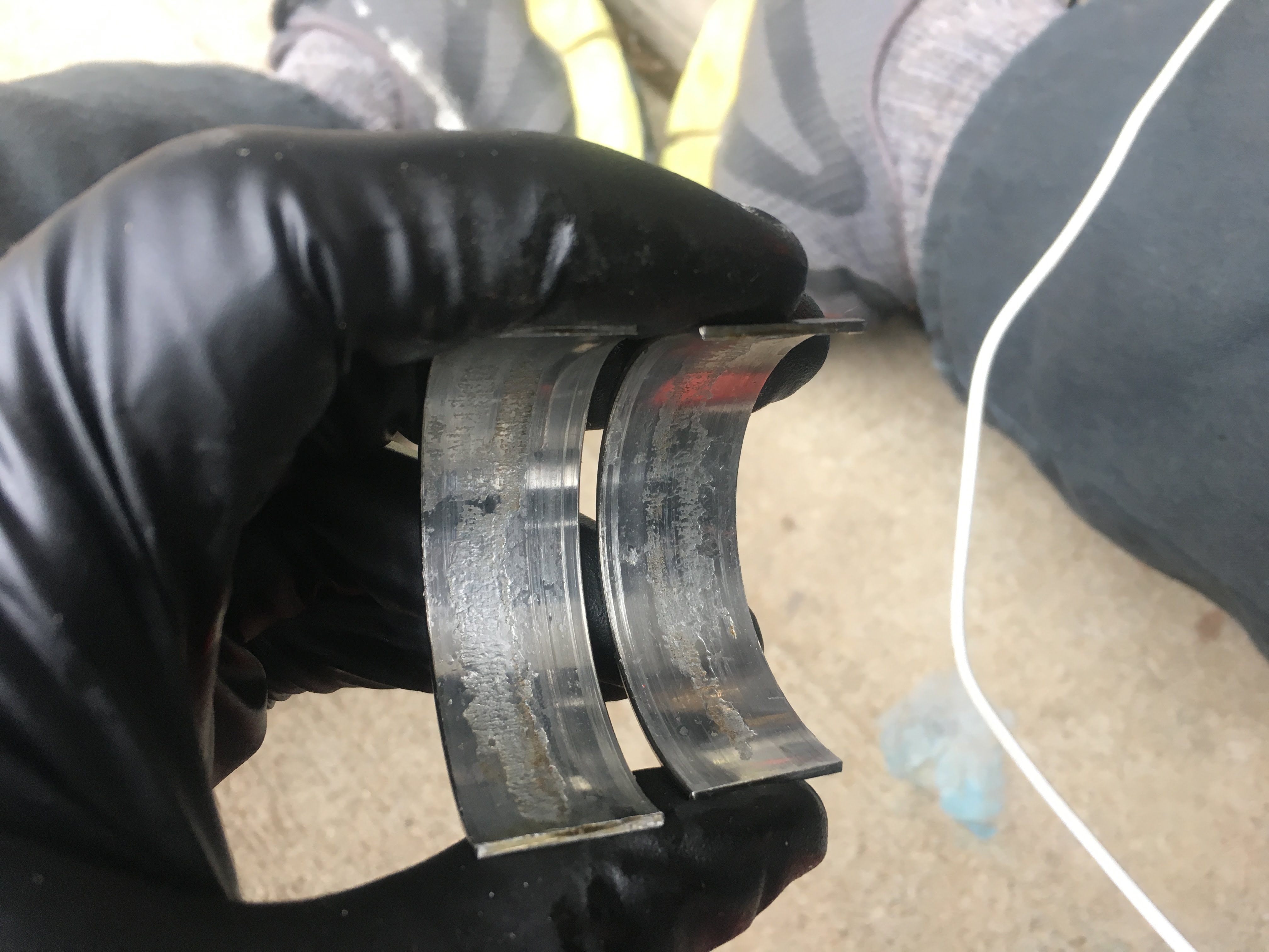

I also removed the bearing shells on #4, ones that started spinning and shifted to the side. The bearing looks pitted very badly, and I realized there was a chunk of metal in the oil hole on inside the journal. I got a picture of the pitted bearing, but not of the metal chunk. Tried to pull it out with a pick, but it only retreated further into the center. I placed an order for 5 new STD size bearings, can't imagine even the worst one needing a whole 0.25mm plus size, but now I'm more worried about chunks of metal floating around the oil passages.

You are in a pickle here. The problem is those bearings all spun for a reason - no oil. What other damage may have occurred is unknown and cannot be known without pulling the head and inspecting the head, cams and journals and cylinder walls and piston rings.
Were it me I would find the cheapest standard sized bearings you can find - assuming your crank looks fine (the one photo that shows it looks good) and assuming your rods look good - and just swap out the bearings. You cannot do anything more without pulling the crank and rods to get them to spec as they require machining. Plastigage will just tell you what you will end up with, but without throwing more money at the engine for maching there is nothing you can do. Remember you don't know what the pistons and rings look like or the top end.
QUESTION: Can you pull a couple main crank bearings for inspection? One at a time?
That is why I say get in and out for the least amount of money, change your oil and filter afterwards a couple times to factor for metal floating in the system which will be caught by the filter.
Do the bare minimum and hope the rest of the engine is solid. If the crank and rods visually look good move forward with the cheap route. You will know pretty quick if it is burning oil and tapping like crazy that the rest of the motor also took a beating. Rod bearings, if that is all you swap out are about $50 - so you can be in and out for about $125.00 (plus lots of love).

I've been thinking about that chunk of metal in the crankshaft all day. My conclusion is that the only way it could have gotten into the oil passage is from the journal of the spun bearing, because it was too big to pass through the oil pickup mesh. This means that metal chunks are probably limited to the crank, which is good news for the top end (provided oil starvation didn't cause too much damage), but bad news as I proceed with replacement of rod bearings. Who knows how many of those chunks got into the crank, and if they are eating away at the main bearings already. I don't know if I have the gumption to unbolt the intermediate part of the crank case to inspect the main bearings. I will ruminate on that for a couple more days. The rod bearings will be arriving on Saturday.
Herman, how did you arrive at that $125 figure? The cheapest rod bearing I could find was Glyco at FCPEuro at $39.xx, and I went with 5 of them, knowing that they will let me return whichever I decide not to replace. I'm still trying to make peace with that purchase, considering that a complete set of 6 rod bearings for my Jeep Cherokee would only cost $11 on RockAuto. Considering I've owned my BMW for over two years, I should be used to paying premium for the parts made of unobtainium, but it still stings.
