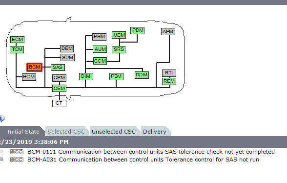

Finally got VIDA to read the codes, yay! Got a whole bunch on the first read, some of them were complaining about low voltage (9.4V) to the BCM unit, but I know I've recharged the battery since, so I cleared the first batch. Second reading only returned two codes: BCM-0111 and BCM-A031, both SAS related. I yanked a clockspring from a V70 at Pick-n-Pull, PN 30798167. Searched that PN, could not get a clear indication whether it had DSTC or not, but one of the searches redirected to PN 31313083, which I know is DSTC part. I'll plug it in and see what happens, doubt it will make it any worse.
