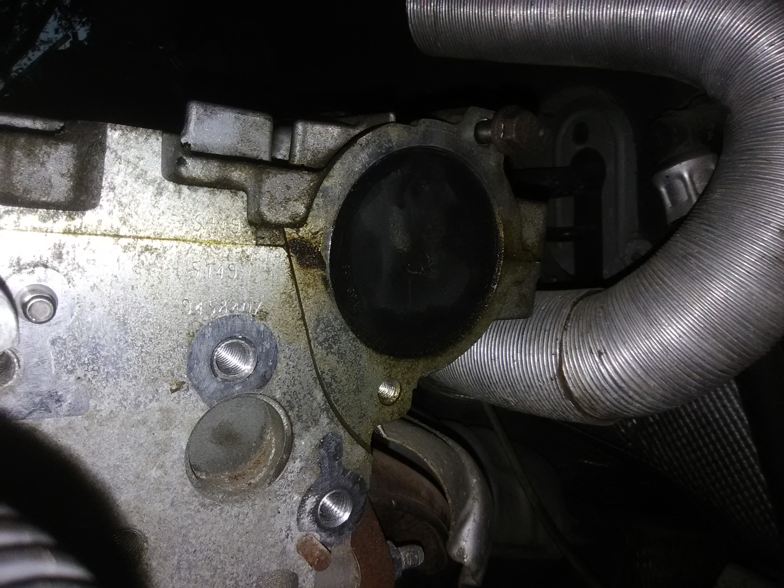

Also, once I have the lock tool in place, how do I remove the cam cover? It's on there pretty good lol

The black plug is a metal-plastic “blank” that covers the rear of a camshaft that doesn’t have a camshaft position sensor (no VVT hub on the other end). To remove it you pierce it with a screwdriver and pry it off. It’s not meant to be reused so you’ll have to buy another one. They’re only $3 or so.

I got through it with a little screwdriver, but I've been trying to pry it off for several minutes now lol also the screwdiver I was using to pry now has engine oil on it. I'm assuming I need a new cam seal.

No, that's normally got oil inside I think. Mine doesn't have that, but all videos Ive seen show oil dribbling out. I think you should always do new seals unless they've been changed recently.
Bigger screwdriver, give it a yank!

Oil behind the cam cover plug is normal and drains through a weep hole back into the engine. My volvo dealer had this in stock when I did my Timing belt
