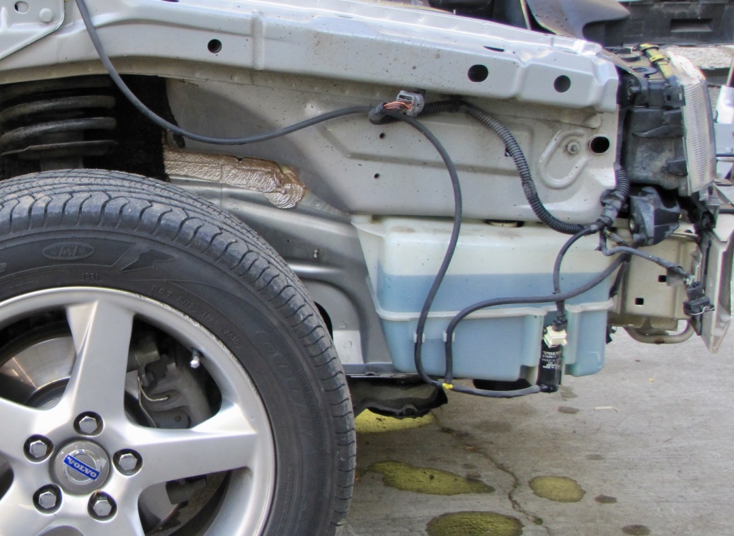

Gonna be tough...
Washer fluid tank is
buried way down there.
Maybe a vac syringe
with a really long hose?
Maybe a vac syringe

Just let the system continue to spray until out, then refill with winter fluid. Then run again until winter fluid sprays to flush lines. just did it a few days ago in my S80. JuneBEJinFbk wrote: 21 Nov 2018, 14:13 Gonna be tough...

Just pop a hose off a fitting - the pump will empty the reservoir without the nozzle very quickly.BEJinFbk wrote: 21 Nov 2018, 14:13 Gonna be tough...
Maybe a vac syringe
When I use a gallon of squirt juice in a day, I know I have lost a headlight washer hose.
