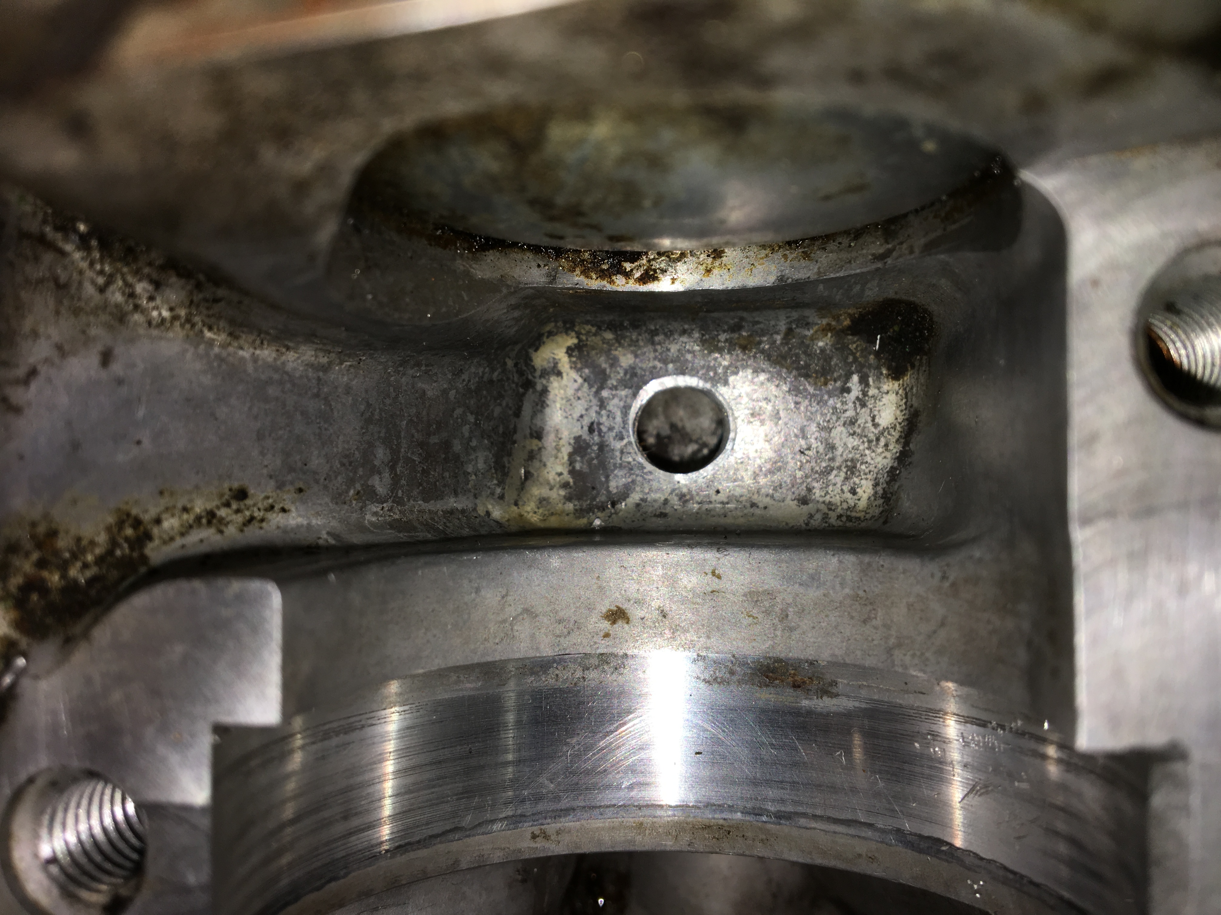

Those bearings are both industry standard. A good part supplier, if you have one with some good people, could measure ID, OD and width and get them. They may not have brand choice though. The roller count can and does vary in the same industry number bearing.
The drain hole to be drilled is easy and it's aluminum. The CRITICAL note is to limit drilling to the one wall depth. 6mm is ample travel. If you go through the cavity that is open to bell housing/back of block and go through the next wall that is the crankcase just above oil slinging crankshaft bits.

They didn't ask me but it seems a better thing to do in the rear bearing saddle area is to take a Dremel or other tool with a burr and grind a groove down the bottom middle. There is a hole in the balance shaft case that goes into the hollow cavity already. If debris blocks the drilled one why have the water go to the mid point of bearing before it can run through the ground reliefs on saddle sides.

jimmy57 wrote: 01 Jan 2019, 23:13 The drain hole to be drilled is easy and it's aluminum. The CRITICAL note is to limit drilling to the one wall depth. 6mm is ample travel. If you go through the cavity that is open to bell housing/back of block and go through the next wall that is the crankcase just above oil slinging crankshaft bits.
jimmy57,
Thank you, I think that is highly important information! I had not realized until your comment and looking at the diagram that I really only need to drill through 3mm of material, with a few mm of cavity below. It would be VERY easy to go too far!
Tonight I was able to pull the old inner race off the back of the Balance Shaft, and the BS looks to be in very good condition, no need for replacement.
Roger

Not much progress lately. Ordered parts, waiting for them to arrive. I decided to do the water pump while I'm at it - I would be really unhappy if the existing water pump with 140k miles on it chose to fail in the next year, so I figured I'd do it now.
Parts have been straightforward, but the fluids have not. Volvo no longer carries the recommended thread lubricant or timing cover sealant. Fortunately FCP had a Wurth version of the sealant, and AutohausAZ had the Febi version of the "bolted joint compound". The "bolted joint compound" seems to be a thread lubricant / anti seize, but without the chemicals that are bad for oxygen sensors and the like.
I did get the hole drilled. Here's what it's like:
Exciting, I know. :shock:
Next week I'll hopefully have some tools together and can start on re-assembling things. Cheers!

This is VERY cool. You're already way ahead of anything I've personally ever seen on one spot, thanks for your continued posts and photos.
