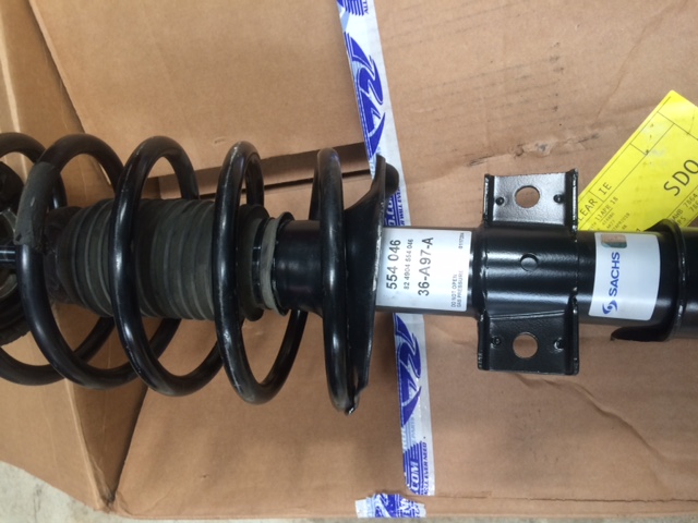

Then on to the front struts. They are SACHS blue sticker units and not Volvo originals. It surprises me that at the current mileage of 121,000km (about 76k miles) it has already destroyed at least 2 sets of front struts. When I got the springs off it became obvious how shot they were!
Old New I thought I had bought blue sticker SACHS but the ones shipped have white stickers but the same part number as the blues I removed. Spring seats are Volvo brand and in very good shape, so I left ‘em.

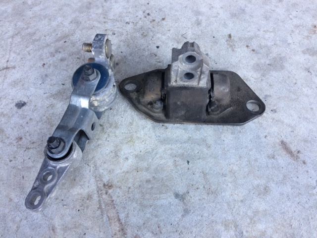

Next job was the front (or right) engine mount and transmission torque mount. To my surprise the front mount looked in perfect condition but no brand markings. The transmission mount was a hateful Scantech with a poly bush in it so good riddance. Both replaced with Hutchinson.
