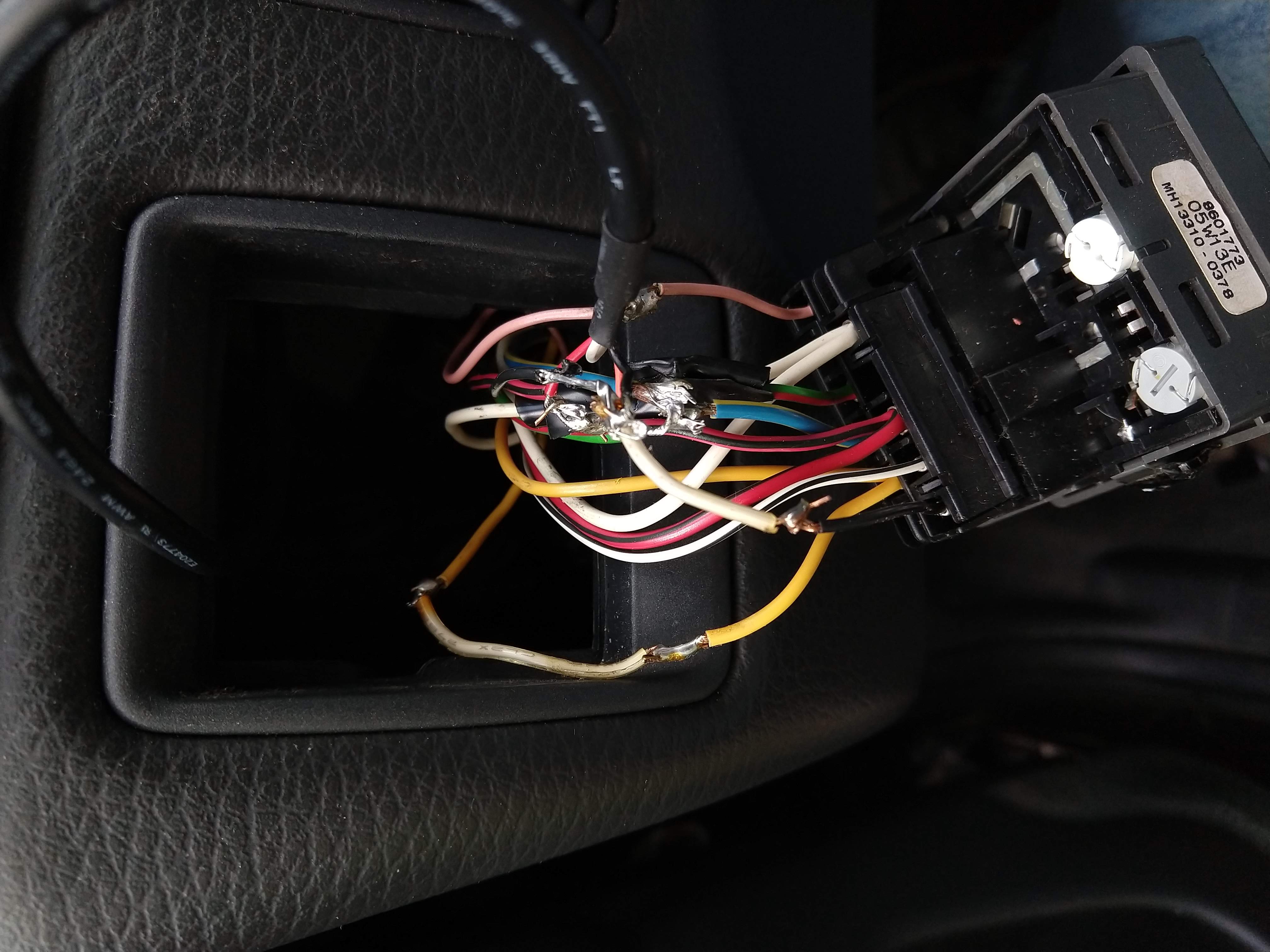

Another fun filled day. Boost gauge started behaving weird. Then car cut out along with lights, boost gauge, and dash. Fuses were blown for the immobilizer, dash, light switch, and headlights. Popped out the light switch and was greeted by perhaps the worst wiring job I have ever seen. Like seriously... this is horrendous. Who takes the time to break out the soldering iron and then does this, and doesn't even bother to tape up the exposed wires? Spent a good part of my day fixing this hack job, insulating it properly, and uninstalling the boost gauge. Makes me wonder what other wiring projects the PO attempted.

Impressive is right! That's worse than the crap I had to fix on my old 740 turbo!
Why did they use vampire clips or something? Those things are basically idiot proof. You don't even have to tape over them!
