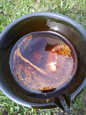

I drained the oil and see what I found out when I was disposing it...
Now, this car only drove 5000 miles from June 2018, of which only half of them are on a long trip in December, the rest it is all short distance, like 10 miles/day and... we have very cold winters here.
Now, it is also true that last year I did roughly the same mileage, but I never saw that sludge before.
The car has 160000 miles.
Until few days ago the car was perfect, how is this possible I did not get any sign that something was wrong before?
What is the connection with the low oil pressure, leaking throttle body and the sludge?

That’s just water and oil mayonnaise from cold running.
With your new oil, give the car a hot run to help get the water out. You might find your oil pressure is back up.

Metallo wrote: 12 May 2019, 07:00 December, the rest it is all short distance, like 10 miles/day and... we have very cold winters here.
That will do it. Water condenses out of the air in the crankcase. With the short runs, the engine does not get hot enough, long enough to evaporate the water.
Water being denser than oil will sink to the bottom of the sump where the pickup tube is.

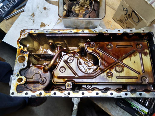

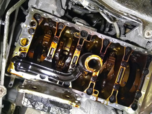

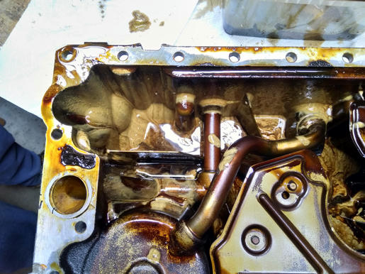

OK, I managed to remove the oil sum.
Apart the mayonnaise :lol: I cannot see metal traces.

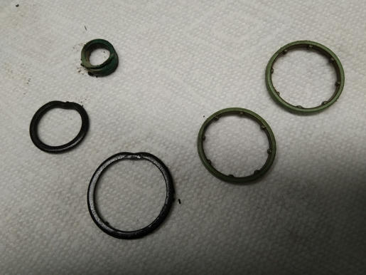

The two black o-rings are no longer 'O', I think I broke the dipstick one while removing it, it would have been impossible to remove it from top, so I pulled down the oil sump with the pipe, then one foot on the oil sump and two hands to pull out the pipe, it was extremely hard to move.
The cooler rings seem to be fine.

  • How do I clean the oil sump? Fill it in with a de-greaser and leave it all night in?
  • Should I also change the oil cooler-to-filter o-rings? So in total 7 o-rings?
  • Should I change the oil sensor to be 100% sure it is working?
  • How can I get to the inlet mesh and clean it?

Any degreaser will get that out, just running the car hot will do as well
Replace every oring you can.

Any quality anaerobic should do, I see no reasons why Permatex won't work
How is the oil passage from the PCV box, I think is this one, it should be cleaned nicely. See on the corresponding hole on the block side too. It is perhaps good time to also replace the PCV (maybe once the pan is back, a quick 'glove' test, shown on Youtube)
May test by hand for any play in the rod bearings
I'm not sure but there may also be a bypass valve at the oil filter housing area on the oil pan, may take a look
The inlet mesh, can you undo the whole pipe? I would just try a water hose on the other end, gently.
