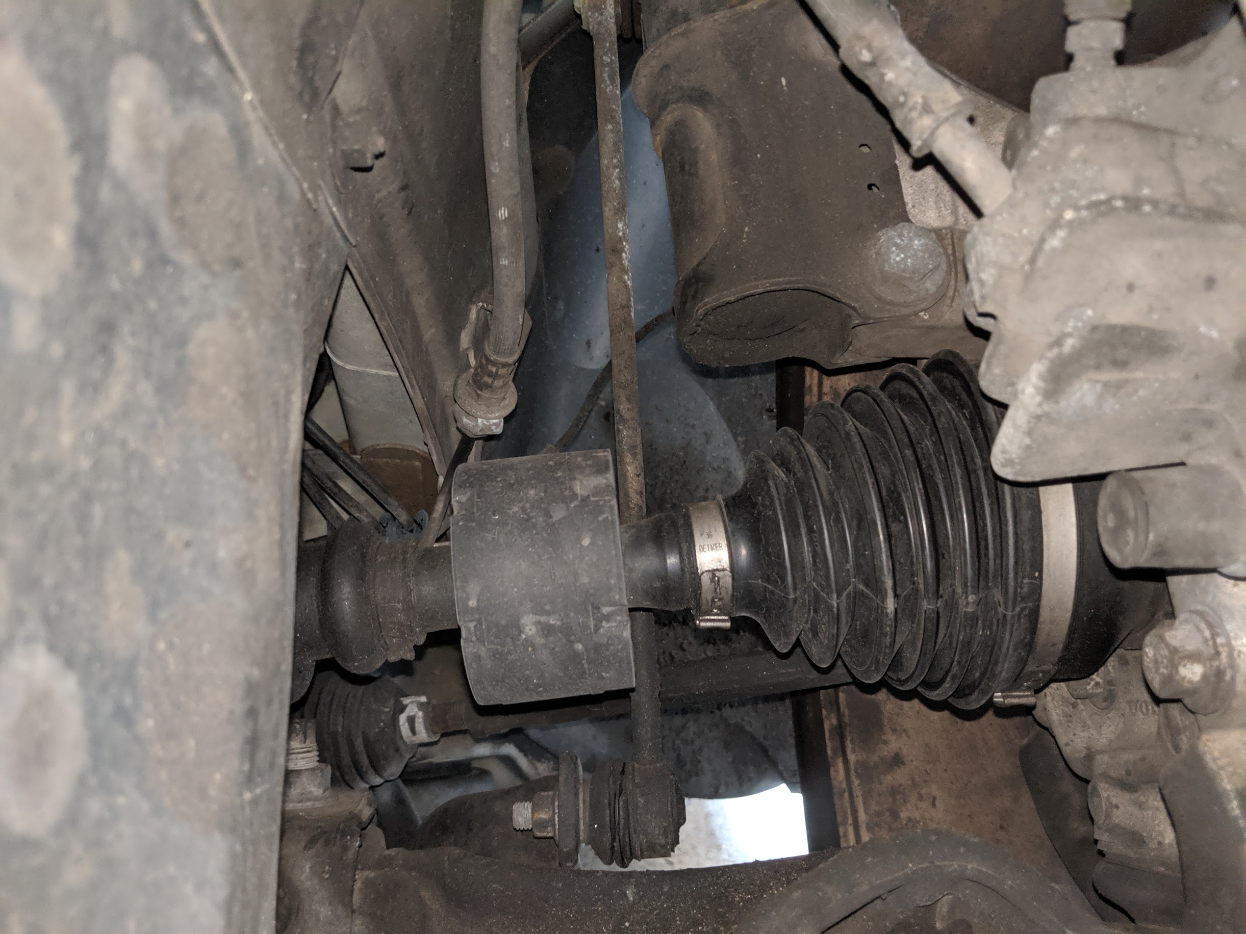

Here's a pic of my GKN 303420 (yes it's plastic) after about a thousand miles. everything's fine; though my mechanic who "swears by the blue box" ain't putting any guarantee for it, especially with the belief that rubber is superior. I think GKN would be the last company to sell you cheap plastic, let alone "thermal-plastic". I'd say you'll be fine.

Thanks for the photo.
Since I am sending the car far away for my kid in college (Durham NC area), about 12 miles from me...
My concern is not the longevity (how long it lasts).
My concern is the plastic boot coming off (from reading VW, Audi forums).
I will inspect the existing OUTER boot, if OK at 110K, and I may as well keep it for now.
Then when the time comes, use the plastic boot.
