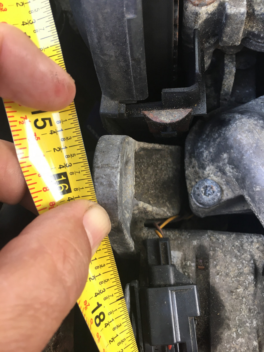

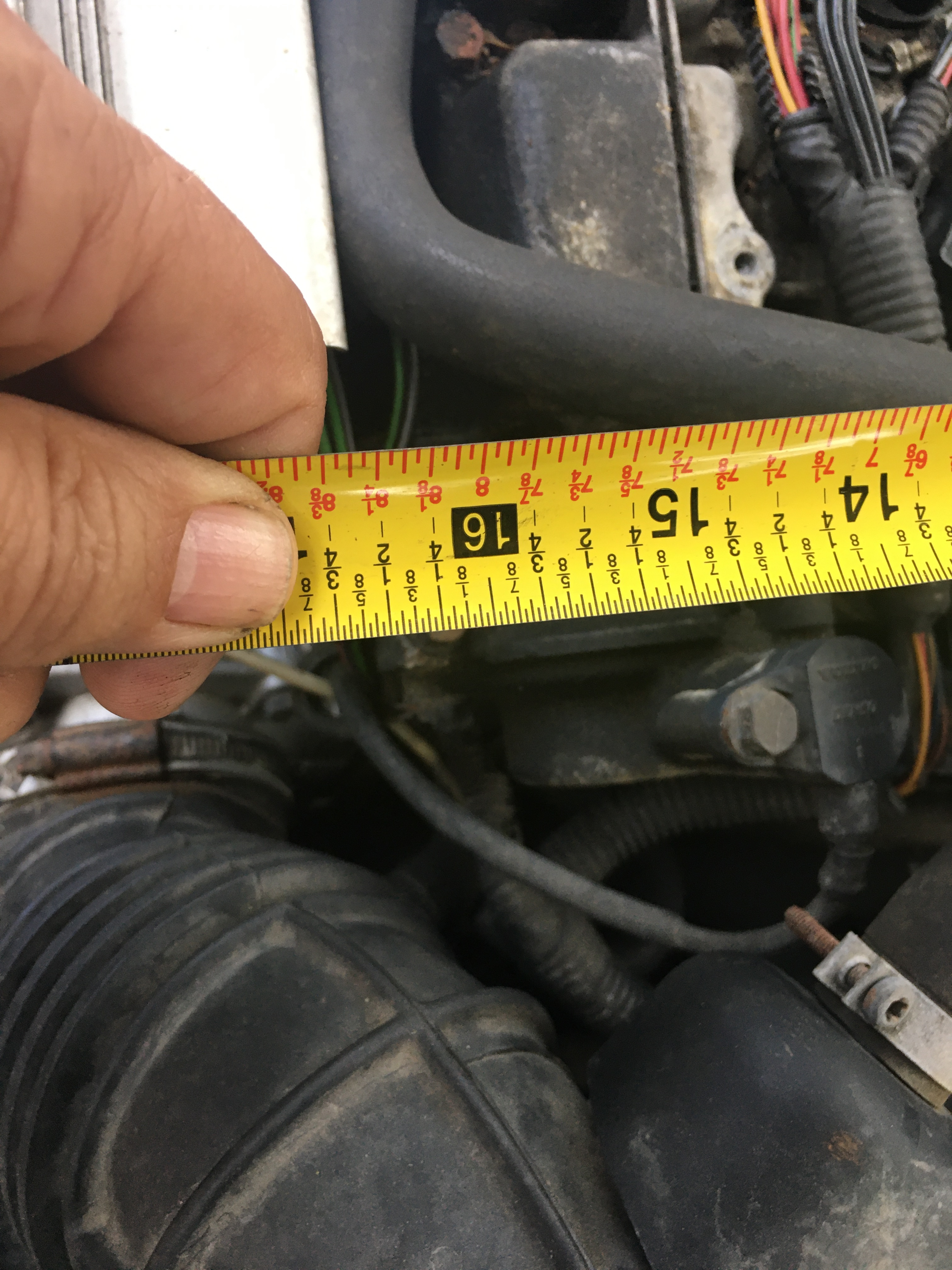

The left point is just about 16” exactly, while the right point is 23 1/8”. I’ll check the V70R later.

My only turbo car is still apart but here are NA measurements
16 on the pass side
The other is a 161/2 inch drop to the corner of the cylinder head cover from the mid point of the top rear engine mount bolt
Errors estimated at 6mm

So we're looking good on the left side. I'll have to measure that to the cam cover bolt tomorrow.
