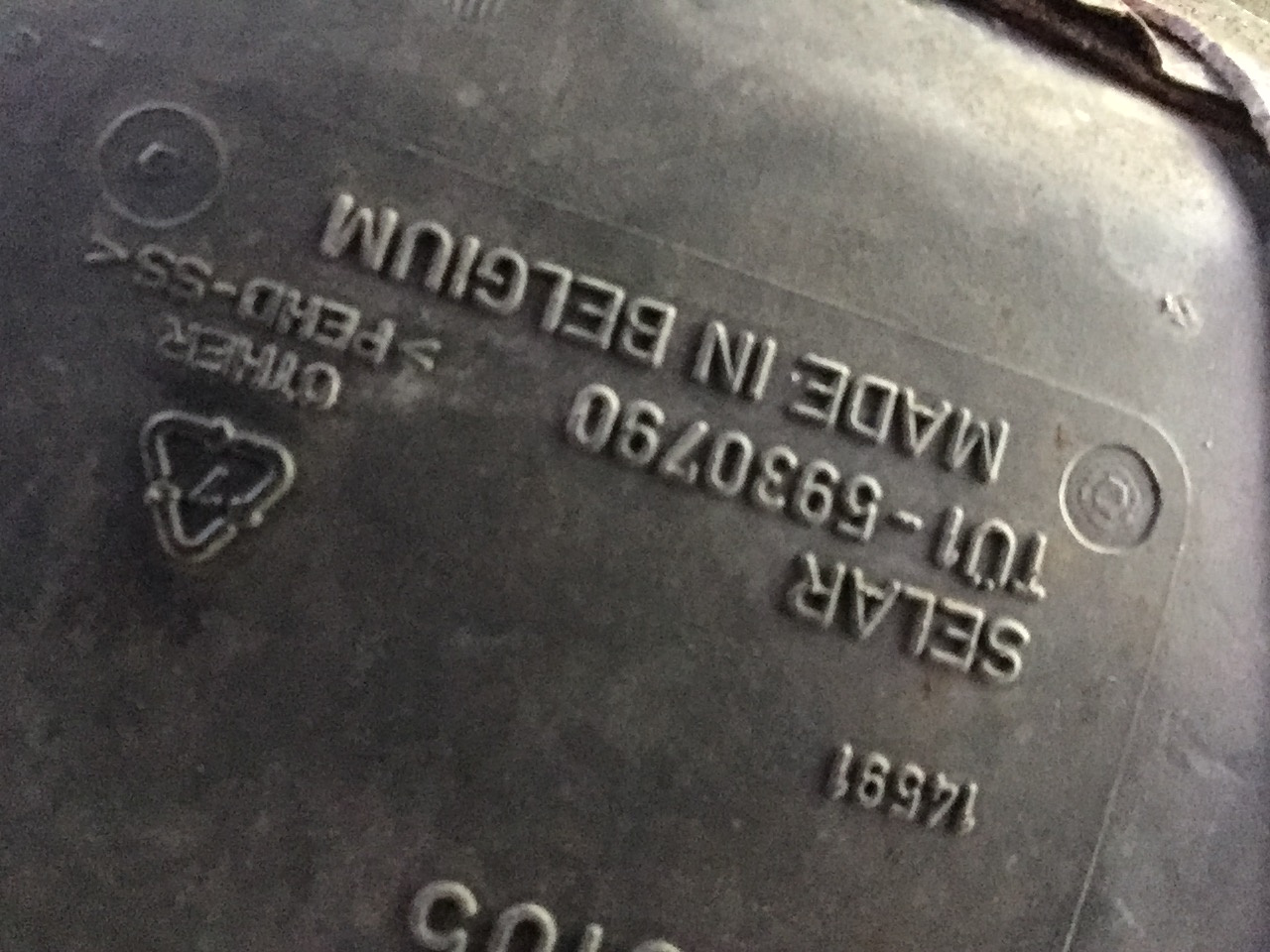

P80 Fuel tank - what type of plastic? [HDPE with Nylon additive] Topic is solved
- Posts: 36142
- Posts: 36142
I guess we can google PEHD SS
Some variant of HDPE is my guess

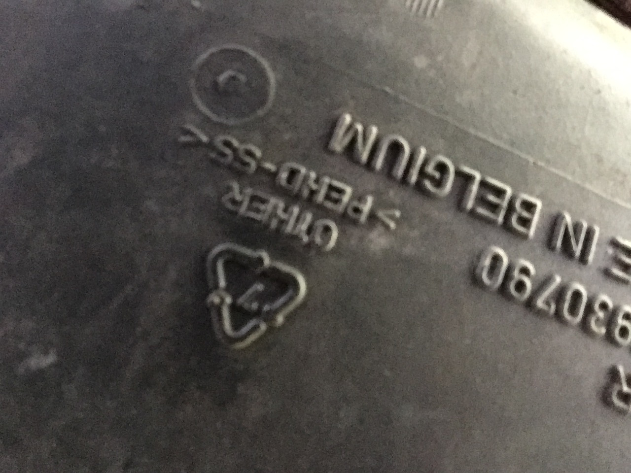

Im guessing that the tank is HDPE with some kind of liner for the fuel container. That plastic liner means it can't be recycled as HDPE so it get the 7-OTHER
Maybe thats the PEHD-SS labelling?

abscate wrote: 27 Aug 2019, 09:54 Im guessing that the tank is HDPE with some kind of liner for the fuel container. That plastic liner means it can't be recycled as HDPE so it get the 7-OTHER
FOr purposes of welding, I would try an HDPE weld - I bet that works outside.
God, this guy is good.
Just got off the phone with a friend at Dupont. SELAR is a Dupont Nylon, designed to be mixed with HDPE product, and was used in fuel tanks for Volvo, Kia, Saab, Mitsubishi, Toyota.
Final Answer - its an HDPE tank, with a Nylon additive for compatability with ethanol fuels.
https://books.google.com/books?id=TcQ7f ... PE&f=false

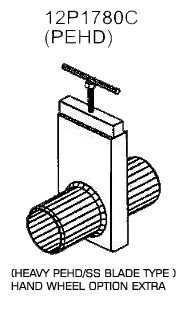

So, is this telling me it's a variation of HDPE, and why not classify it as #2 then? SS usually refers to stainless...that could be coincidence.
Here's a gate valve from a company in the UK made from "PEHD 500".....

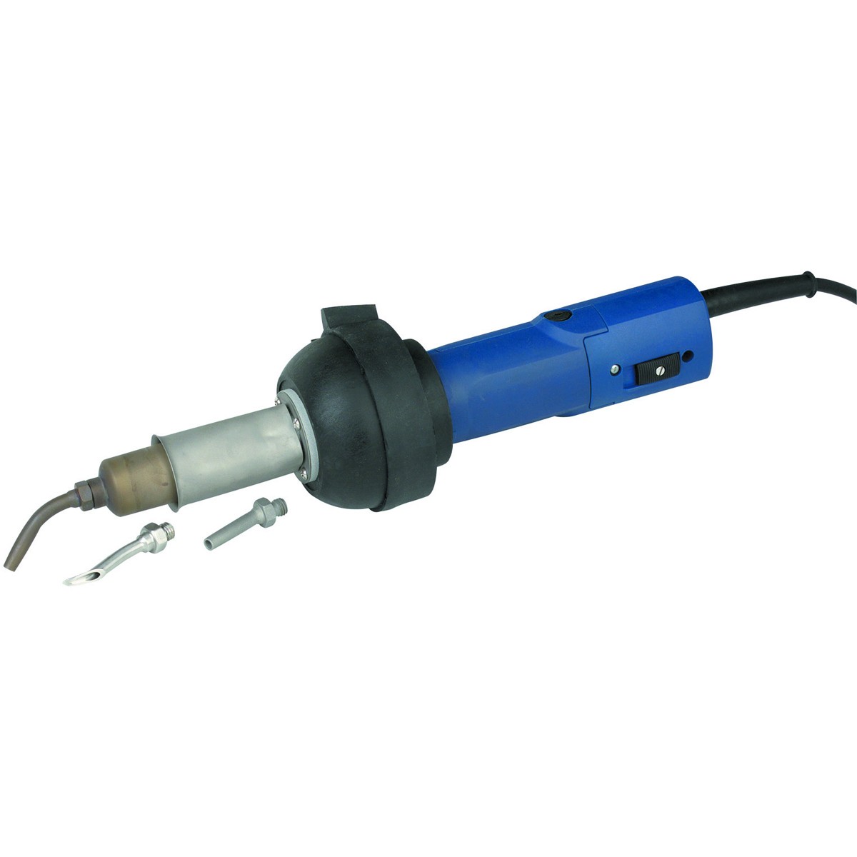

Sure looks to me like this tool....
https://www.wegenerwelding.com/prod_hand_airtherm.php
...is the same as this tool... (one has a feed tip added)
https://www.harborfreight.com/plastic-w ... 96712.html
Wegener is the supplier of all the professional tools a local industrial plastics fabrication company uses.
