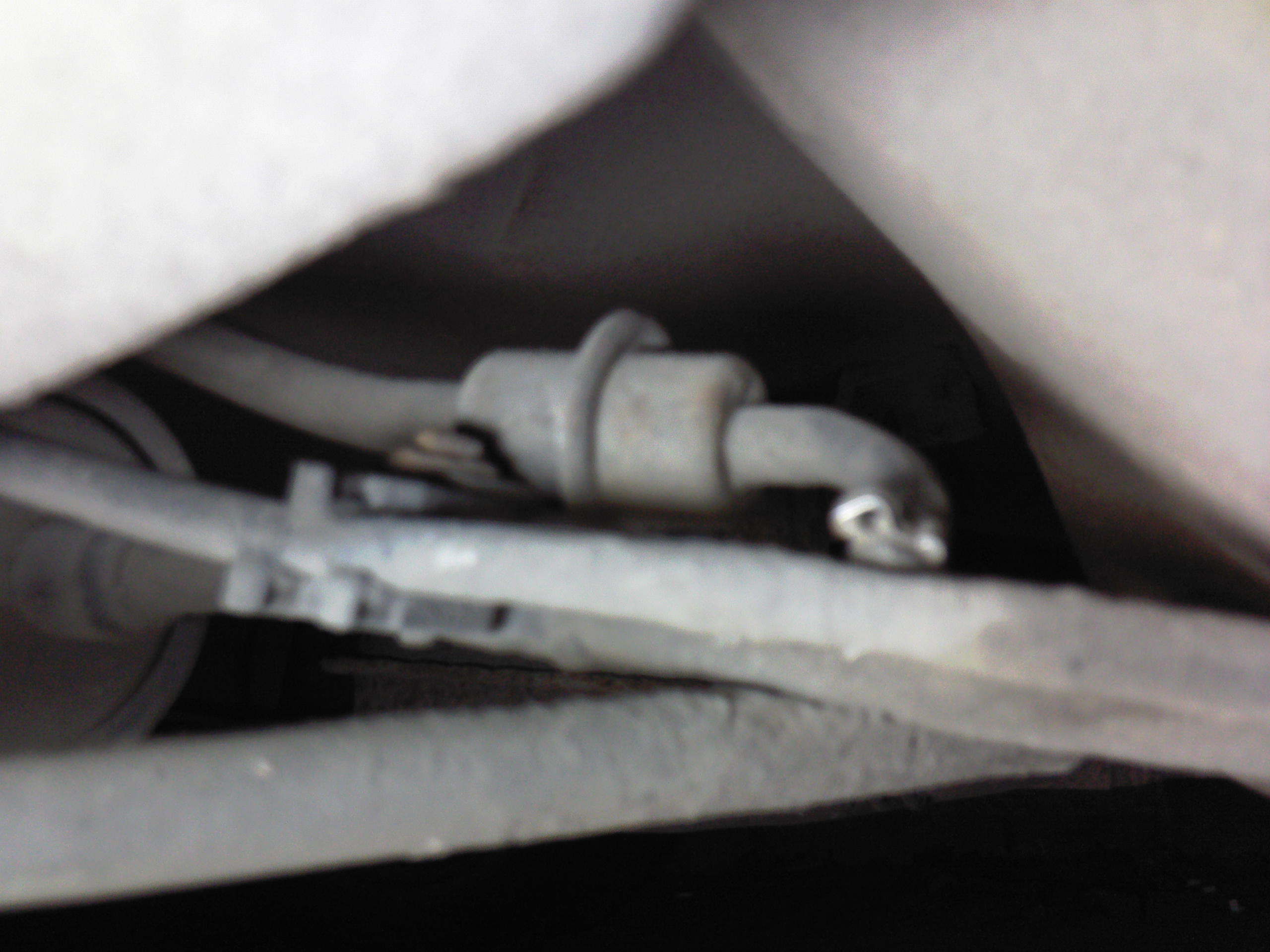

No...the pump speed is constant and also is a fuel pressure.The difference for M4.4 than other "regular" 850 is that FPR is in the back,near the fuel filter and older 850s including T5(M4.3)have it on fuel rail.On fuel rail i just have a fuel pressure damper.jimmy57 wrote: 21 Sep 2019, 11:37 I was picturing the regulator on the rail but the mid 90's brought a lot of changes to where they put the FPR. Does your car use the two speed pump system with a ballast resistor near the HVAC blower inlet? I really figured the Euro versions didn't get the same RULO vapor mitigation hardware.
The same management is used in U.S market '98 s,v,c70.
I doubt that problem is in filter itself....i guess that it's some kind of problem with "quick connections" on fuel filter.
i'll check those as soon as i have a bit time for it.
You mentioned that fibres could flush from new filter and got catched in fpr causing it not to seal well....i guess that 3Bar pressure would flush it too.Especially after a month.
We'll see.
This is the old picture of my FPR at the rear of the car:

Ah too bad, you can't just open that up like you can with this one that is very common in US spec m4.4 cars viewtopic.php?t=83922.
And I realized my m4.4 850 (1996 NA) has the FPR at the rail - fuel system comes in several flavors, even within a single engine management!
