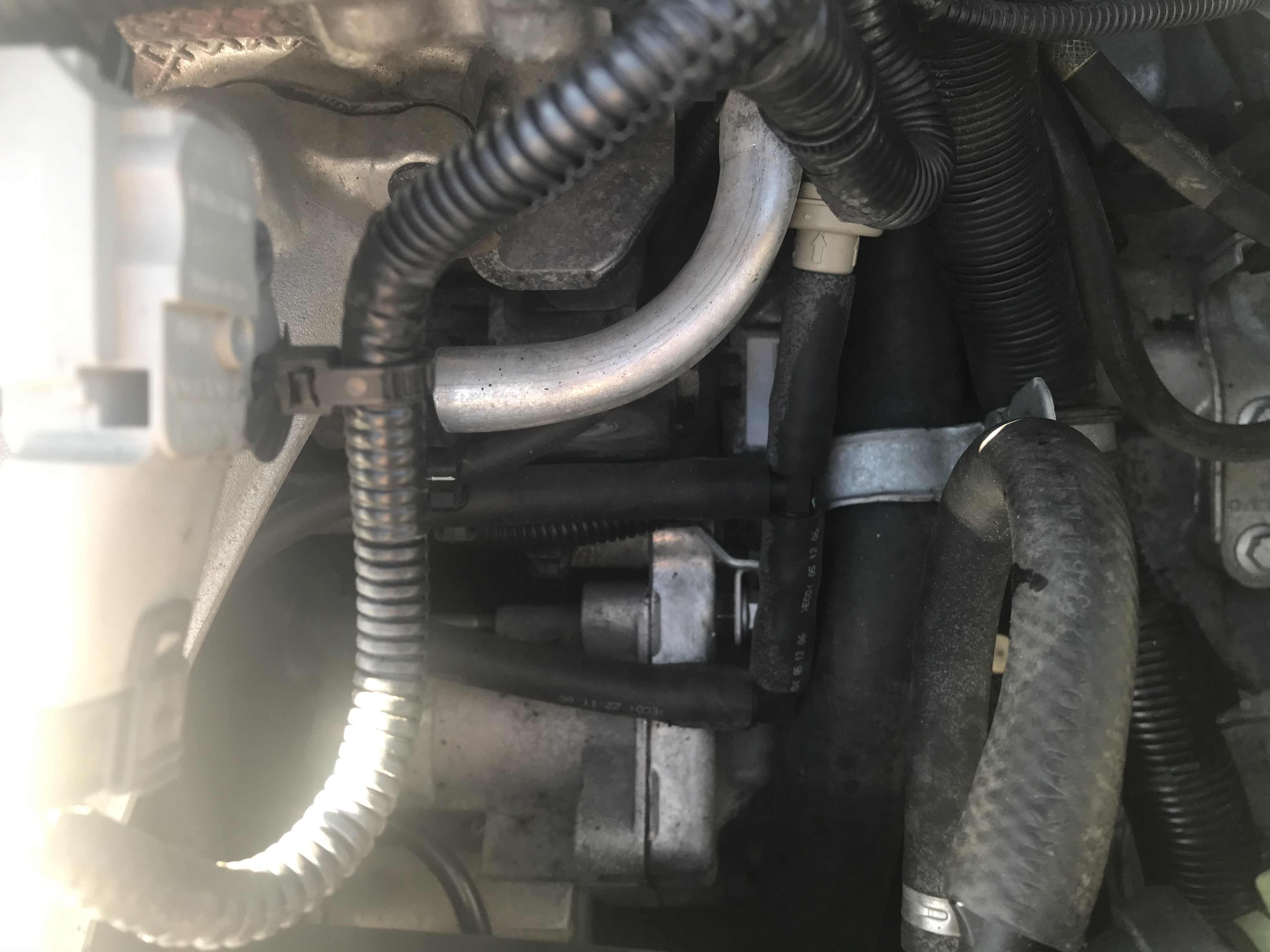

I would go buy reels of different size hoses and replace ALL my hoses in the engine compartment, if my hoses looked like those! I see obvious leaks in your hoses, and since the left one goes to your intake manifold it will totally confuse your ECM and result in poor performance.
Here is a picture from a 2007 Volvo S60 2.5T. The left bottom hose goes to the intake manifold, the one above goes to a valve and then somewhere down under the intake manifold, and the one going up leads to the one way valve And then the boosted output from the turbo. Yours might be similar.
