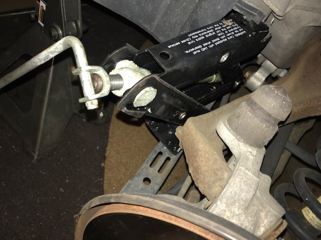

Hey Everyone, Job completed. I changed the two front struts. Installed pre-loaded strut assemblies. And the two rear shock absorbers. In hindsight it wasn't that difficult.
I actually used the jack that came with my car to force the rear wheels down enough so that I could get the rear shocks back on their studs. See picture of rear passenger side. And yes, I used the spring compressors rented from Autozone to remove the old shocks from the assembly. Needed to purchase a 'pass-through' socket set from harbor freight for $20 to remove the 18mm nut from the top of the rear shocks. Used a T40 to keep the shock from spinning.
Hope this doesn't sound like a dumb question but do I absolutely need an alignment after changing all fronts and rears? I've heard you MUST get an alignment, but there have been times when I changed my strut mounts for example and I didn't go get an alignment. The car drove perfectly for years after that, no uneven wear on any of the tires. And I drove it on the highway today and it drove perfectly. This car just seems to have a resilient suspension system. What do you think?
Thanks again for all assistance.
Rear passenger 2006 S60 AWD

Just finished rear struts 2004 xc70 awd 2.5T. I used Sachs struts & my original springs (file w/ procedure for AWD attached below). As mentioned by GoldChemist, the tricky part for me was getting arms down to reinstall. I tried the factory procedure using 3,300 lb compression strap but no joy (and somewhat dangerous imho). I ended up using a bottle jack + blocks to lower arms (dicey).
