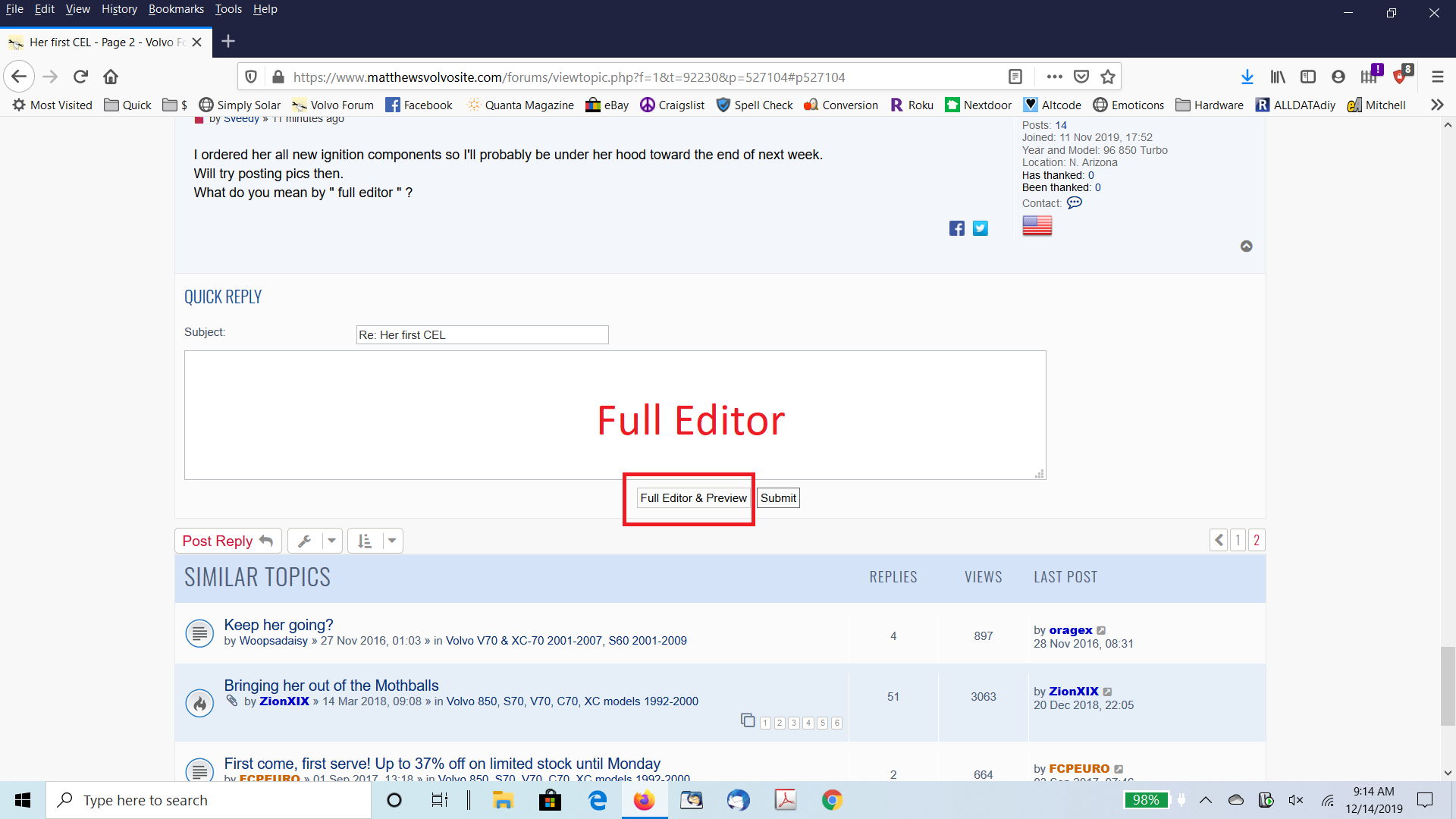

Where you been typeing your messsages is the standard editor. Full editor is a editor mode that has more options, including file attachments. look below I marked the button to get into the Full editor. Full editor is more like a word processor.

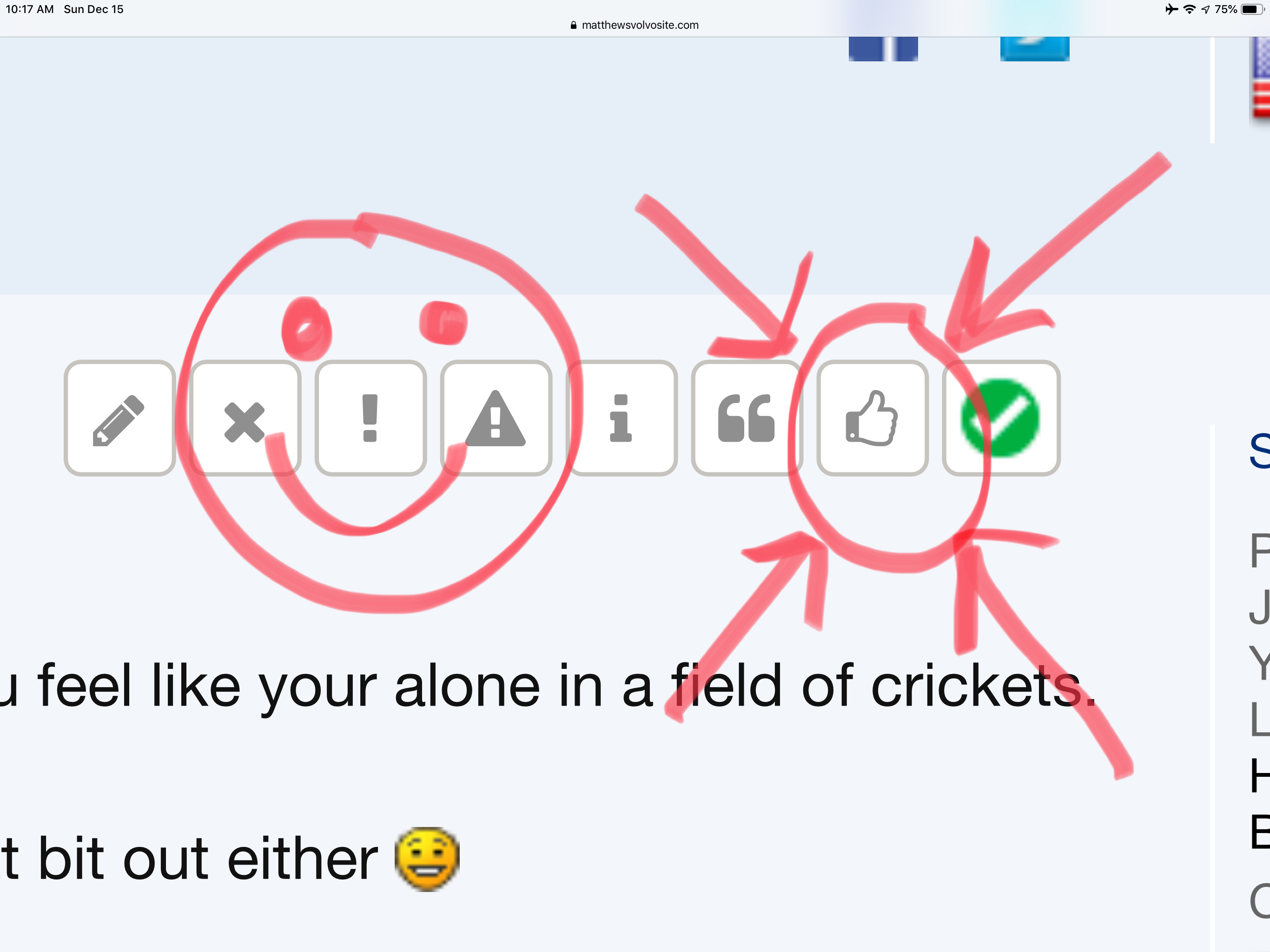

Just wanted to say " Thanks for everybody responses ! ". I've been on other forums where you feel like your alone in a field of crickets.
I would " Thank " formally so it would go to your signatures but guess what ? I can't figure that bit out either
Truly appreciate all your help,
Paul
Paul
