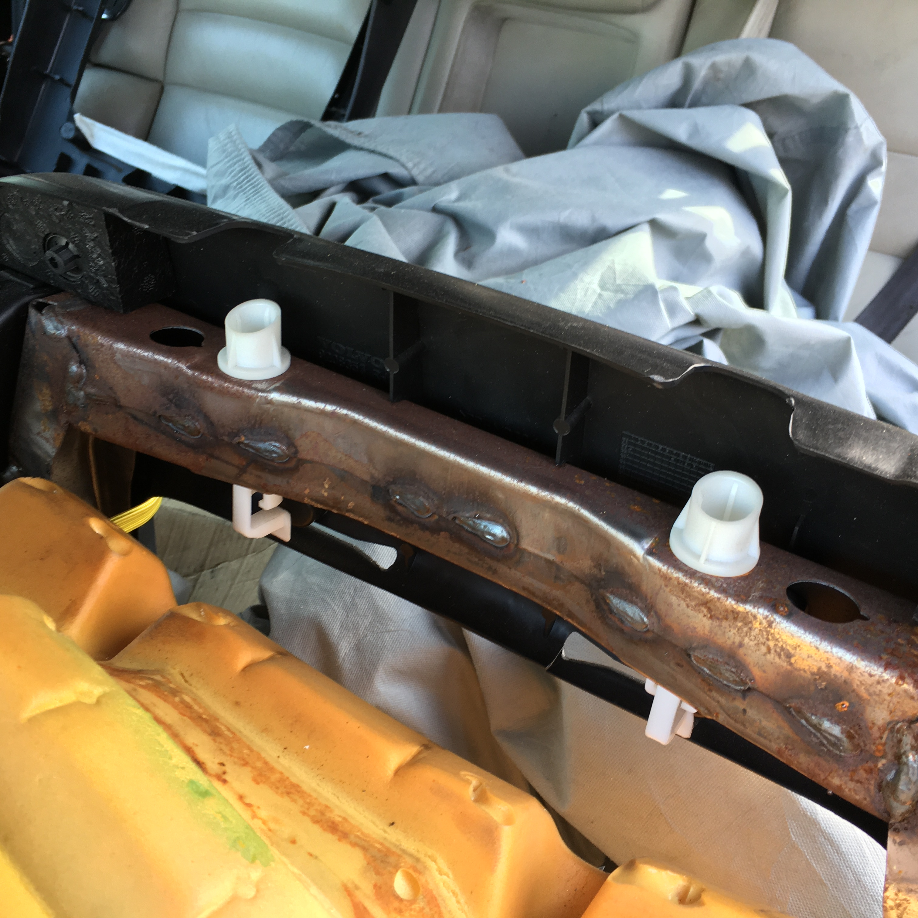

TLDR - if you want the factory look a C70 to S70 seat skin swap does not work. Its ok, but not perfect
I recently scored some nice C70 seats and swapped skins onto Evita the 1999 S70
The seat bottoms fit perfectly.
The seat backs are different - there are several differences in positions and bolsters. It look ok cosmetically but some parts of the leather tags are visible - not for the purist.
GIven they were $100 vs 4x $350 I can live with it.
Summary of differences
They aren’t.
The headrest holes are spaced differently
The mount on the bottom of the seat back skin is a bayonet type, vs hog rings on the S/V70
Accessory handles slightly different
Extra handle for the tip forward function
Seat bottom and foam are identical
Seat back foam is not -,and C70 cars kept mechanical SIPS longer than the S/V70 chassis so the seat back foam won’t match a 1999- S/V70
Im still getting the seat back tight and finalized but it looks ok and feels great

Who has two thumbs, is a dumba$$, and just realised Volvo seats can adapt to either S/V70 or C70 spaced headrests???
