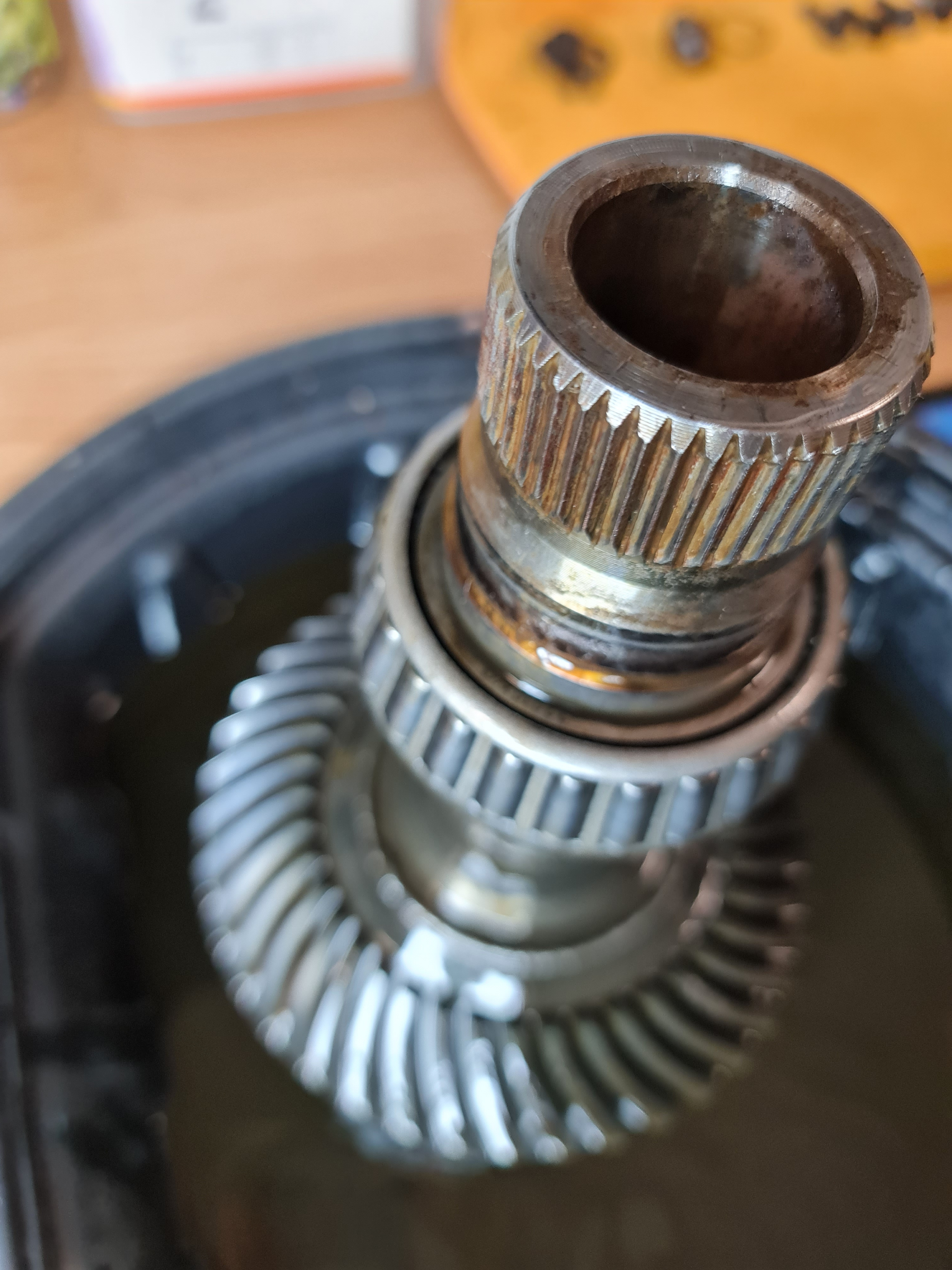

The bearing sound has been localized and now I need some advice what to do.
Removed the angel gear from car trying to isolate the sound and this is what I found.
The bearings are really rough and quite a lot of binding:
So I decided to take it apart...
Status of the AG looks to be quite good:
1. Half worn splines ( might do the weld mod on it..)
2. The crown wheel and pinion gear are in good shape
3. Bearings on crown wheel axle seems really smooth (type 32010 X/Q)
4. But the pinion bearings sounds like this:
I'm thinking of just ordering the bearings for the pinion, clean everything and put it together. Sounds good ??

Lets see a picture of the input splines.
