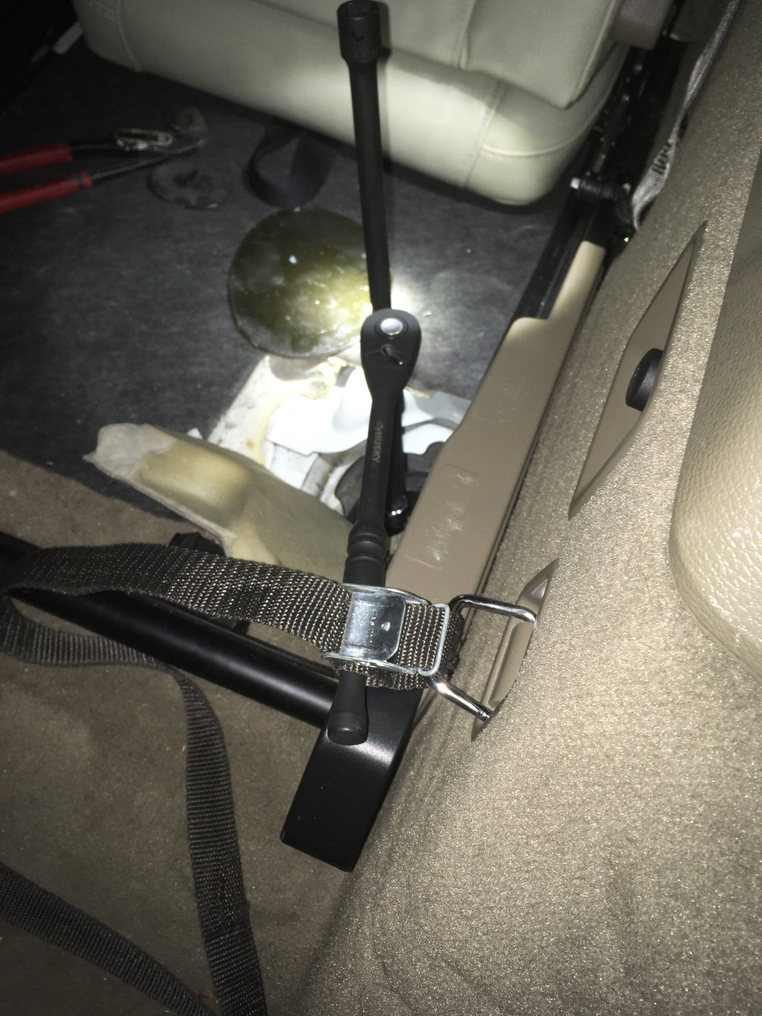

Perhaps it’s helpful for the lone wolf DIY mechanics like me: little trick to keep the wrench on the center shaft tight to torgue the nut, which is quite a bit at 44 ft lb.
