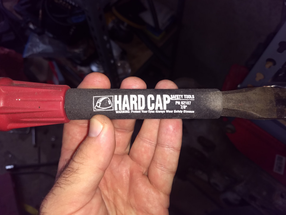

This is the chisel I've used for popping out the original axle from the donor 2005 XC70 w/ 220k miles. It's been never taken out, not once, in its whole New England life.

VTI thanks for the chisel suggestion I did use a 7/8 but will look into that particular one. after I go with the wood splitter. chris11211 the car is not a daily driver (its off the road) so I have the time to solve this maddening problem for my own ego and for the good of all man kind
I do not want to be defeated and will stay the course and report here on this man vs machine challenge.
So far the score is 5 points Machine - 0 Man. Also for what it is worth I have done drivers side axles on 06 XC90, 96 850, 98 V70, 04 C70's and can tell you I've never seen a fight anything like this one but I have heard of this happening to other Volvo owners too.
