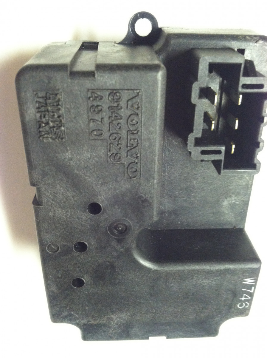

Looks like you're missing #15, which would explain the 233 code.
If the fitting the square drive fits in is cracked, there are a couple solutions, but if it's missing a chunk, that's a whole different sport.
Let us know how you're making out.

I'm going to try either tomorrow or Sunday to get the motor attached, I have a couple other higher priority repairs first but I'm hoping maybe a combination of wrapping it with a wire, tape and maybe some glue I can get it attached, worst comes to worst I just drive with the motor just spinning on its own, I don't really need the passenger side for now I would just like the AC to blow on my face and not the windshield
