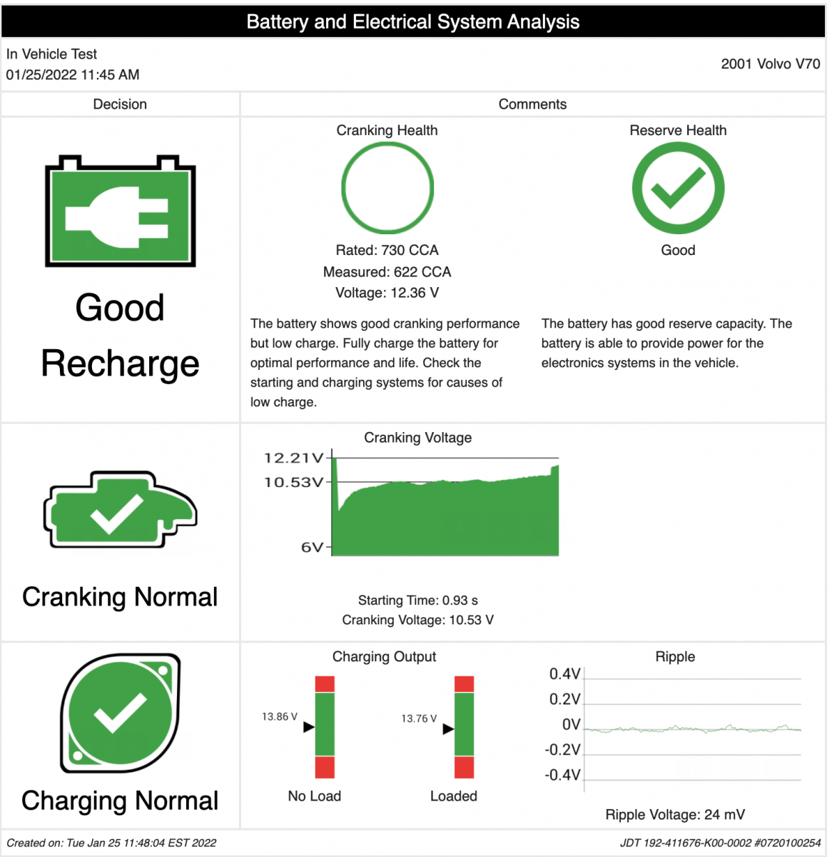

Took a fairly low-risk, low-work approach today and had the battery/starter/alternator tested at Advance. Only 5 minutes away and I didn't have to disassemble anything. Obviously it's not as thorough as removing the alternator and bench-testing it on a belt drive for an extended period, but it's something.
This was their report. Note to abscate, it does seem to include a ripple voltage graph which may not be as accurate as an oscilloscope but may serve a similar purpose?
Other than the battery being low, they seemed to say that everything was fine. Of course, I had only been driving the car for 5 minutes when I had the test done, so it likely wouldn't pick up on the issues that occur when it's been running for 20 minutes.
I haven't wanted to take the alternator out just yet since the car is still drivable for shorter trips and I wanted to get some more certainty before I tied up a spot in our driveway with an undriveable car.
