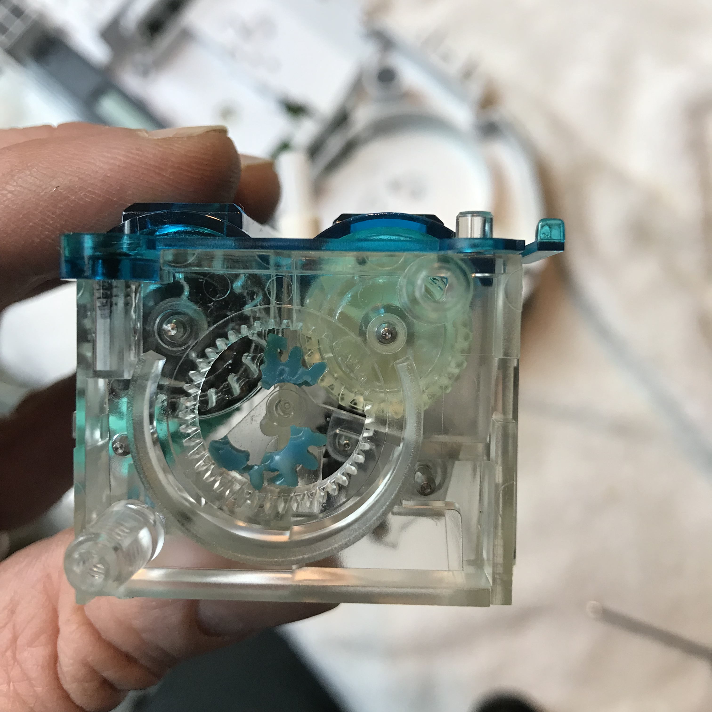

I can second this. The gears from OdometerGears are top quality and I wouldn't use anything else. In fact, I just changed out the gears on the 240 with these. The odo was working intermittently, which I thought was odd. Turned out that the PO used some cheapo gears that rotated very hard with a lot of friction. Now all is good.

Here is what I found, my dad changed the gear but maybe he didn’t change both. The big gear was destroyed
