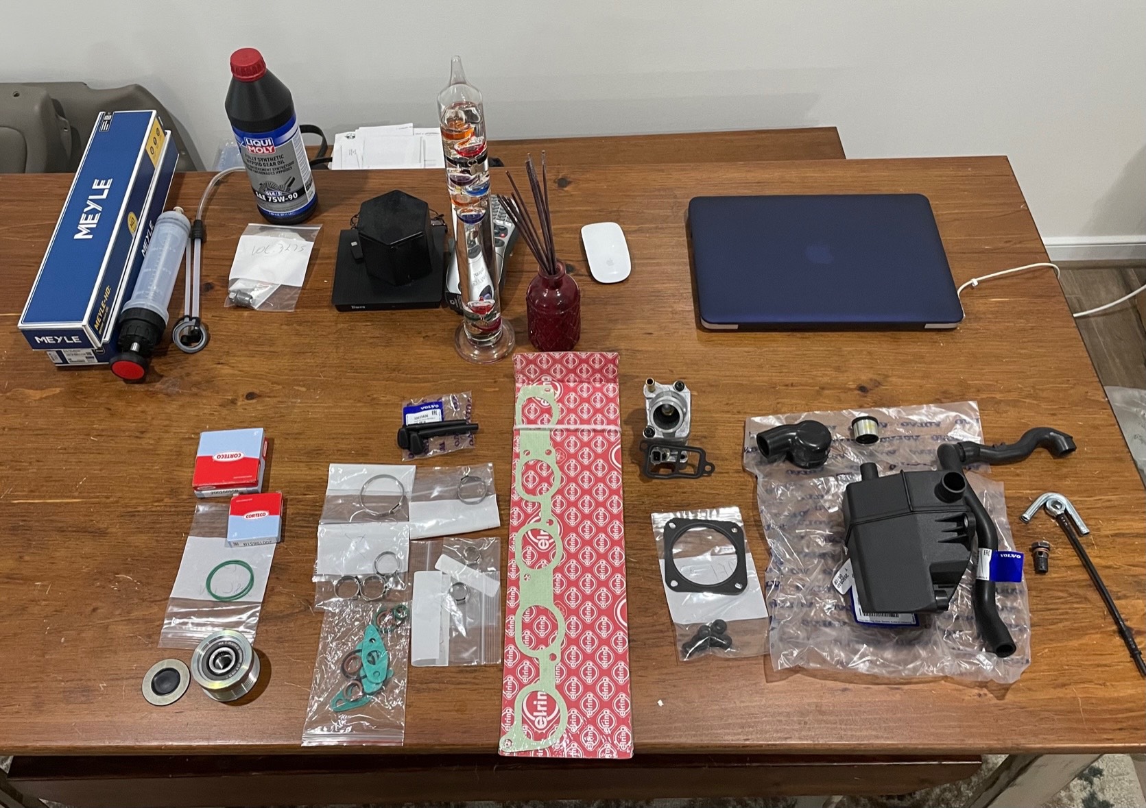

I’m working on the PCV and coolant system today on the XC70. I have no documentation of the PCV being done even though it passes the glove test. I’m also changing the thermostat, flushing and putting in Volvo coolant. The coolant in the car looked like a mixture of orange with some green. I’ve got a few other projects for it this week as I’m on a “me” vacation. Also, much appreciation to FCP!! I ordered this past Monday w/ a 1 business delay in shipping b/c the oil trap wasn’t in stock. The whole order did not ship until Friday and I got it this morning. Amazing
Thank you and I didn’t even call them to request any special treatment. Not to leave IPD out, I have their loaded Sachs struts coming tomorrow. I ordered several weeks ago and they put together a batch last weekend, so thank you IPD. You all are making my stay-cation fun.
