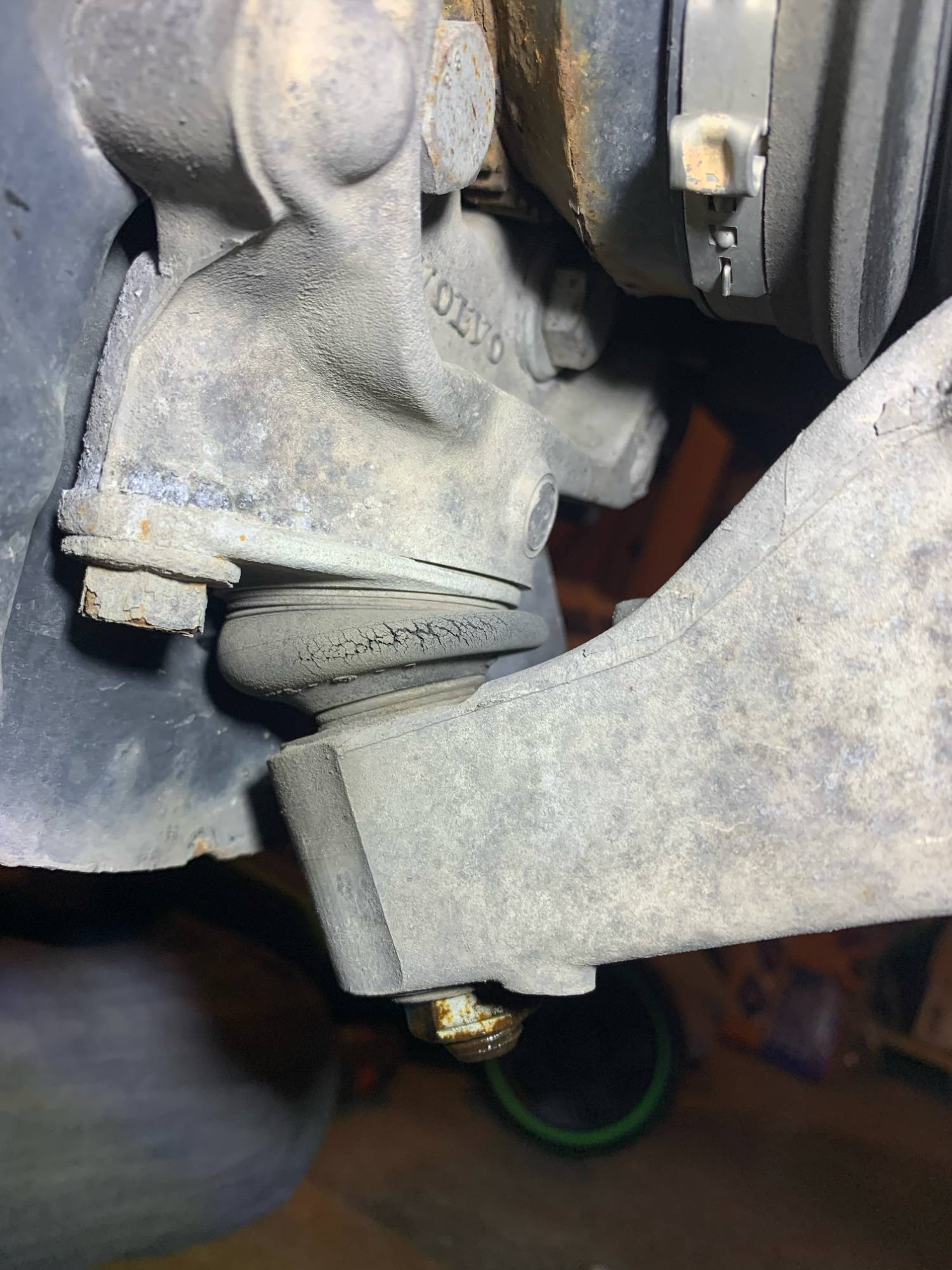

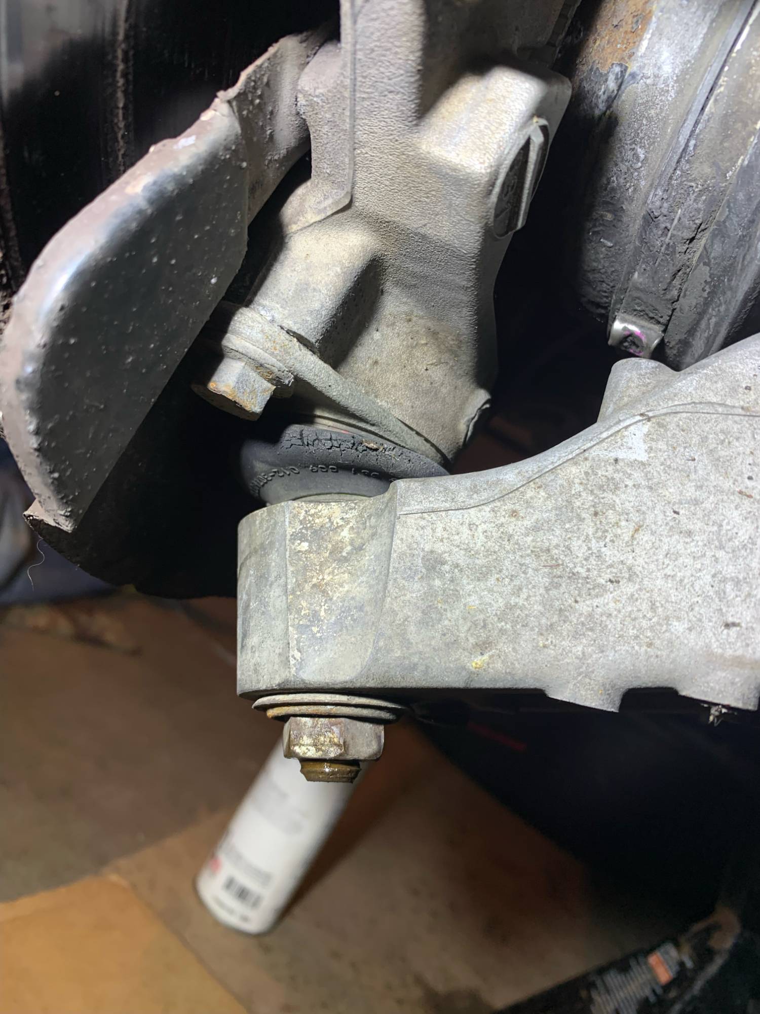

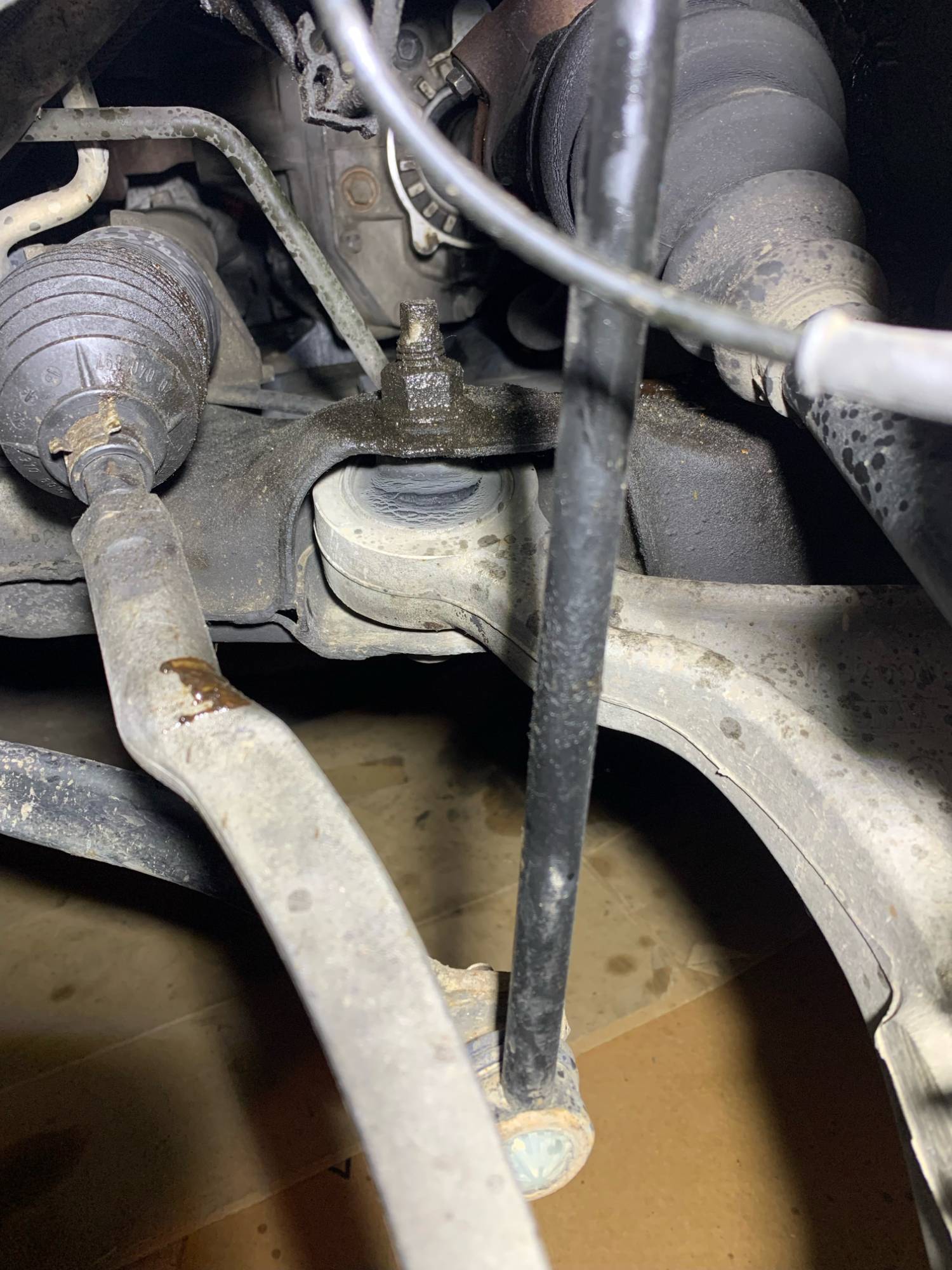

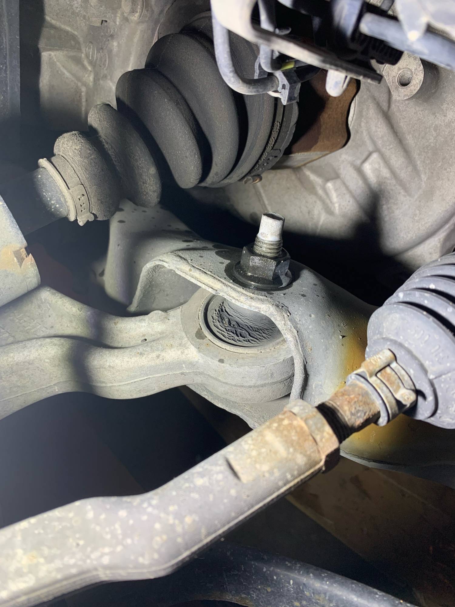

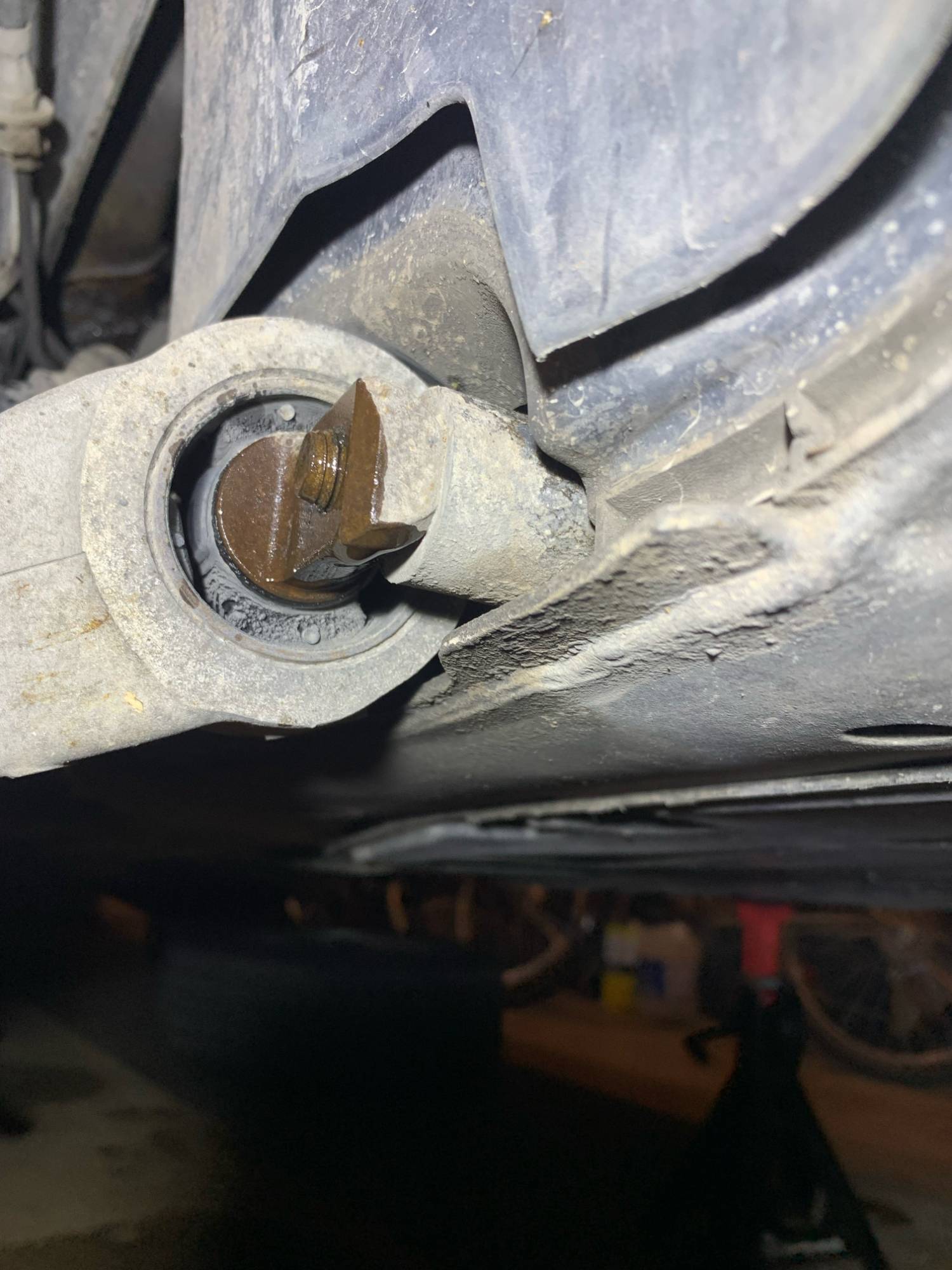

Just finished changing front control arms and ball joints on the 07 XC70. The factory originals (180k) were still working well but the bushings all showing visible signs of fatigue. The ball joint boots were cracked but not breached, the ball joints were only slightly loose. So the post-mortem is I could have very likely let them all remain in service another 10k+ miles but I wanted to do this job when convenient for me not when they failed. Installed Lemforder control arms and ball joints. Pieced together a PVC pipe coupler to tap in the ball joint, very straightforward.
I also replaced the driver's side front wheel bearing. The passenger side went out about two weeks ago and I replaced it. I replaced the driver's side preventively because it's so easy to add on with the steering knuckle out. Installed FAG bearings. Didn't forget to install a new dust seal (Volvo brand)!
Next up replace the parking brake shoes and change the oil, then it goes back on the road.
The rubber bits on the old control arms:

Oooh! Those do look a bit toasty! Good bit of preventative maintenance on that.

This is on my list, my control arms look a bit worse than yours. Any noticeable improvement in drive quality after the job?erikv11 wrote: ↑14 Jun 2022, 12:12 Just finished changing front control arms and ball joints on the 07 XC70. The factory originals (180k) were still working well but the bushings all showing visible signs of fatigue. The ball joint boots were cracked but not breached, the ball joints were only slightly loose. So the post-mortem is I could have very likely let them all remain in service another 10k+ miles but I wanted to do this job when convenient for me not when they failed. Installed Lemforder control arms and ball joints. Pieced together a PVC pipe coupler to tap in the ball joint, very straightforward.

I also wondered if it would make a difference. After two days of usage (today is the third) including 100 highway miles I do notice improvement. The car wasn't wandering or showing obvious signs of bad control arms before, so it still drives straight etc., but it is sightly quieter and smoother for sure.
