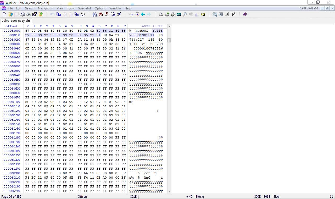

let's upload your .bin, so we'll show you an example. You don't have to decode VIN. you read it with any HEX editor. The same goes for the PIN, if you already have a dump

What do you mean?. It is like VIN.... Or...depending on how you read flash, it can be with swapped bytes

Z, if you asked me. I'm not sure what he means by "decode VIN". :)
he says he has a read dump, if so, then it is enough to load .bin in the hex editor and the VIN is at the address as you told him.
the bits have probably been swaped, so it looks cluttered, "coded"

matija0610 wrote: 11 Jun 2022, 00:58 let's upload your .bin, so we'll show you an example. You don't have to decode VIN. you read it with any HEX editor. The same goes for the PIN, if you already have a dump
hi please see attached rar of the dump from the CEM

oscilloscope wrote: 11 Jun 2022, 11:37
This is definitely NOT a CEM-Brick flash!
It is ECM EDC15 (engine computer) flash!

shot wrong one , hows this one ?
volvo_cem.rar
(102.61 KiB) Downloaded 135 times

oscilloscope wrote: 11 Jun 2022, 11:50 shot wrong one , hows this one ?
This one is OK!

ZRimaZ wrote: 11 Jun 2022, 11:54
This one is OK!
ahh clear as day! :shock: , man i must of been totally looking at the wrong one , i was navigating to the mem location and it was gibberish :lol:
probably would help if i where to look at the correct file :roll:
