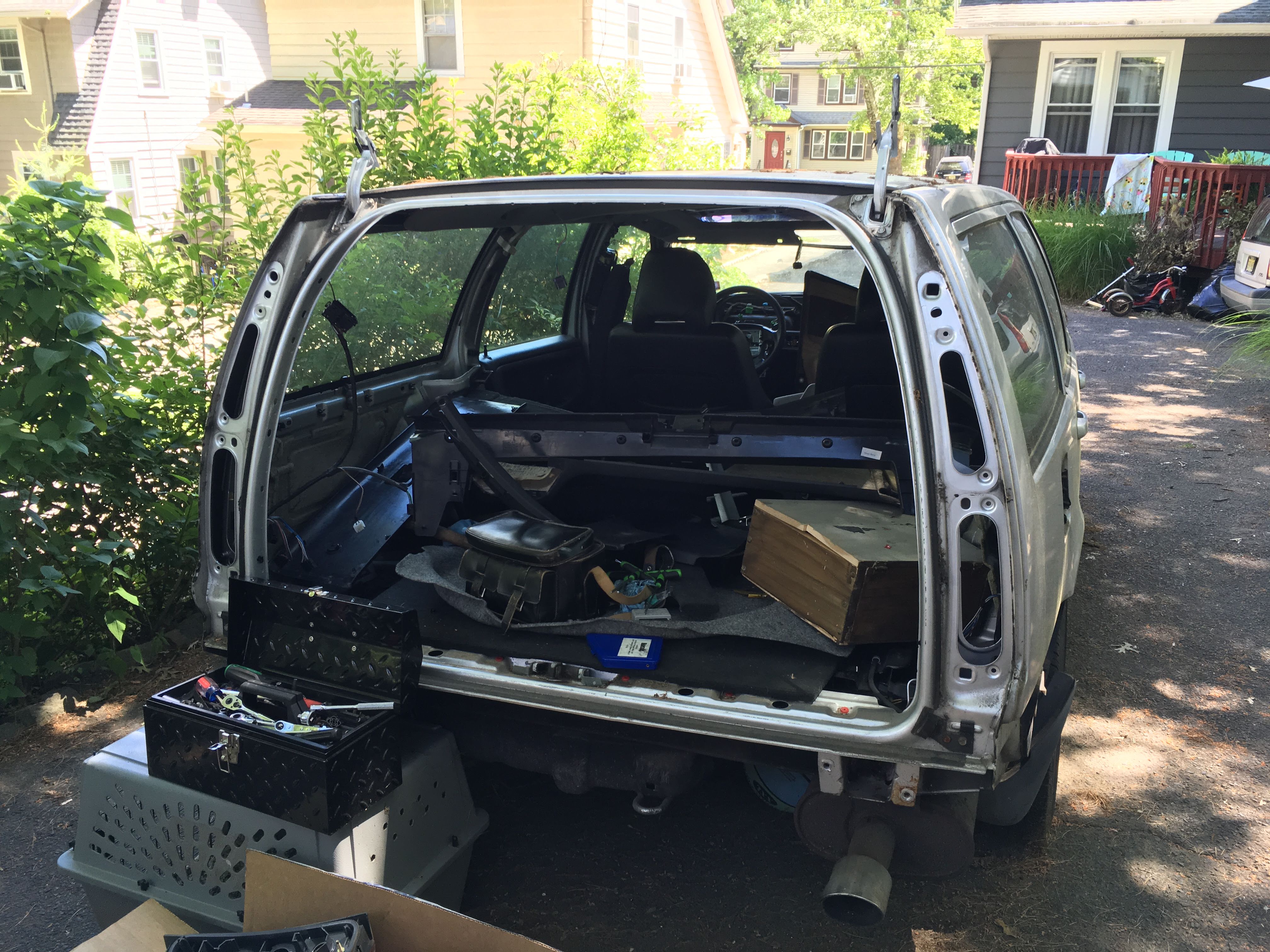

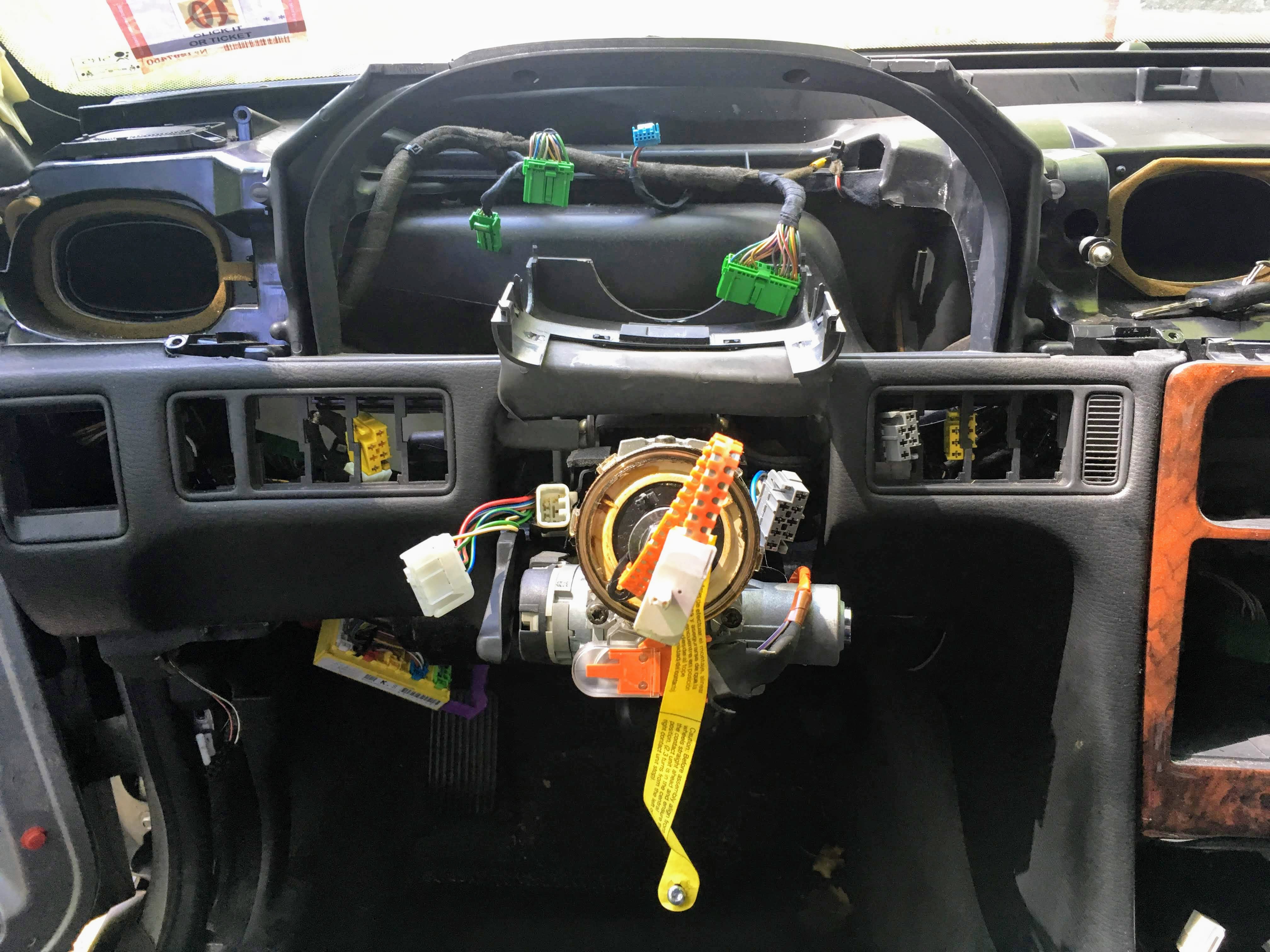

Today, I took off the power steering pump and the grille from the '99 XC while waiting for the tow truck to pick it up (in order to spare the wrath of my better half). Previously, I managed to pull practically the whole interior, tailgate, bumpers, steering wheel, instrument cluster and side trim.
The car wouldn't roll down the driveway (not surprising with the rotors nicely rusted), but my brother suggested smacking the rotors with a sledgehammer, which did the trick. Sitting on a wooden box for a seat, I steered it down the driveway and part of the way down the street, right on to the back of a flatbed. That's as much as I got to drive the car that taught me a bunch about panels and interior components.

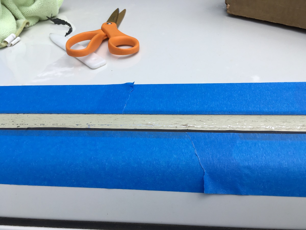

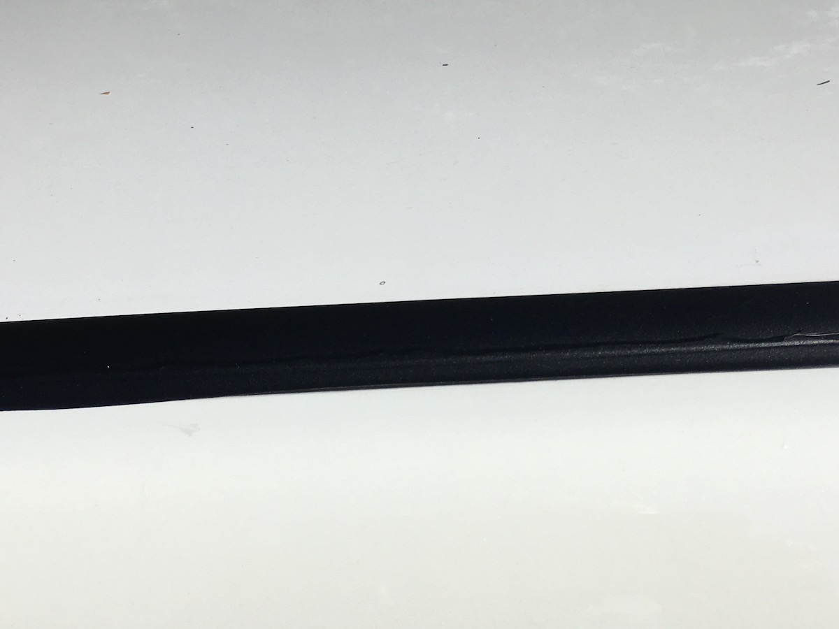

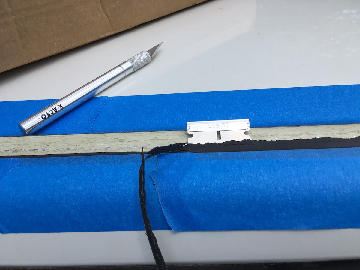

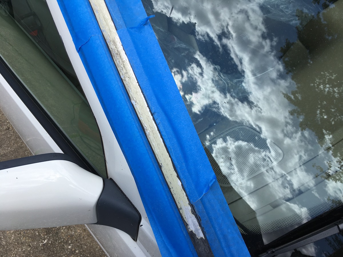

My wagon has never been garaged, and 21+ years of weather has taken its toll on the roof moldings, which were peeling. My wagon is a flat-top without a roof rack, so the moldings get full effect of the weather.
I found replacement moldings in the Genuine Classic Parts (Sweden) catalog, the price wasn't awful but one side (left/driver's) was available in limited quantities, "contact us". So I did -- they had one (1) left. So I ordered the pair, and a few days later received an e-mail back -- the pieces (which are indeed long and an strange size to put in a box) -- are too big to ship (I'm presuming that they meant "at any reasonable price".)
So for Plan D, I scraped as much of the old coating from the trim pieces as possible and used Trimbrite T9005 Blackout Tape (PepBoys, $6.99). I ended up doing each side twice. It seems to take doing it a couple of times to get it, more-or-less looking okay. I also learned that it is easiest to cut the tape to size with scissors first, instead of trying to trim it when applying.
It looks okay. (Or at least better then it did when I started.)
