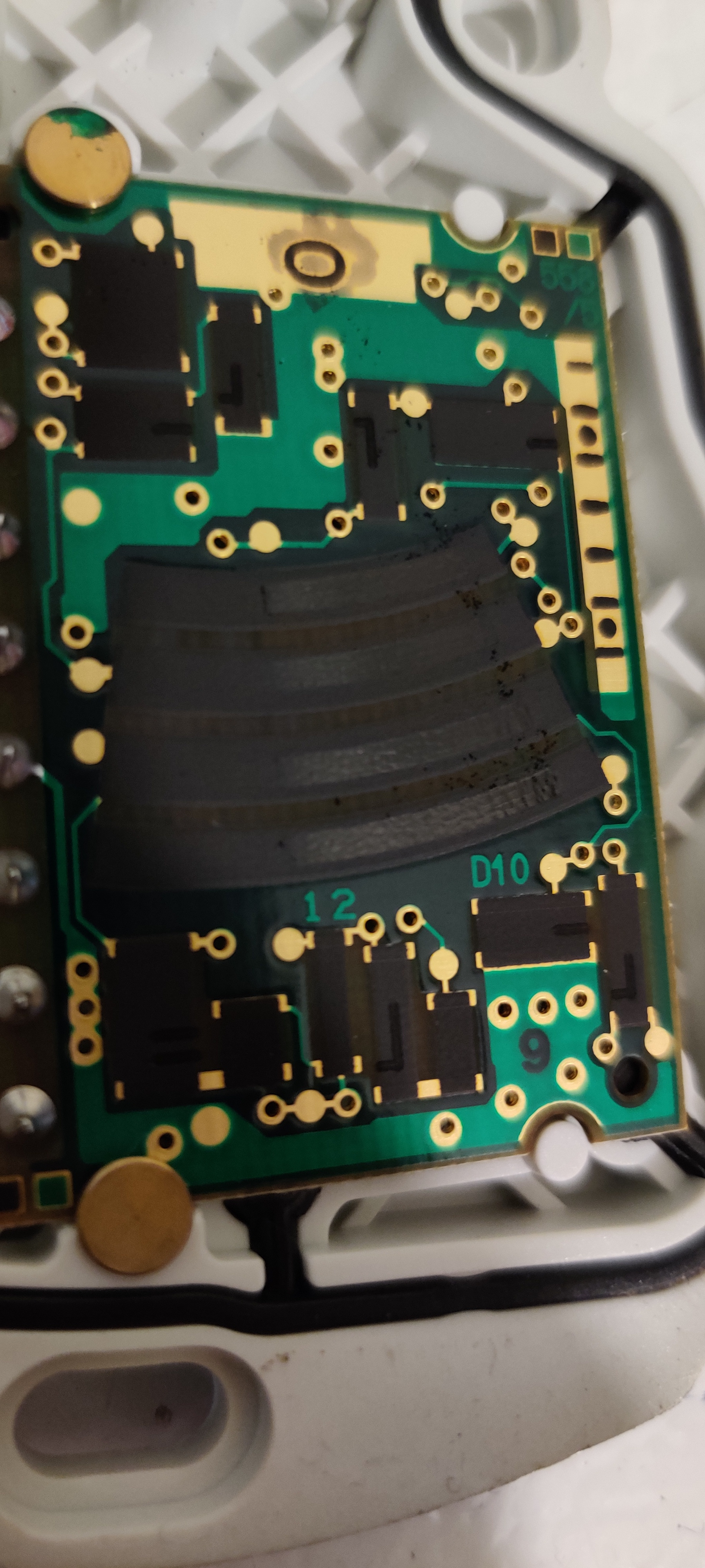

Here's how the contacts in the pedal look.

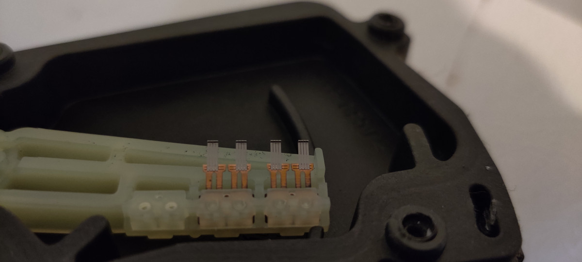

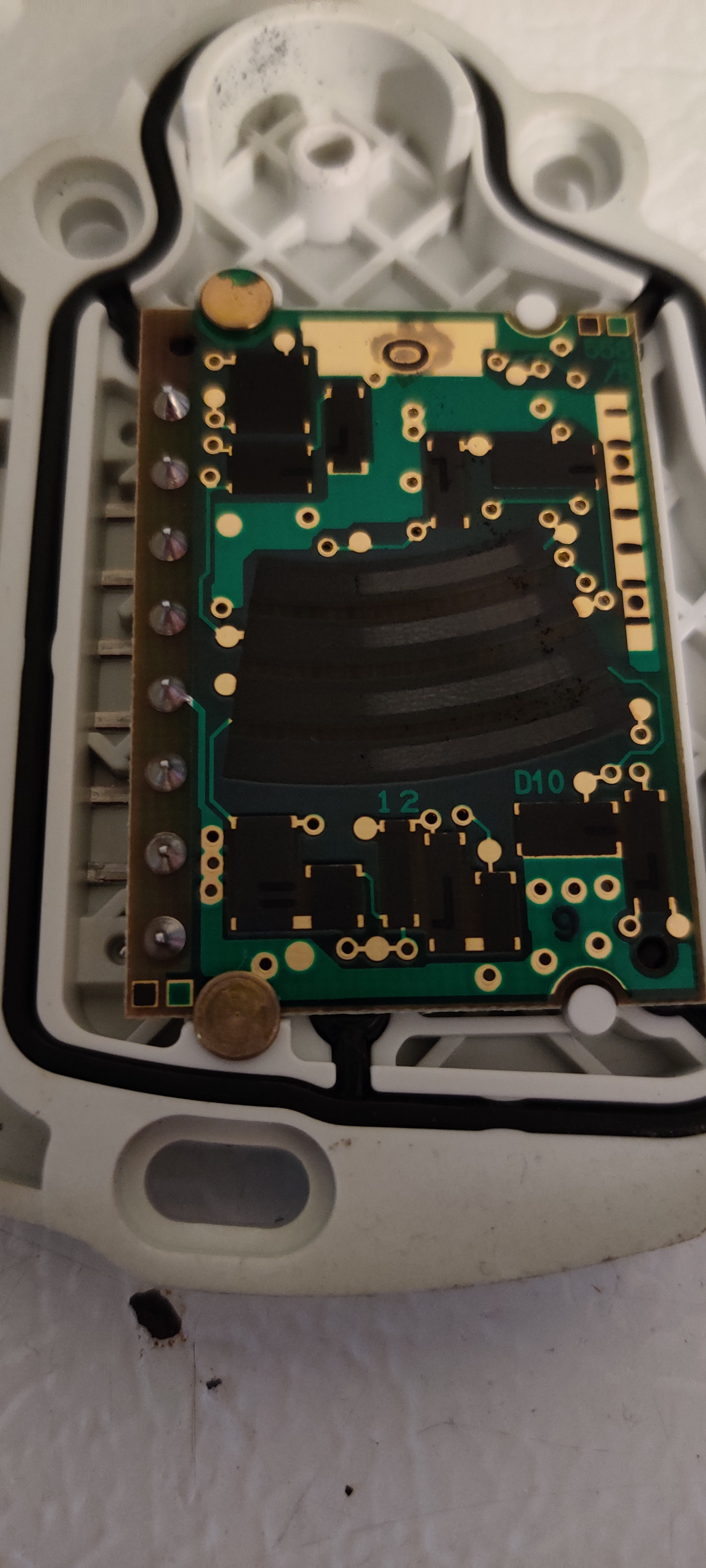

With better lighting.

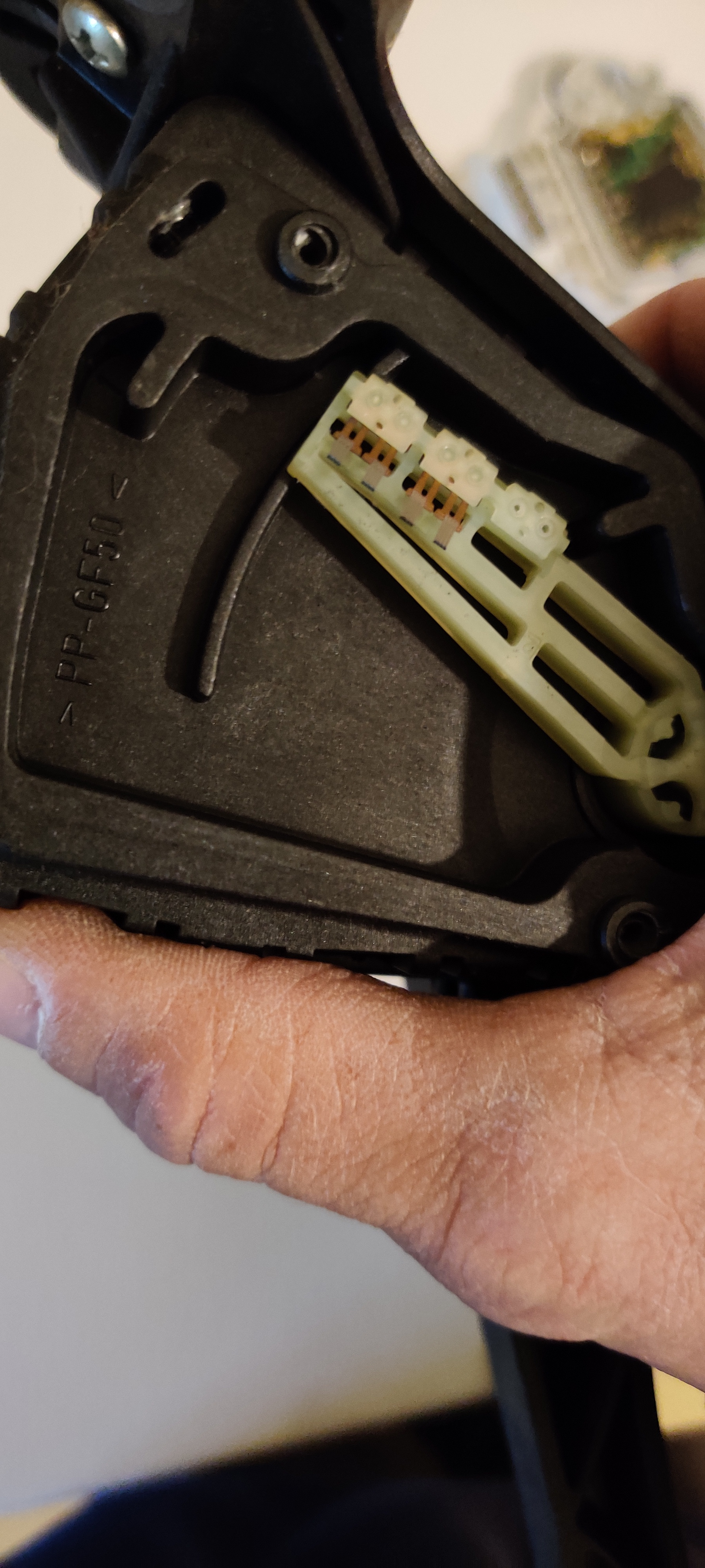

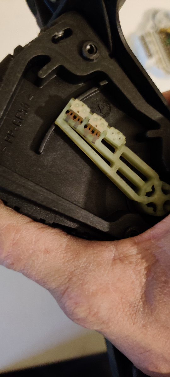

With the pedal at its normal position.
With the pedal at its full travel, or at least as far as I can push it.

There's a lot of adjustment in the sensor itself where it screws onto the pedal. How do I adjust it when I put it back together so that it's in the correct position? I can't get any resistance readings from the 6 pin connections to get the two sliders equal, and at factory spec.

I readjusted the sensor as far as I could to the spot that hasn't been worn down. Hopefully that'll help things with the poor throttle response.

Before I cleaned the pedal sensor it was at 7.8% untouched, and when I put it back together, and moved it to a part of the carbon strips that weren't worn, it's reading 10.4% now. No more sluggishness, or dead spots in the throttle, and acceleration feels smooth. I didn't know they were adjustable until I took mine apart to clean it.
