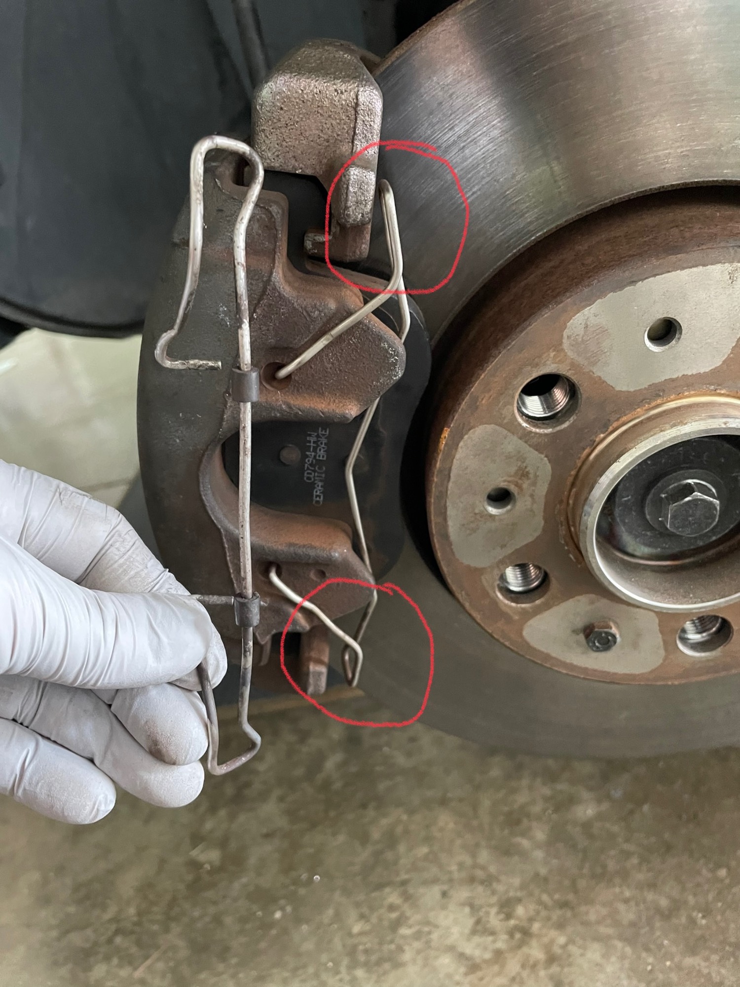

I can rattle the left front outside pad. The retaining clip is not making full contact when locked into place. The bottom wing doesn’t touch the base bracket. And upon further investigation, the clip is for the rear. If you look on FCP, the front and rear clips are a different shape. I checked out all my springs, the rest are correct. I guess I’m going to the junk yard tomorrow.jonesg wrote: 30 Jul 2022, 12:25when you touch the brakes the suspension is placed under load, anything that was knocking will tend to go quiet.DonnVa wrote: 30 Jul 2022, 11:20 I’ve been chasing down a front end clank over little bumps going slow out of my neighborhood. Pretty much everything is new on the XC front end. Complete strut assemblies, stabilizer links, wheel bearings, ball joints, control arms a couple years old. When I had it apart today I noticed my brake pads are a bit loose in the brackets. So I drove out of the neighborhood again, speeding up a little so I can apply the brakes when I hit the set of bumps and damned if the clanking went away. I guess I need new retainer springs unless you all have experienced this before. All other brake parts are tight. Slide pins are greased and tight.

I ended up swinging by the PNP on the way to my girlfriends house. It took me 10 minutes, popped two clips off and hit the road. Then pigged out on pizza and ice cream…..food coma….

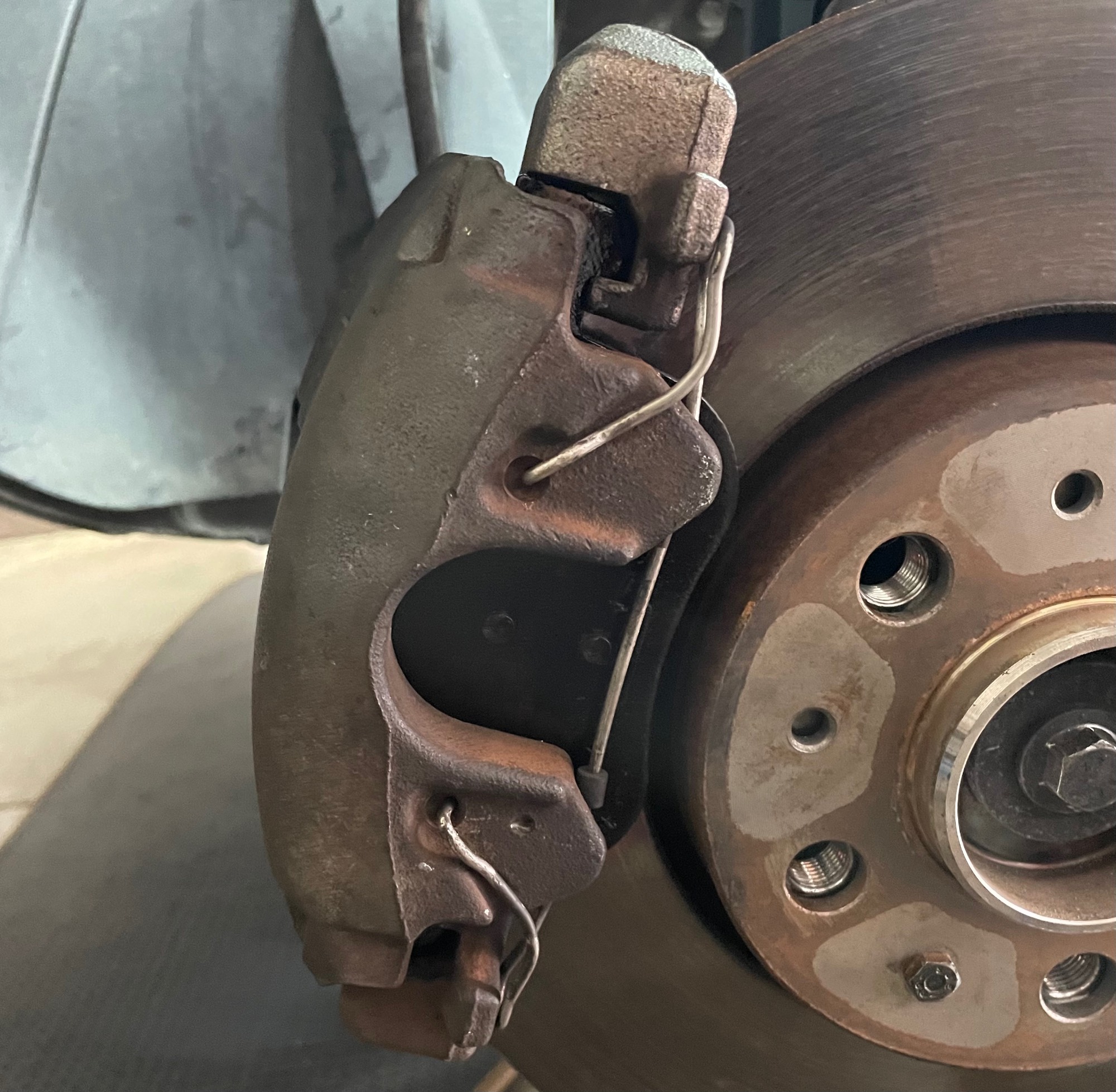

This is what it looks like when someone puts a rear retainer clip on the front. It doesn’t pull the caliper around tight to the bracket and your brake pad moves around making a metallic sound you think is a different front end issue.

It’s going to be loose too isnt it? Does it even stay on?
