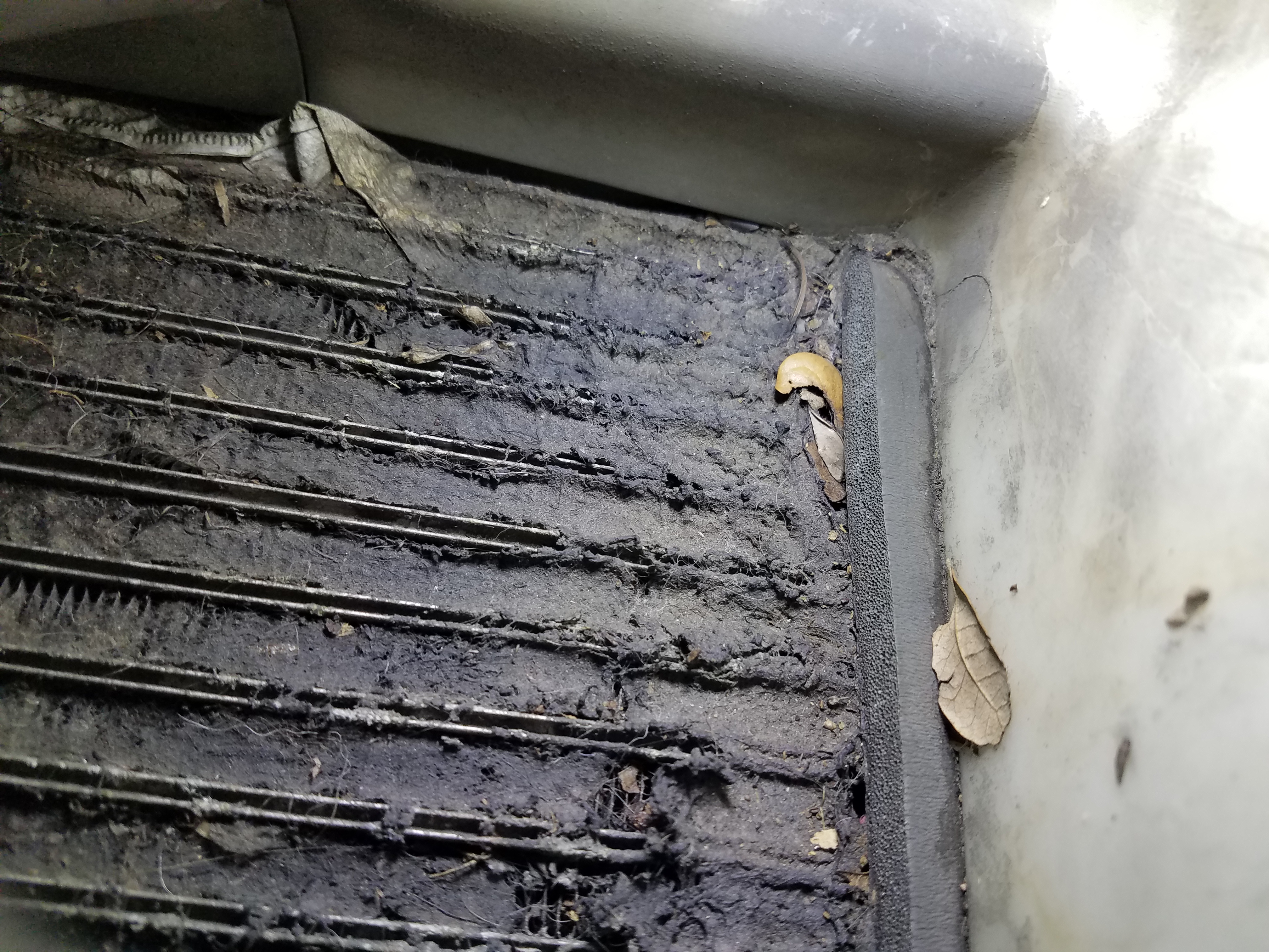

Good Sunday all,
Since were on the subject of AC systems. I'm in the middle of replacing my blower motor and resistor. While doing that I decided to shop vac around the evaporator a bit. This is actually the first time I have ever physically looked at the evap and I this vehicle has gone 23 years without a cabin filter. Why didn't volvo make this standard? A shop vac is only able to do so much. The crud I'm pulling off is well adhered to the evap fins. I'm impressed any air was getting through. Pics below to completely disgust your Sunday out.

Holy smokes Zion! That's crazy. How was it working in this condition (no pun intended)?ZionXIX wrote: ↑30 Jun 2019, 11:43 Good Sunday all,

I can smell this picture, and it does not smell goodZionXIX wrote: ↑30 Jun 2019, 11:43 Good Sunday all,

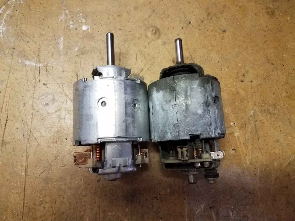

I have no idea how long its been like this. I took ownership in 2006 and never bothered checking. I was having some fan motor issue where I would get no fan and sometimes I would hit a bump and then full fan power. I didnt know if it was a Fan motor problem or a resistor so I bought a new resistor and the bosch replacement motor at FCP. My fan blades and such were in good condition and changing' the motor was not all that difficult. (Idiot me put it on backwards the first time). I'm estimating about twice the airflow now. I have never had airflow this good and there's no telling how much crud is buried deeper in the evaporator. At some point my compressor or a line will break, I will probably just do a complete system replacement at that time. Until then this was my compromise. Some scrubbing with a stiff nylon brush and forceps to pull as much crusty crap as I could reach. I could not smell an odor before or after. Maybe I acclimated to it long ago.
Shiny upside down resistor pic that I can't seem to fix. And my new Bosch motor.
