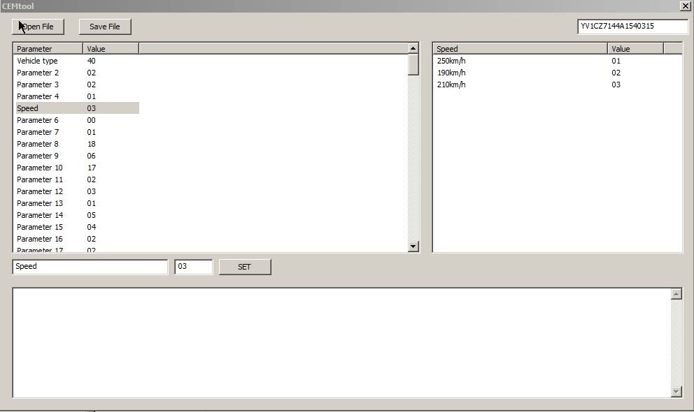

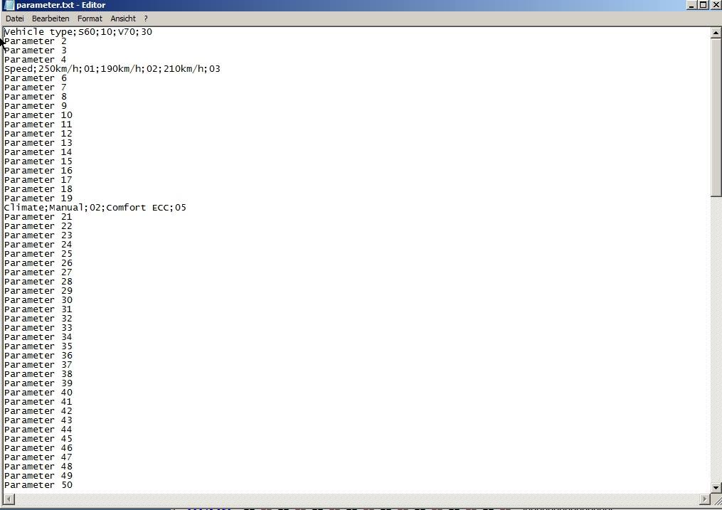

If just change config is enough, here a simple extract from my flasher.
Open CEM 320kb bin from CEM MY 2006- and change config. Not so nice but free...
parameter.txt needs to be next to exe and you need to find parameters on your own...
I think it has bugs but it will work...
Sorry, link was wrong, now with parameter file
https://filetransfer.io/data-package/348Y8KBl#link

T5Luke wrote: 21 Aug 2022, 15:07 If just change config is enough, here a simple extract from my flasher.
https://filetransfer.io/data-package/hFdU2gA8#link
Looks pretty cool , does that allow for vin edit too ?

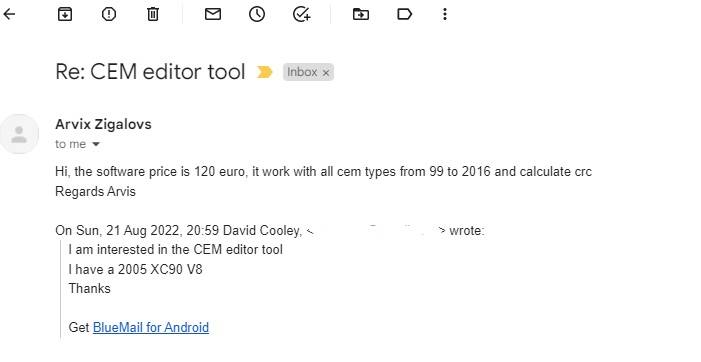

oscilloscope wrote: 21 Aug 2022, 13:41
5ft24 wrote: 21 Aug 2022, 13:08 Yikes, dude wants 120 euros for the software
Did you email the address listed in the video?
Yep. Sent me an email letting me know it's 120 Euros

5ft24 wrote: 21 Aug 2022, 15:56
I have Skyped the seller , I have asked afew questions

Post by 5ft24 »
let us know what he tells you
Here is the email
