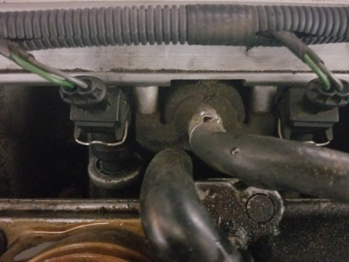

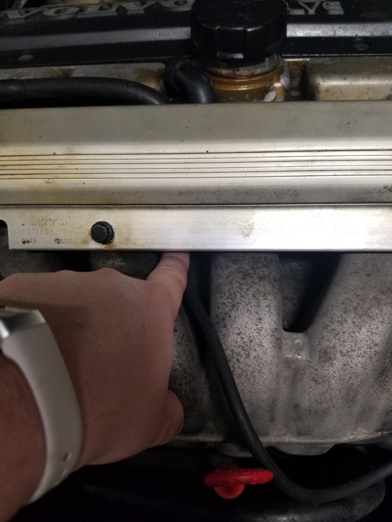

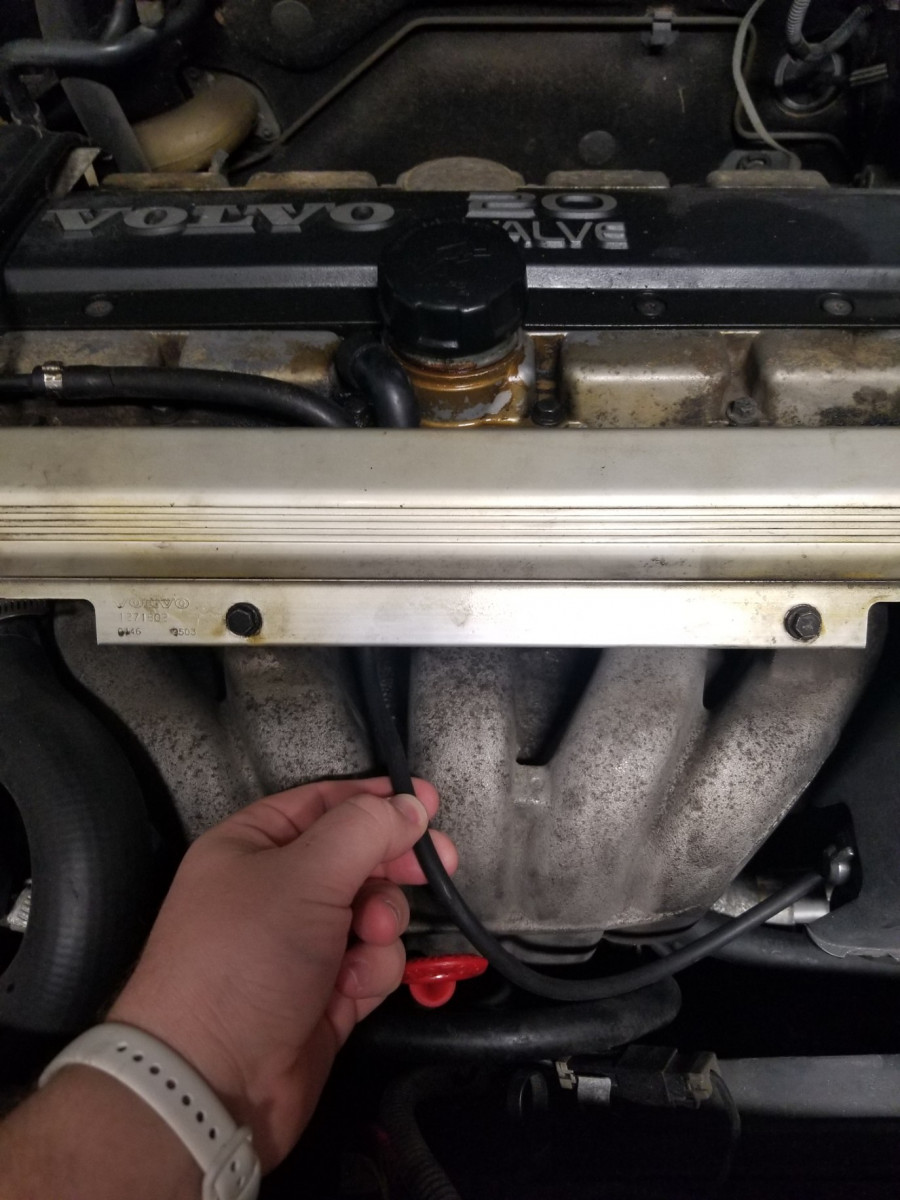

Hey Jfife83, it's on the fuel rail.jfife83 wrote: 03 Dec 2019, 08:36 HI there... you describe the exact problem I'm having with acceleration on my 2000 s70...can you tell me where the fuel pressure regulator is located?
Here are some handy dandy pictures.
My issue was the vacuum line that you can see me holding in the first picture. The line had swollen and lost its air tight connection.
You need to pull the two bolts on the fuel rail and, replace the vacuum line. Yours may be different depending on model year but they function the same way.
Hope that helps!

The fuel pressure regulator is not on the fuel rail for any S70 cars. That position will have a fuel pressure damper installed, there is no vacuum line to those and I don't think I have ever heard of any problems with a damper.
On a 2000 S70 the FPR is either down on the steering rack or back by the fuel filter. However the FPR still has a vacuum line like on this 850, and you can check the vacuum line once you find the FPR. Also common is the FPR fails inside, you'l know this if the vacuum line reeks badly of gasoline.
