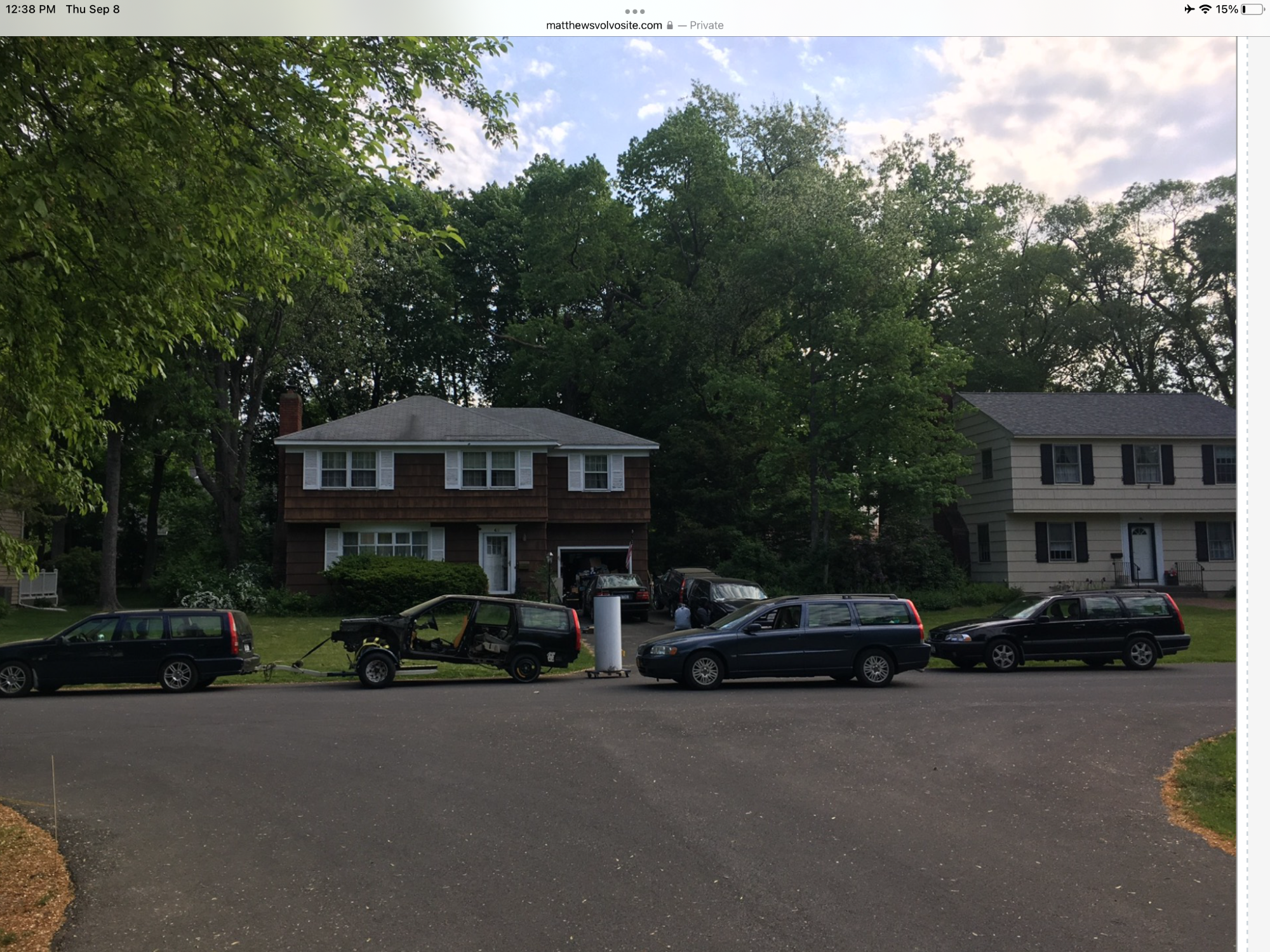

Mine made me move my water heater, tough enforcement……

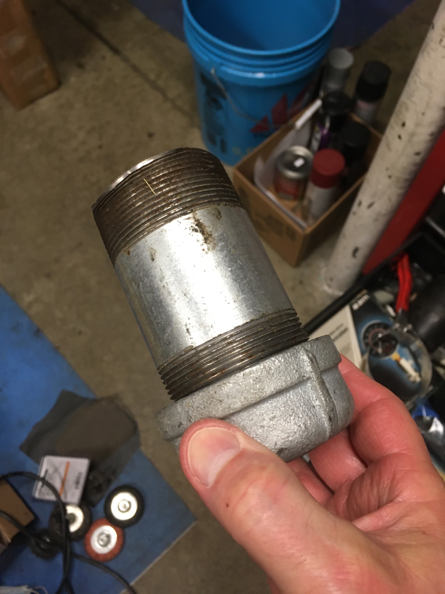

18 months, wow. That’s frustrating.
I did mine on the floor, but I think you could also do them on the car using the simple pipe method with a dead blow hammer. Diameter just wide enough to not pinch the ball joint boot. Ace Hardware.
Don’t pull the ball joint up tight with the bolts - it’s aluminum.

That's exactly what I was planning on using. 2" (I think?) threaded iron pipe with a cap. Thanks for the pic. Air hammer is on sale here at Princess auto (Canadian Harbor Freight) for $18 this week, that should help with removal. Key for this job is to have the right tools available in your arsenal, and patience. I don't want to go to the machine shop to do thread repair on the knuckle. I've only been working on cars for about 5 years now, so I'm still building my tool and skill repertoire.

The enforcer drunk wasn't sure if he saw one or four wagons but the WH... Hey!
