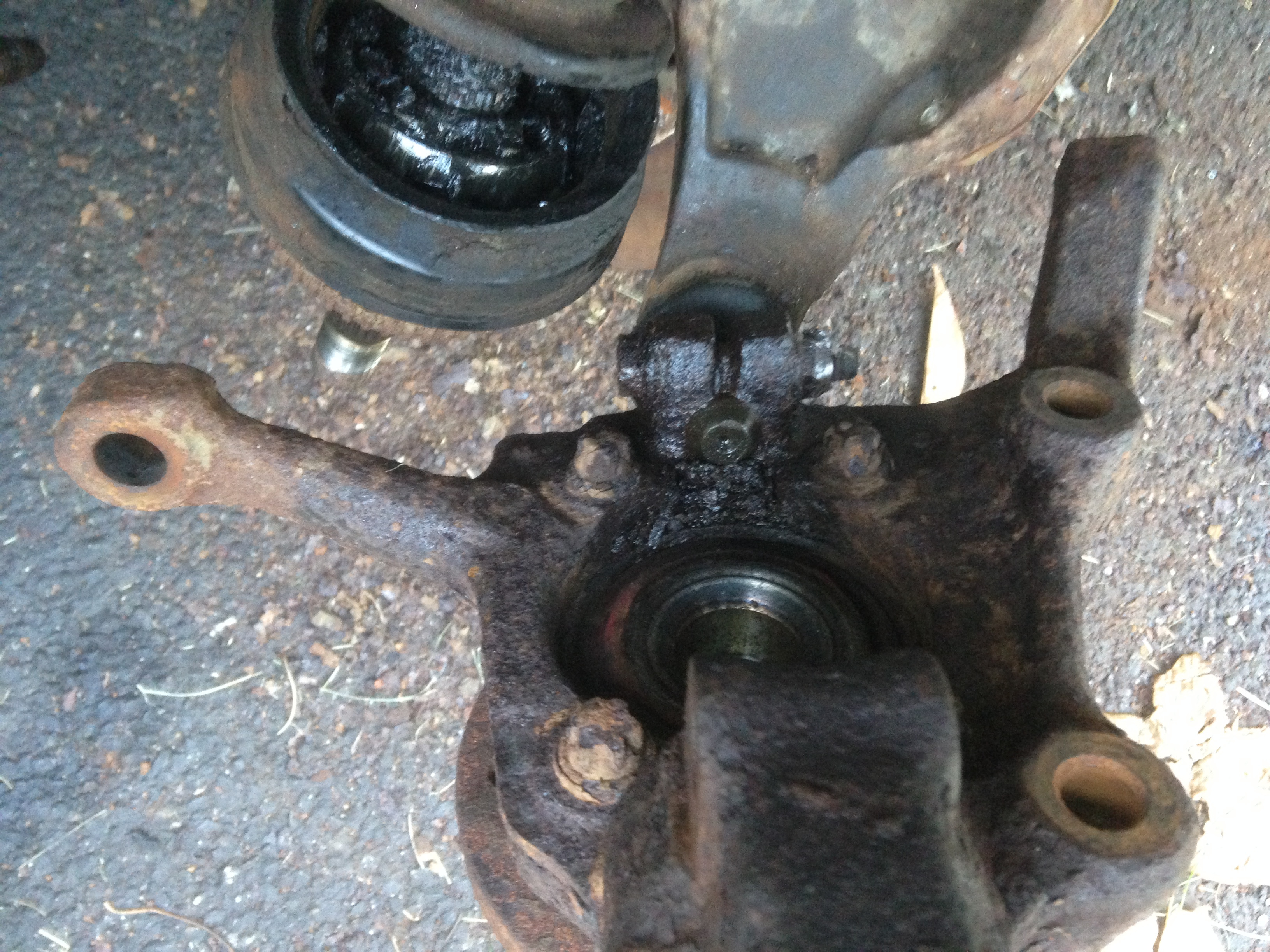

I tightened the top nuts to almost 45Nm. Way too much, so it's no wonder they stripped.
- Posts: 36147
Tighten the three spring strut mounting nuts to 25 Nm (18.44 ft. lbs.).gnalan wrote: 06 Oct 2020, 16:04 The small nuts were barely tight when I was trying to get the strut off, and I torqued them down to 33ft-lbs and stripped the bolts that the little nuts are on. Does anyone know what the actual torque specs are so I don't mess up the other strut when I do eventually get it on? Also the torque specs for the two big bolts, and the nut on the sway bar link?
The should not have stripped at 33 ft lbs but they aren’t hard to replace. You might have to drill them out if the plate. They don’t take much load, they just locate the top of the strut in the strut tower and stop it from falling down when jacked up.
The two knuckle to strut bolts need to be new and get two tightening steps. 50 ft lbs is a healthy arm pull on a 12 inch bar , then you tighten another 1/4 turn ( 90 degrees)
Use new screws and nuts. Tighten to 65 Nm (47.9 ft. lbs.).
Angle tighten 90°.
Sway bar link is 50 Nm ( 37 ft lbs), calls for a new nut but this one is less critical.
