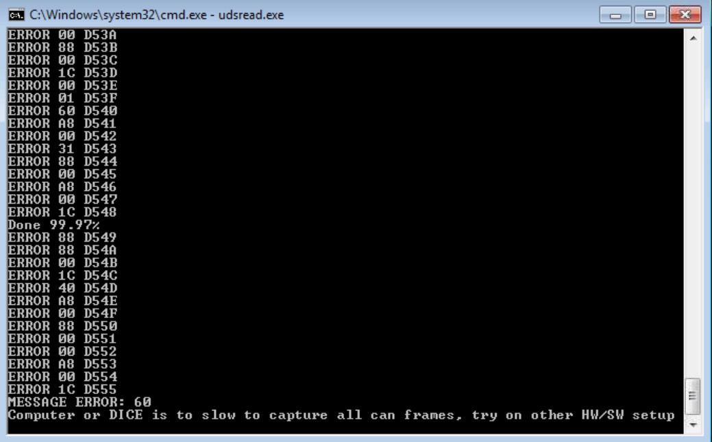

PontusLSE wrote: 18 Sep 2022, 09:21 The UDS cracker seems to be workingBut how fast is it supposed to be? I am running this on a virtual windows 7 and I get a new seed/line every 4 seconds. Is that normal?
59 hours and I just got the pin. Success!
However, the readout seems to be failing (see attached photo). Any ideas?
