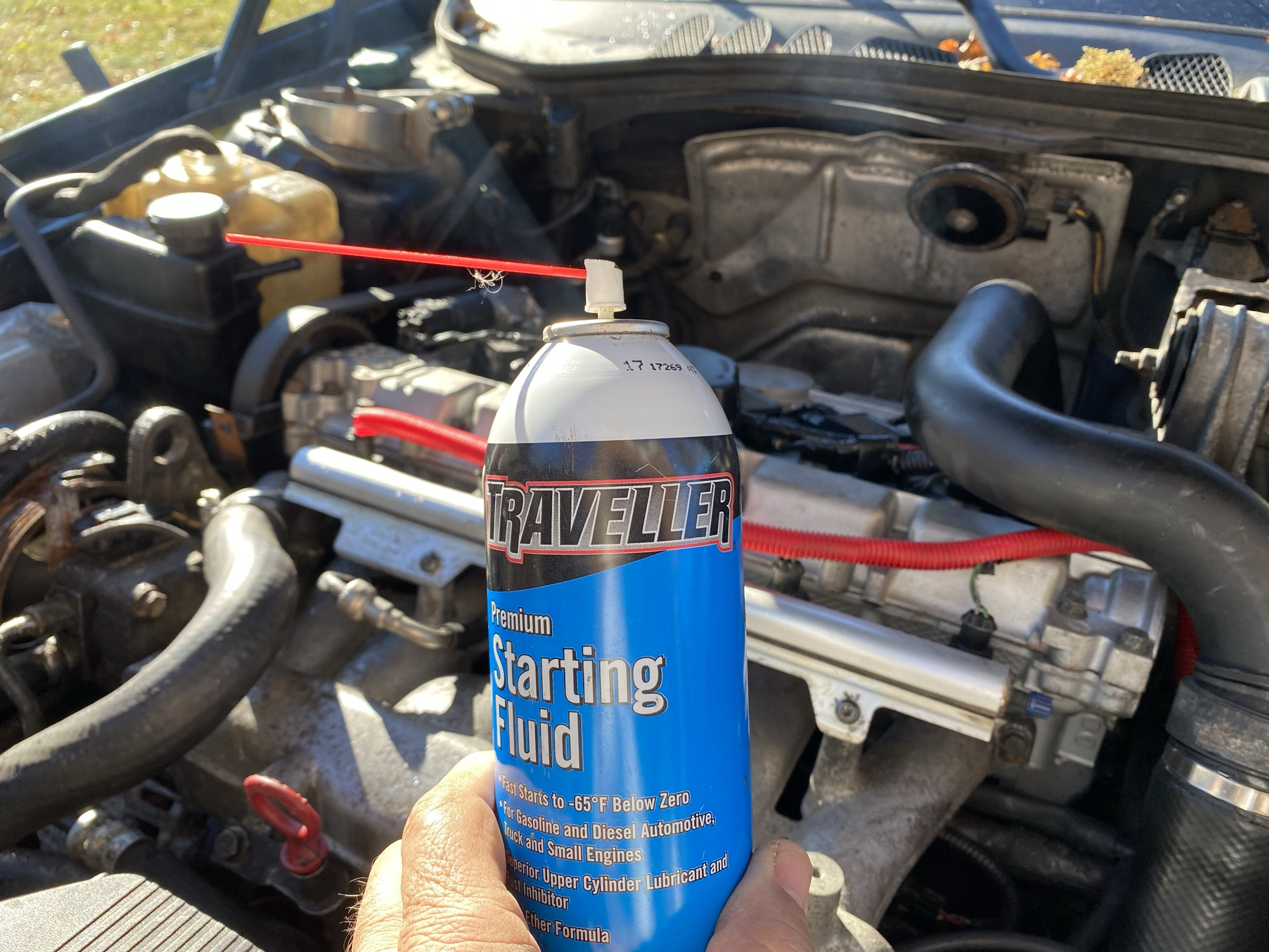

Quick update today
I put the battery on 10 amp charge overnight
In the morning, a 2 second shot of ether , tried the key. Sure enough, it was the unchipped one. Idiot!
Chipped key, and she sprang to life on second crank. Chugs chugga chugga running in 3-4 cylibers.
Pulled plug 2, plug looked like had been dropped, regapped it
Popped a cam flank angle code so don’t have cam timing set right yet, probably a tooth off. Cam flank reported at 12 degrees. Thread here
https://www.matthewsvolvosite.com/forum ... le#p541694
