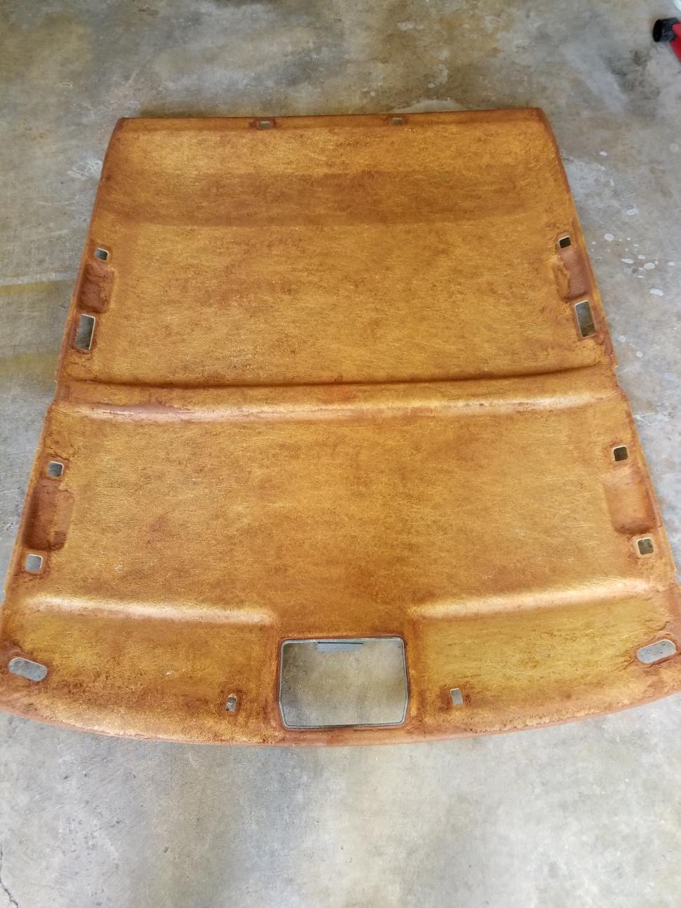

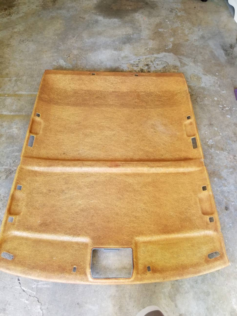

First you sand the liner to get all the foam off

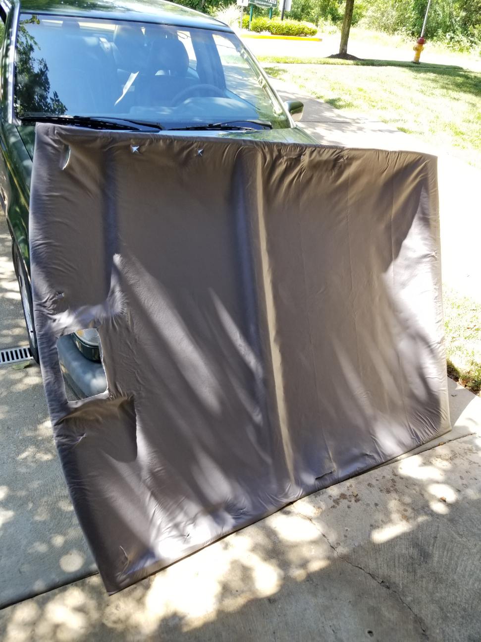

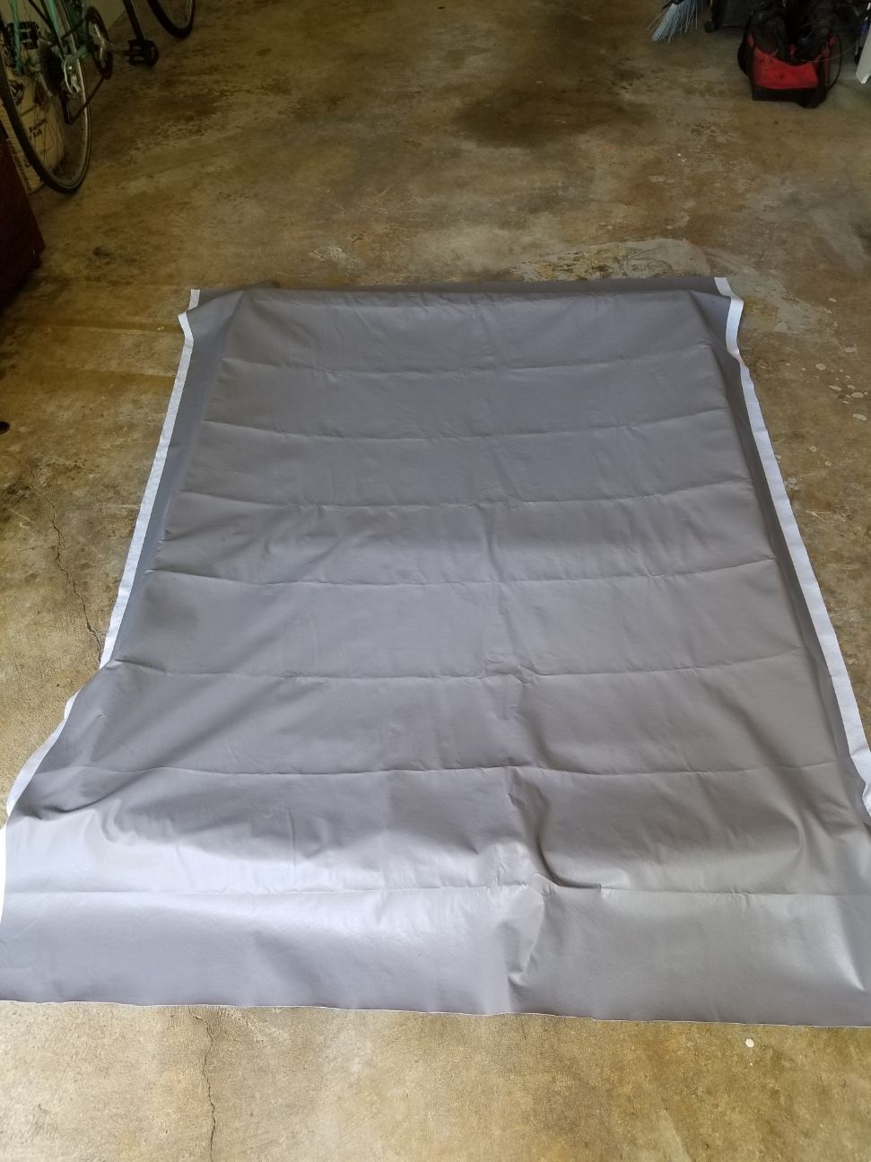

Picture of me test fitting the new vinyl. I decided to use vinyl as it is wipeable, and I do a lot of heavy duty stuff that requires wiping.
After you test fit you glue, and start from the center and work outwards. Make sure you get lots of glue in the recesses.

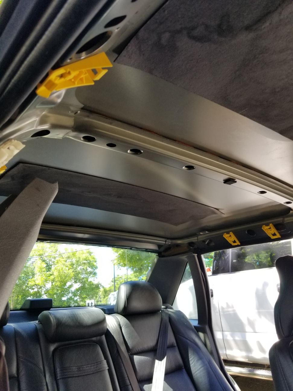

Here's a pic of the roof. Unbelievably clean underneath.
There's also some preinstalled drilled holes by the back doors, looks like you can bolt and accessory there not sure if anyone had seen those before or what they were for!
