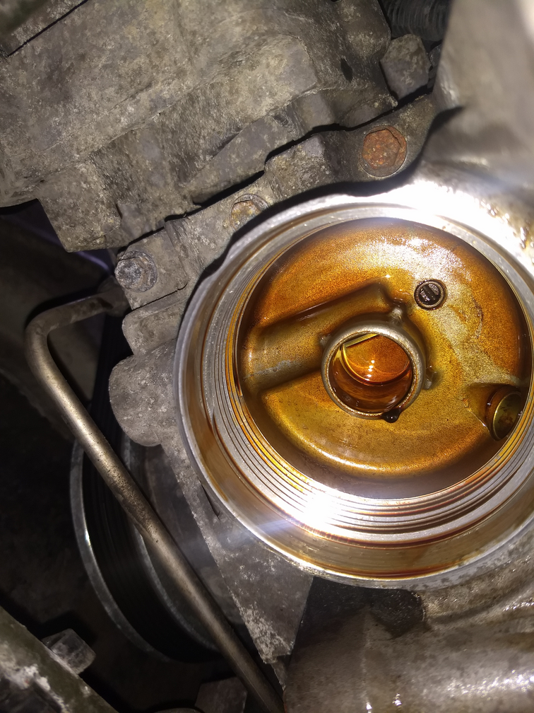

Had my engine rebuilt 2.5 years ago, the sump has been hot tanked and was shiny clean. Mobil 1 0w40 European Car Formula, 6k miles and 2 oil changes later, at a third oil change:
I don't like what I see. The car mostly sits in driveway, oil barely goes over 2k miles.

Looks a little like my partners RDX which exclusively ran mobil1 for a good while. I think its just staining and not something indicative of wear. I personally pick up tons of penzoil ultra platinum on sale with the rebates for a bit under 35 cad tax included for 5 litres.vtl wrote: 10 Jul 2023, 07:21 Had my engine rebuilt 2.5 years ago, the sump has been hot tanked and was shiny clean. Mobil 1 0w40 European Car Formula, 6k miles and 2 oil changes later, at a third oil change:
Mobil does not have as many detergents (mainly to protect the engine from the current oil, not to clean it from previous oil) as royal purple or penzoil ultra platinum specifically however that may not directly translate to a cleaner engine. There is a lot of knowledge on oil from a variety of generations so there is data online that is dated or not applicable to current blends (disclaimer).
I have not used mobil in my current car, but found in my p80 that the penzoil seemed to run a little quieter compared to mobil. Some youtube video wear tests showed it was a little bit of a "lighter oil" compared to other oils. Anyways this was more of a brain dump but id recommend going for some other brands to try as price wise it should not be that far off considering you are using a boutique "euro car formula" esque oil.

Oh, mind you... This is a cheap junk oil for meyanga001 wrote: 10 Jul 2023, 08:15 Anyways this was more of a brain dump but id recommend going for some other brands to try as price wise it should not be that far off considering you are using a boutique "euro car formula" esque oil.
I switched to Pennzoil Platinum (no Ultra) on my big Toyotas. Will try PP in Volvo in 6 months.
The reason I decided on that Mobil is that I saw a picture of a V70XC's sump with almost no lacquer or deposits at all. The owner claimed he used it since new, every 5k miles.
