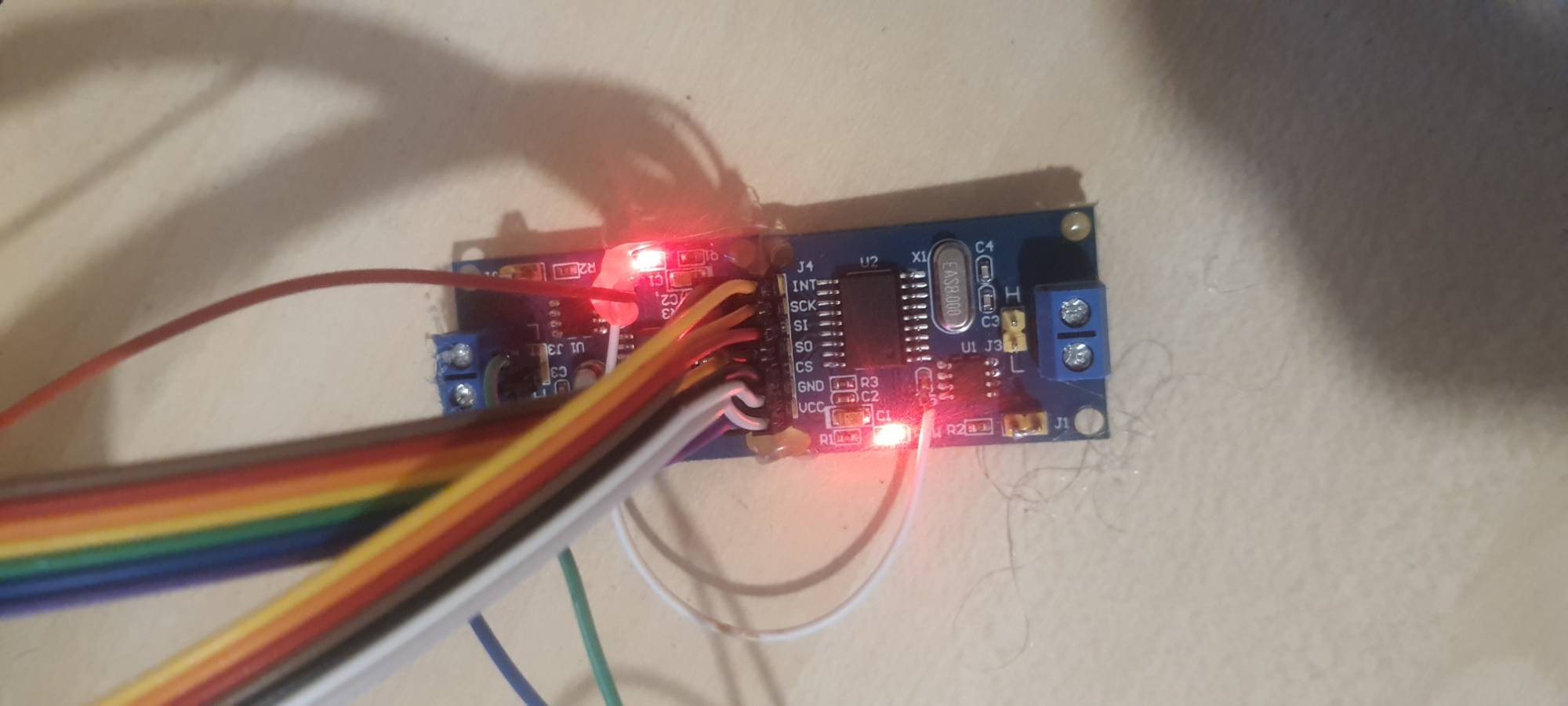

RPI4B with two CAN boards(only one is connected as the ECU is on the bench) with MCP2515 and TJA1050 wired to the ecu via female-female jumper cables. And 120ohm termination. With SPI bus clock forced constant.vtl wrote: 20 Jan 2023, 06:48How does your hardware setup look like? Photo, schematics?dikidera wrote: 20 Jan 2023, 06:39 Well, if I spam the CAN bus with 0xFF bytes(bits set to 1) as the data with no sleeps(so as fast as possible), transmission is good and there are no retransmitted frames(although I'd have to give that SBL to rkam so he can confirm).

Can you shoot a picture? Subtle nuances are important, like thin and twisted wires, good power, etc. I can't count how many people reported here that they've had problem with the cracker, only because of subpar hw implementation. Also termination is not needed when connecting to OBD port in car.dikidera wrote: 20 Jan 2023, 06:50 RPI4B with two CAN boards with MCP2515 and TJA1050 wired to the ecu via female-female jumper cables. And 120ohm termination. With SPI bus clock forced constant.
But it doesn't explain why rkam is also experiencing the same thing with his Kvaser tool.
Sending non-uniform data results in less signal transitions, CAN controller only has to do bit stuffing. My jerk-knee reaction was you have signal integrity problem in your hw.
vtl
- Posts: 4936
- Joined: 16 Aug 2012, 13:35
- Year and Model: 2005 XC70
- Location: Boston
- Has thanked: 130 times
- Been thanked: 686 times
Okay, a few things...
- computer power supplies are super noisy, you want to add a good filter or, better, use a lab power supply. My cracker literally stopped cracking one day when old PSU silently decided to go and made the power output noisy. Once replaced with a new/better PSU, it all cured
- always use a twisted pair for differential signal. They are twisted for reason. At least use a flat cable, so the + and - wires go side by side and pick up the same interference
- separate SI/SO physically from anything else, especially SCK, as they could pick up interference, and they are not differential
- make sure CAN transceiver get a lot of good power. It consumes a lot of power when it drives the signal at high speeds
- use as thin CAN wires as possible - that reduces wire capacity that CAN transceiver has to overcome
