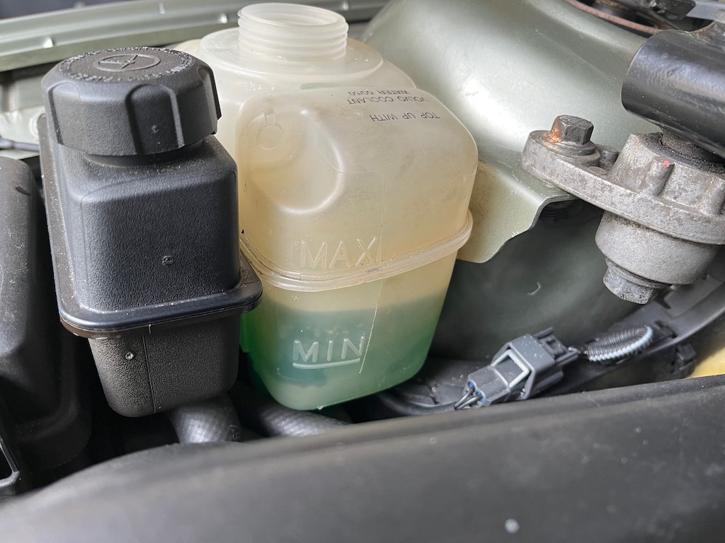

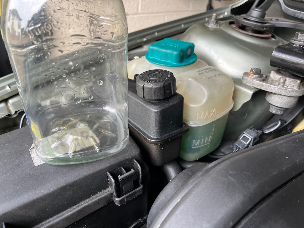

I checked the coolant level this morning and it had indeed dropped down a little.
I managed to get all of the remaining coolant I removed yesterday back into the system.

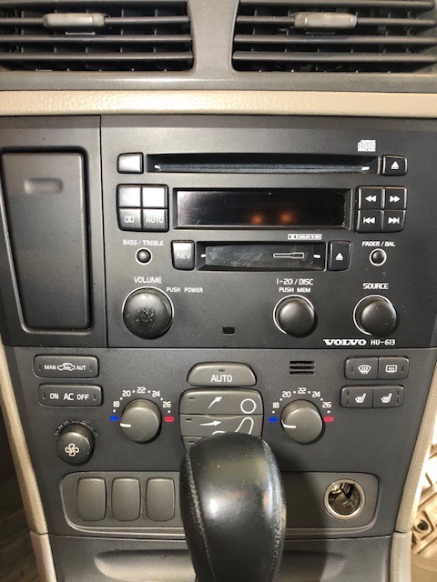

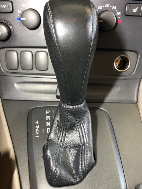

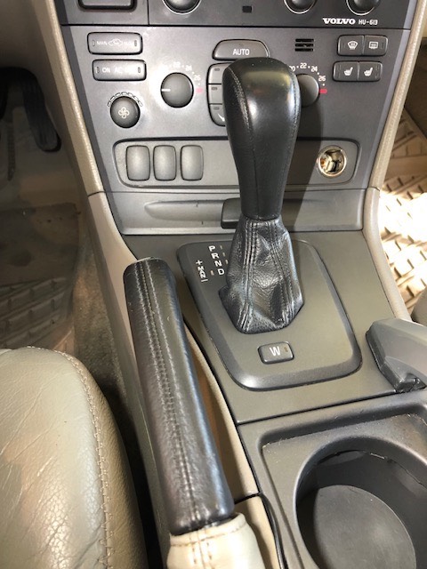

Installed a shift handle, leather E-brake handle and two good boots that I had sourced from the junkyard several months ago. Also put in a different radio (my volume knob didn't work and the radio head would change input sources and frequencies on its own occasionally. Its a slightly different colour but it doesn't look too bad and works better than the one that came out.
The E-brake handle is leather, unlike my original plastic one. I'm not sure if they offered a leather handle in other years or if I got it off an S-60 maybe.......it sure is a nice improvement. Both my shifter boot and E-brake boot were in awful condition, the faux leather was peeling and cracking off.

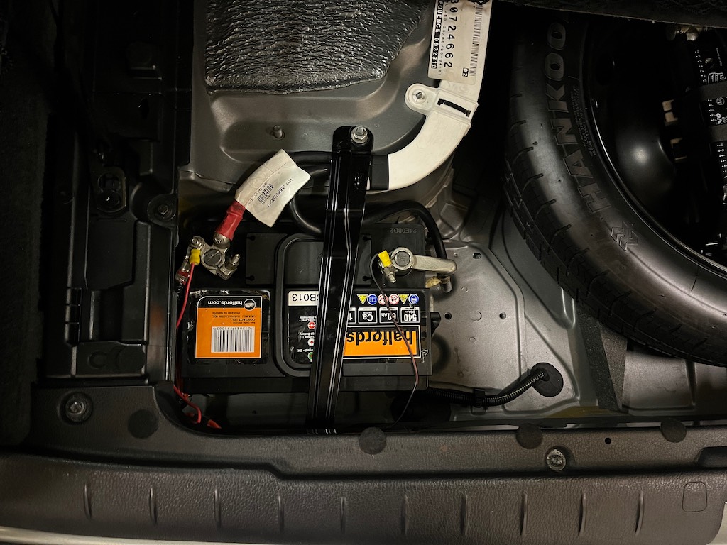

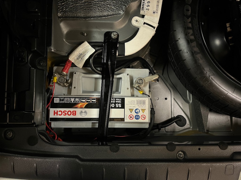

After fitting the new alternator I decided to check the battery side of things and whoever fitted the new Halford battery last year must have been on a budget and fitted a tiny 027. As I often travel up to the highlands in the snow I decided not to chance it and fitted an 096 Bosch battery today which is the size the 2.5T would have left the factory with. I know the battery tray will accommodate an 019 but as I don't have a diesel engine I felt that would be overkill for my car.
Halfords 027 (H5) Battery
Bosch 096 (H6) battery
