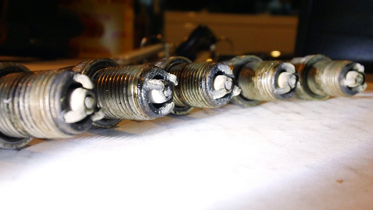

Are these the correct type?
Non-turbo spark plugs

Post by erikv11 »
Yes, those look lie the Volvo plugs for a non-turbo. I use those or Bosch coppers.

Little bit of carbon (if dry) or oil (wet) fouling on plug second from left. Not too bad though. Worth watching to see if it gets worse.
