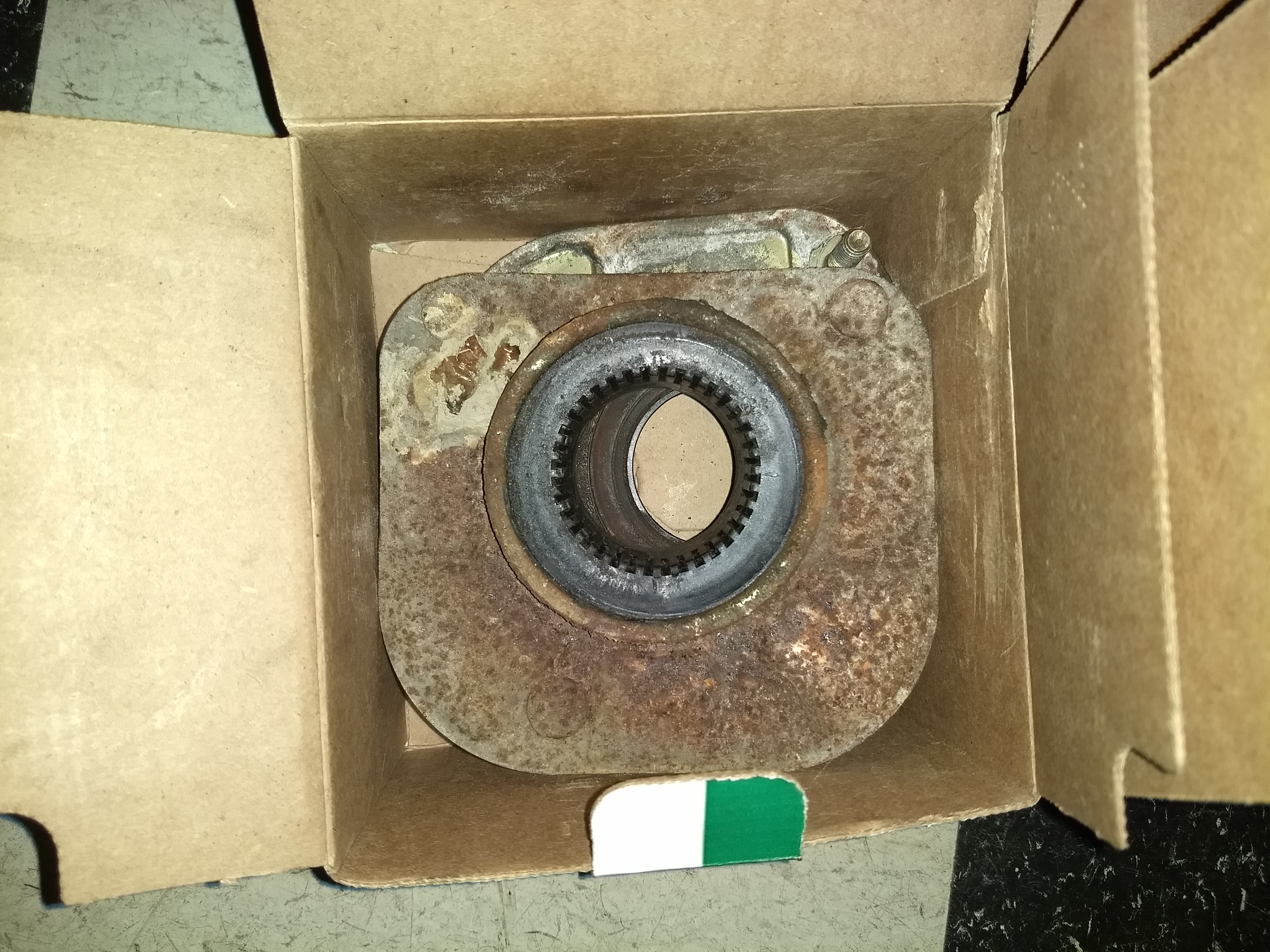

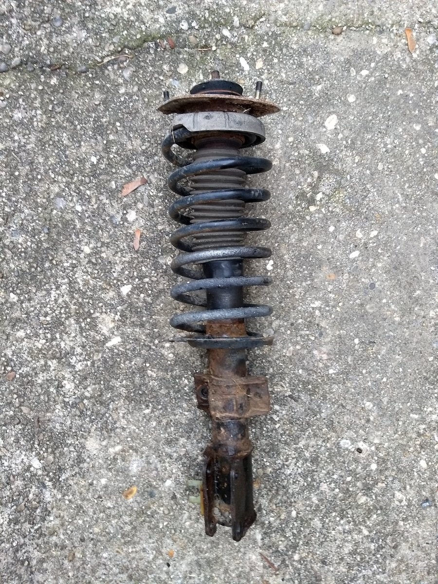

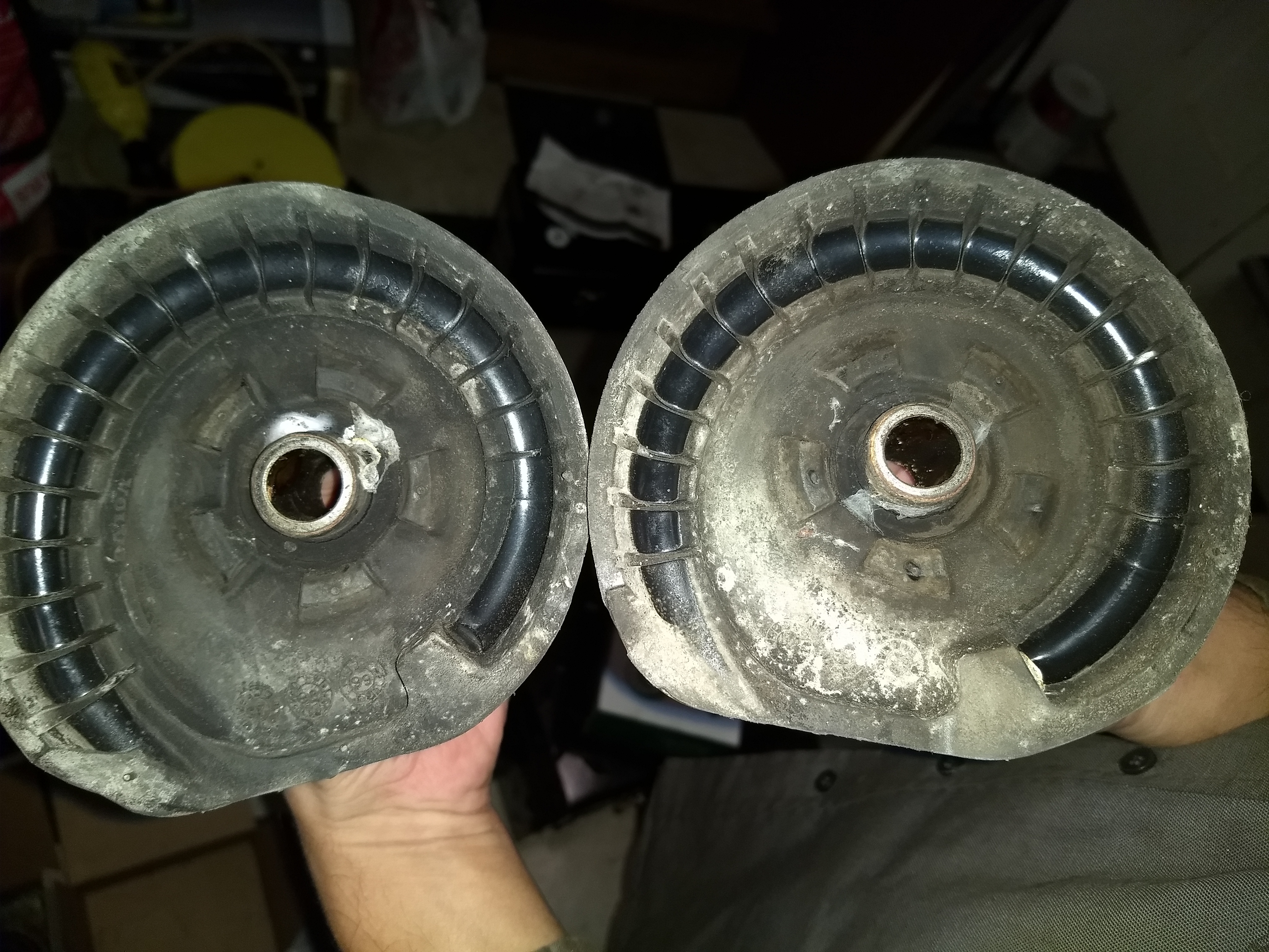

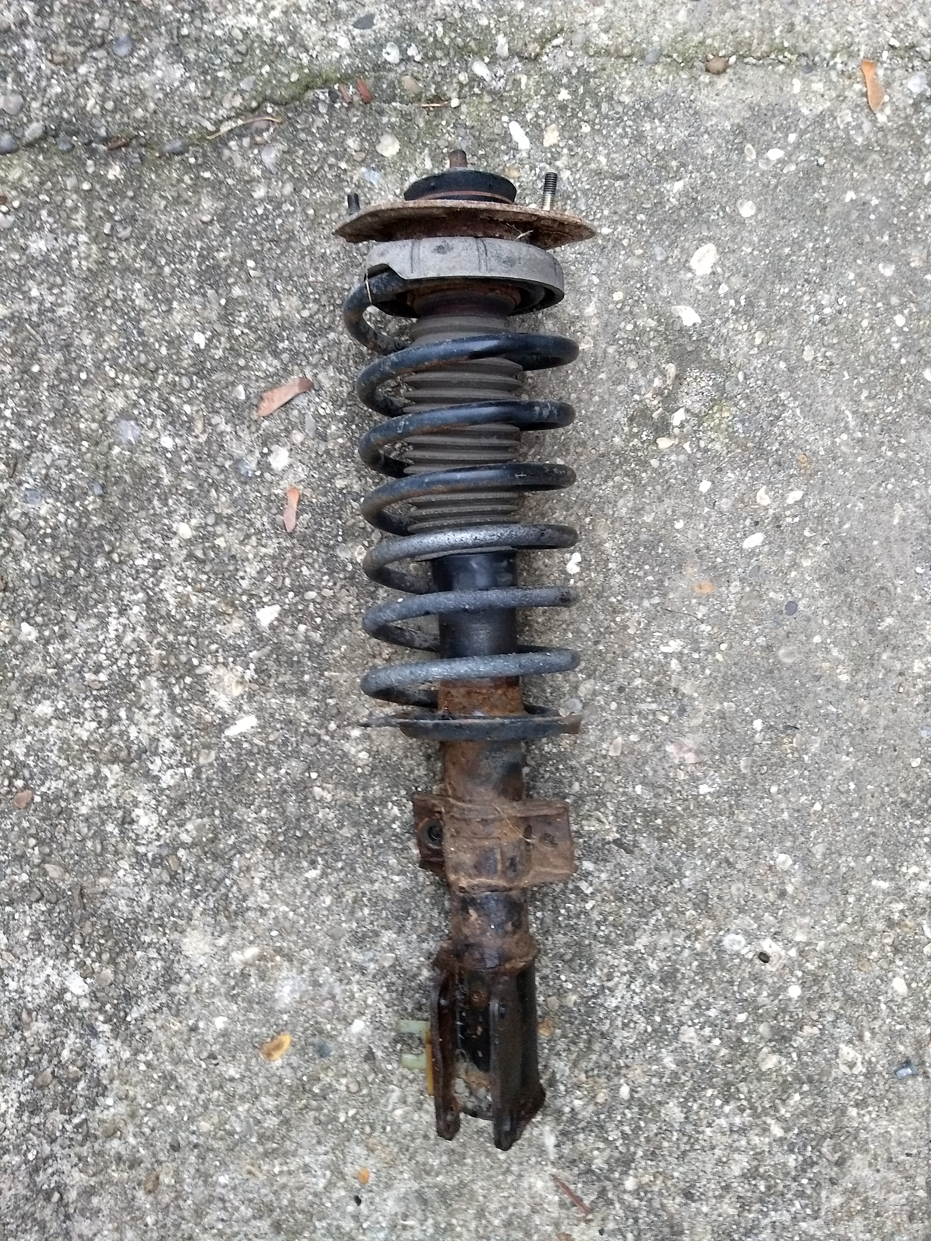

Swapped in some struts, spring seats, and strut bearings on my brother's 2000 V70.
Two things learned:
- Wow, those top nuts come off with an impact.
- Channellocks (16" ones) are useful for taking off the star-shaped nut.

+1. That's my go-to on the cross nut.theWIFES_S70 wrote: 03 Dec 2017, 13:50 - Channellocks (16" ones) are useful for taking off the star-shaped nut.

Plenty of rust and wear on the "new" 2000 V70!

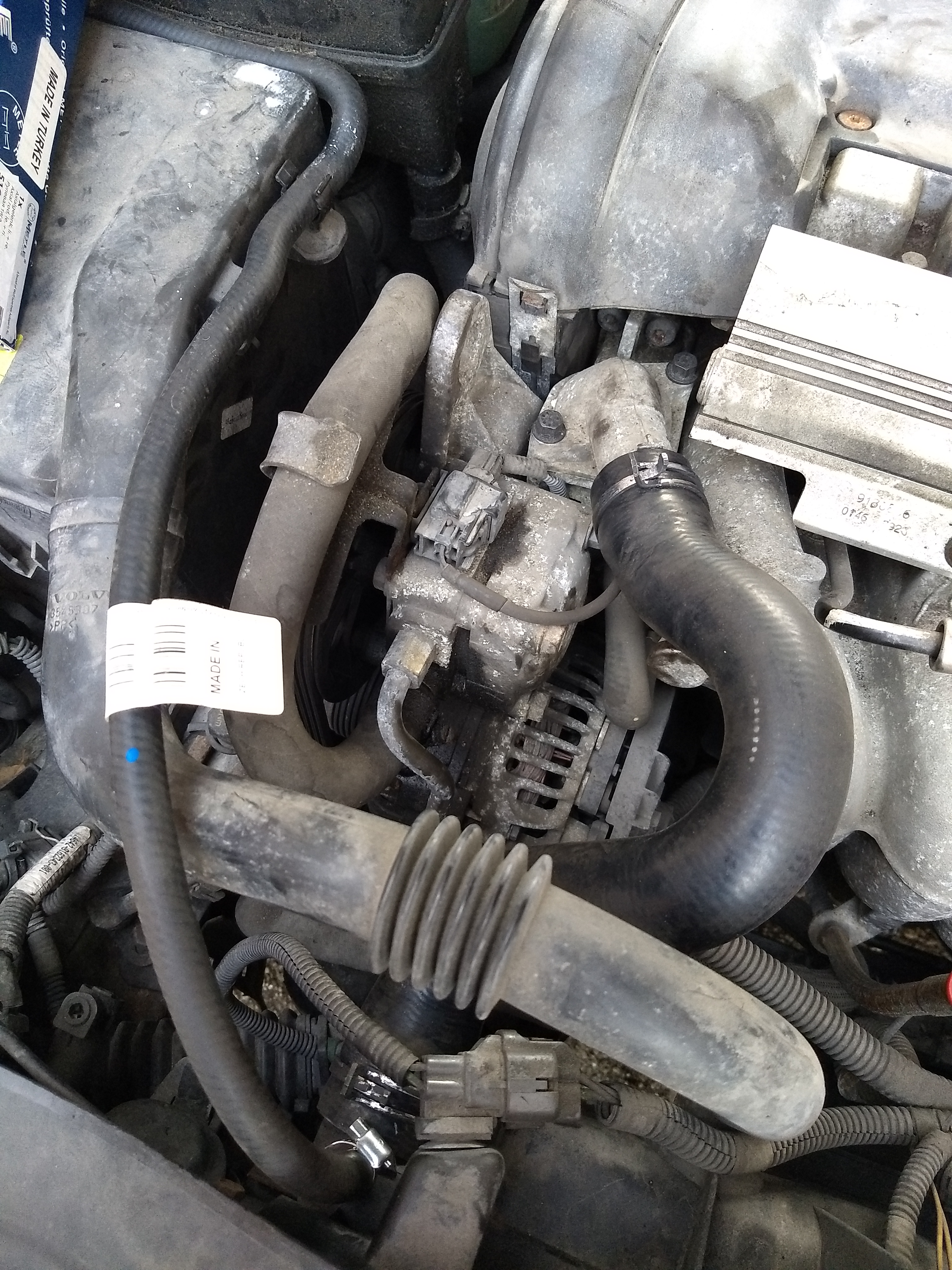

Before the strut job on the 2000 V70, I flushed the radiator and changed both radiator houses (Rein, with spring clips included!) and expansion tank hoses (Volvo), put in a new thermostat and replaced the coolant with the blue stuff.
Both radiator hoses were Volvo, possibly original, and swelling near the clamps.
In the process, found the front power steering pump looking degraded, and my brother noticed that the serpentine belt was installed upside down.

Your brother has been fooled by the bastards, 1999-2000, which change from his one sided serpentine belt to a two sided ribbed belt as the routing on your superior 2000 model.
One of the awesome mods here just recently posted a "serpentine belt routing" thread which shows both and the change.
