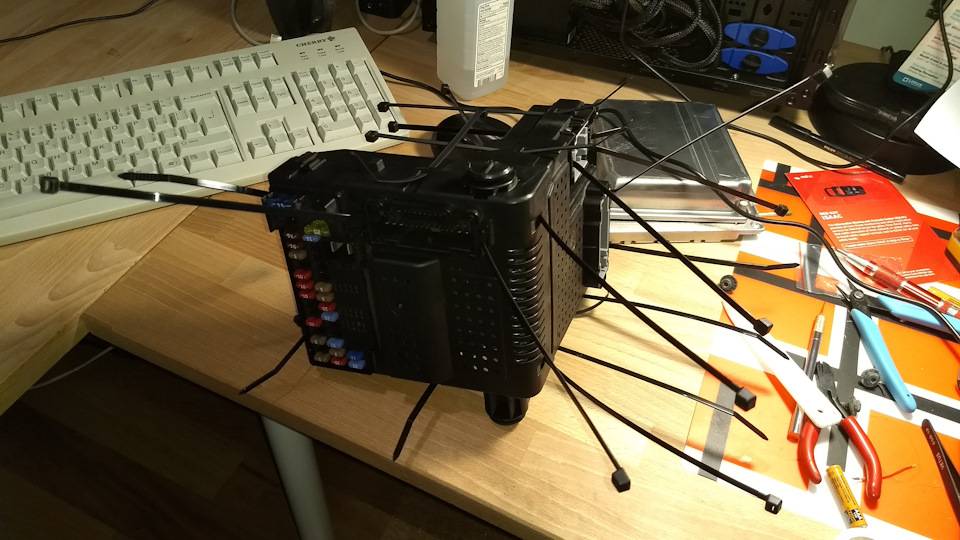

dikidera wrote: 09 Feb 2023, 16:13 And finally, how exactly do I safely open up my CEM-L? I am having a hard time pulling the little tabs on each side.
I managed to do it, it was a really frustrating job, I just hope I did not have any static electricity. as I touched some of the pins.
I mean
It is still a miserable job, but at least the tabs and not re-locking all the time.

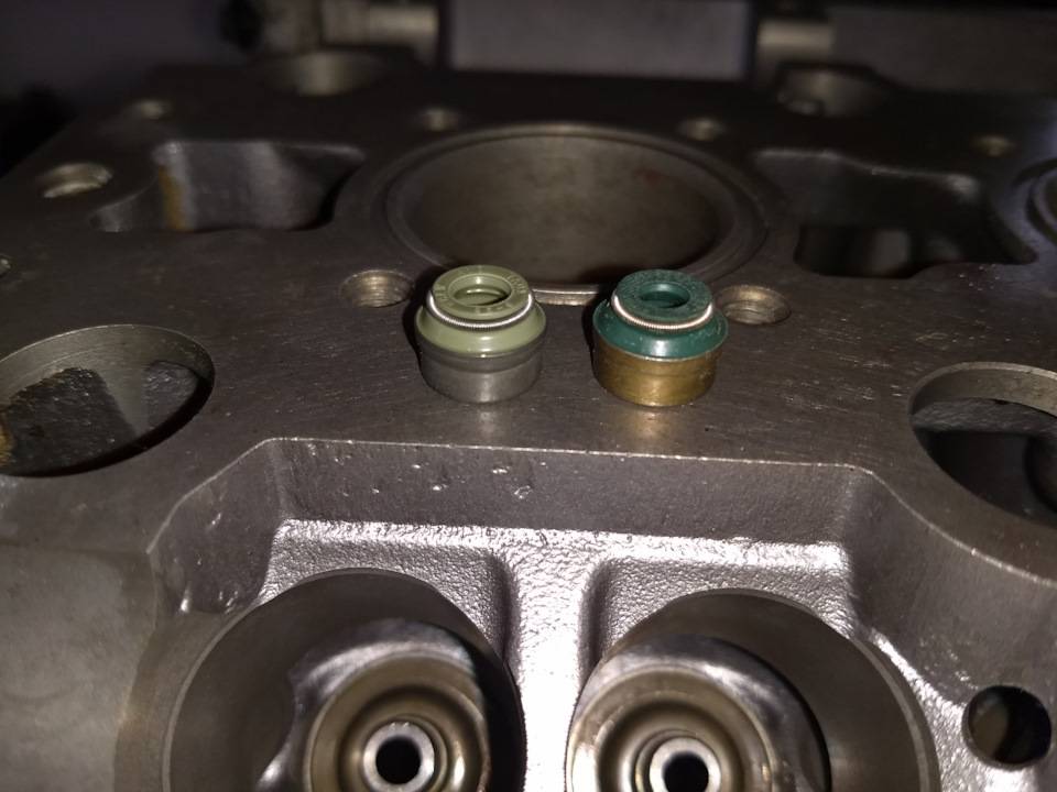

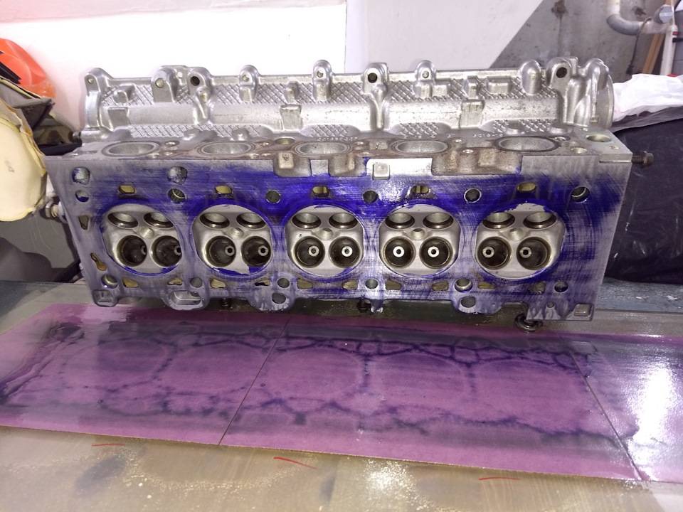

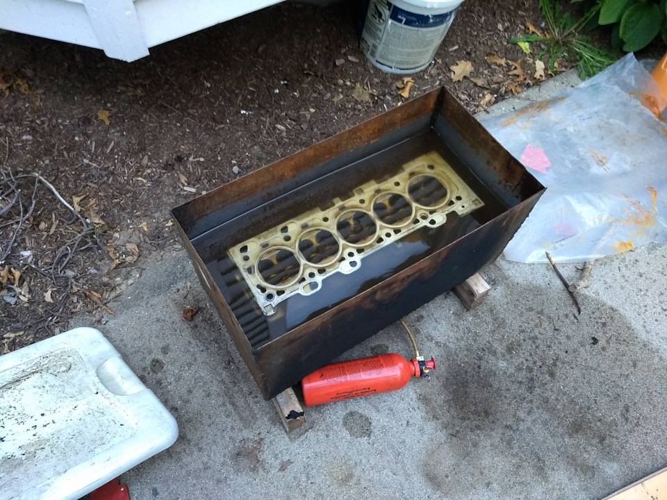

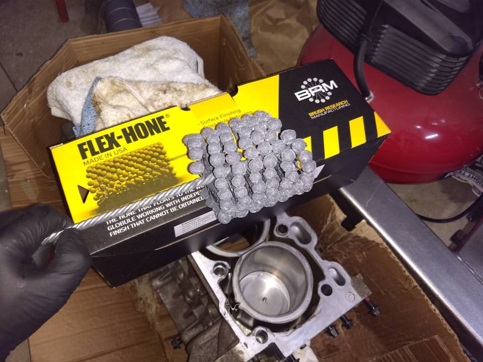

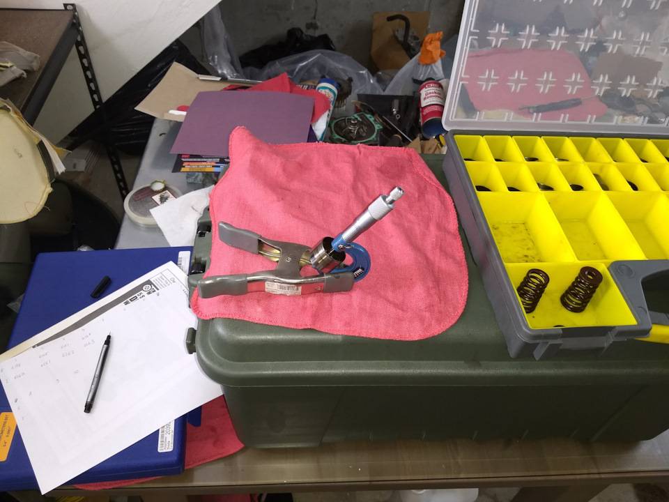

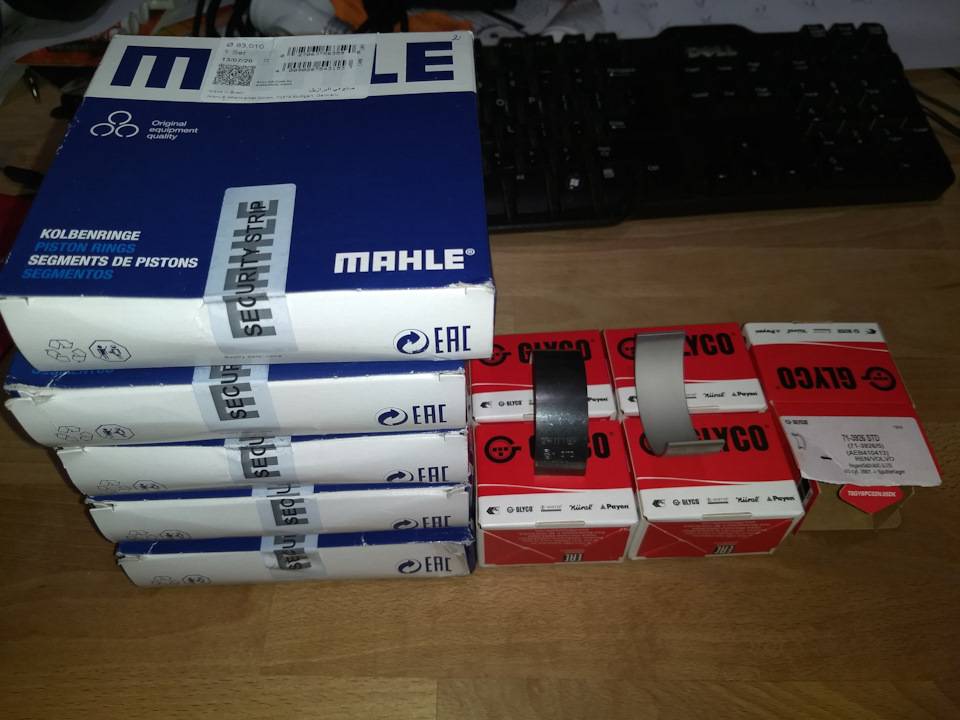

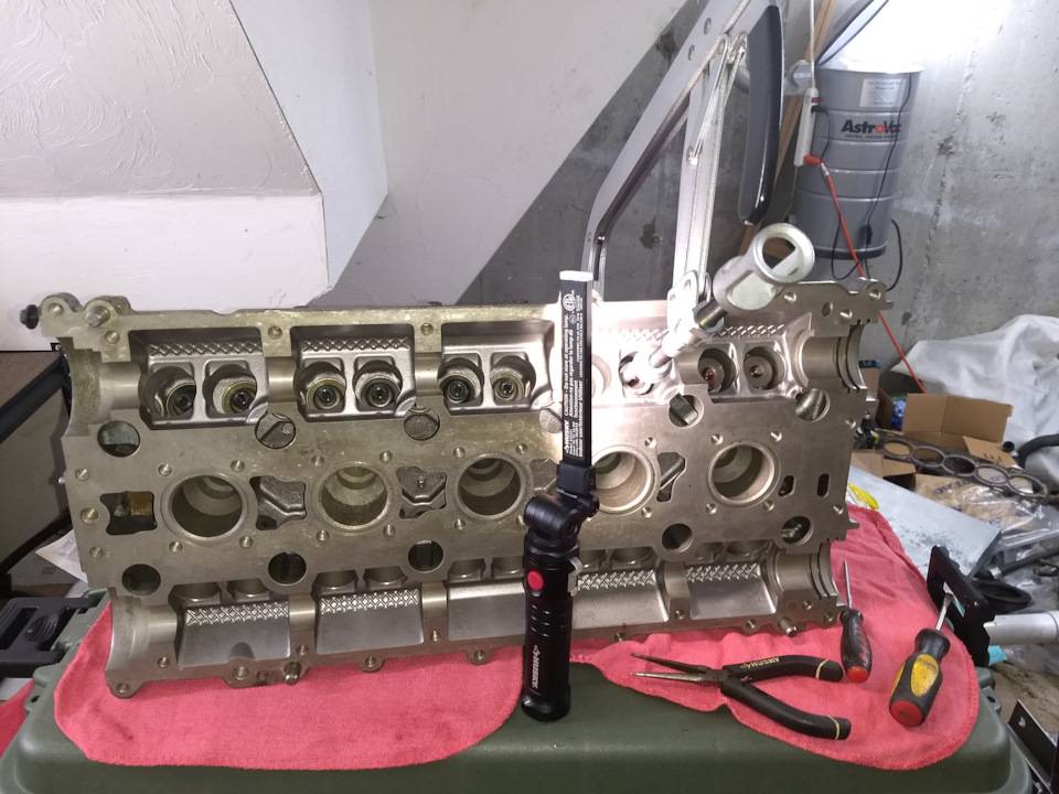

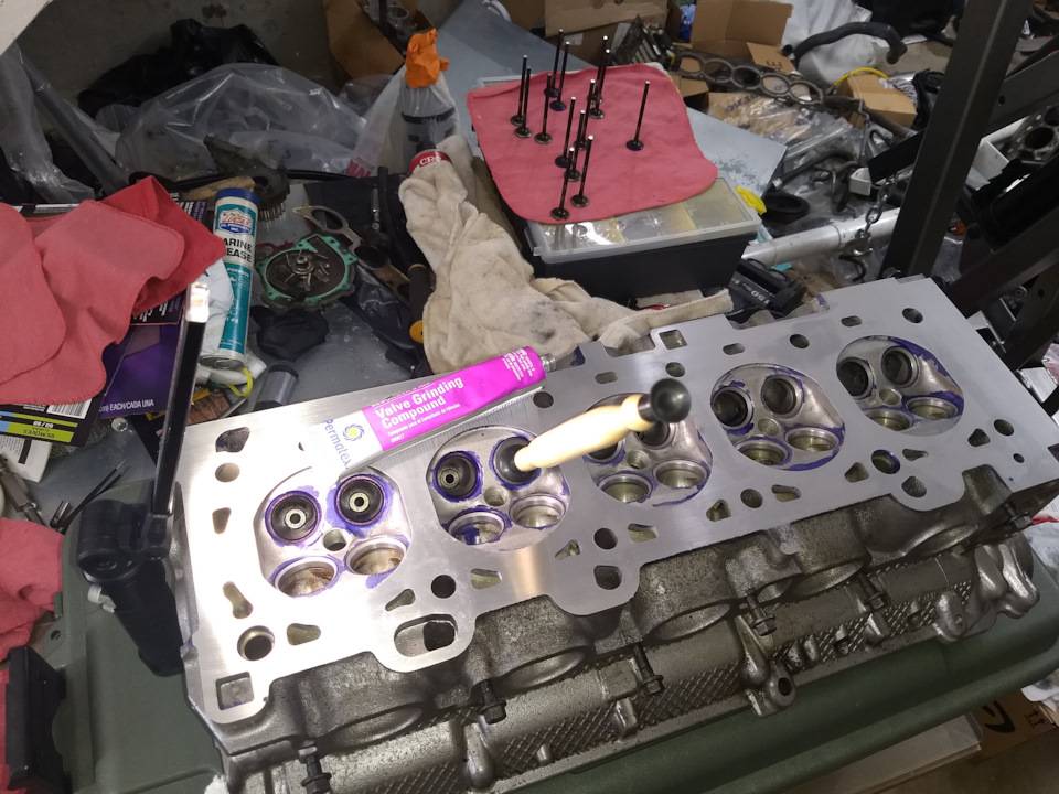

dikidera wrote: 10 Feb 2023, 09:03 Car died. I had a bad headgasket, and the increased power blew the radiator.
This is what happens when you crack your CEM at home! Same happened to me! Engine died! Leave CEM pins to the professionals! They have the tools and the expertise! ;)
Rebuilding engine is fun...
And so on...
