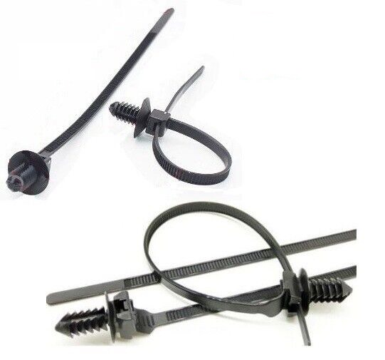

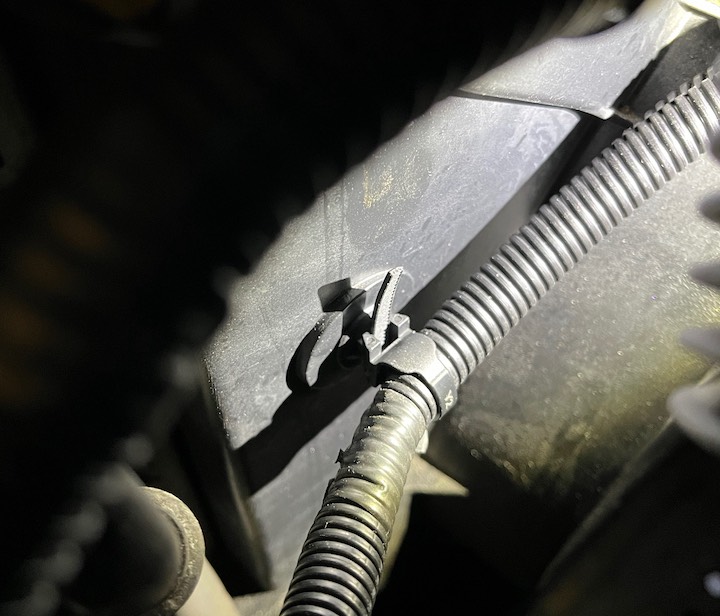

The cable tie clips to hold my harness to the fan cowl were all either missing or burst so I ordered some non Volvo ones from eBay and fitted them today, another job ticked off the list

Very cool. I still live mostly in the past where you bought things from the OEM, the local parts store, or it was not available.
I need to be reminded from time to time that Amazon has many things if you just look.

Good to know that they're available from Amazon, I've been hoarding them from vehicles in the auto wreckers but they're often a little "crispy" after 20 years!

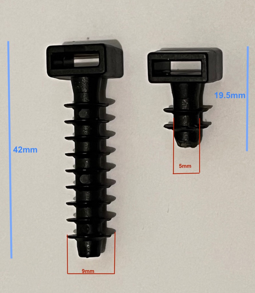

I had a bit of an epiphany this afternoon after I fitted the cable tie clips!!!
Although not impossible to release the cable ties, the location of them makes it extremely difficult to get to the tab with a tiny screwdriver to release the tooth that allows it to open, therefore cutting it is the quickest/easiest way when required.
When I built my garage back in 2008 I used cable tie clips for the lighting cables, drill a hole in the joist, hammer the clip in, put on a cable tie in and the job's a good-un.
I decided to take a look at the huge bag of clips I had today and although I've not tried on the car yet I'm sure it will go straight into the fan cowling allowing me to use a standard cable tie that can easily be disposed of and a fresh one fitted as required. Will update once I have tried it out
Originally 42mm cut to 19.5mm
