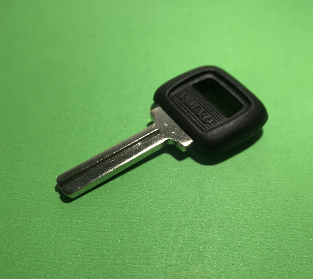

The keys are with the friend who's making sure the car doesn't get towed for Christmas, so I can't photograph the actual keys. So, this is a random picture from the internet, but this is what the keys look like - with the exception that the one we have is much more worn. The Volvo lettering on it is practically gone.

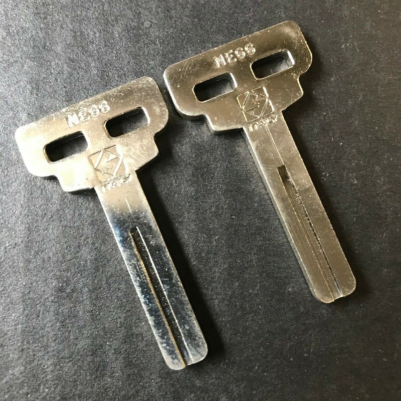

One of the keys, which seemed to run the car fine before all this, didn't even have the plastic head on it. It looked like this:
I'm guessing there's at least no chip in the all-metal key, if I know anything about keys - but the no-codes start-and-stumble-stop was enough to make me question my knowledge.
- Posts: 36147
That’s a key from a replacement tumbler. Confirms you do not have an immobilizer installed and it is pre 1999

If you look at the key in the above image that is not a transponder chipped key: They look like this:
https://www.ebay.com/itm/282903560704?f ... Swt21au~7t
The plastic part is much larger. Now that is not so say that someone may have replaced the key with an incorrect one. I am not sure of the metal blades are the same and can be cut to fit a 98.
