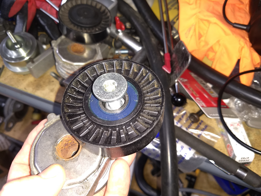

- You could have used the center bolt (on the pulley itself) to tension the belt.
- But anyway, I usually change the pulley ONLY, so not an issue for me.

This is the way I see serp belt in any car...
- Lifespan for belt is ~ 120K.
- Pulley ball bearings dry around 80K-100K, in theory, you can gently remove the seal and
add HD grease in that small space. It may give you another 50K of service if money is tight.
- When I buy a used P2 at ~ 100K, belt still serviceable, pully makes noise when spun by hand.
- So, I usually replace the serp belt + pulley at 100K-120K range.
- I keep the old belt and pulley in the trunk just in case (I usually grease old pulley before putting it in the trunk).
- If I ever get to 200K, then I'd replace the entire assembly.
- If you read reviews at FCPEuro, most ppl get > 200K on the original tensioner. But agian at >200K, replace the entire tensioner.
On the issue of broken Torx hole, some ppl mentioned using a strap or whatever to tension the belt for installation.
If the tensioner is good otherwise, why throw it away when only the Torx hole is broken?
