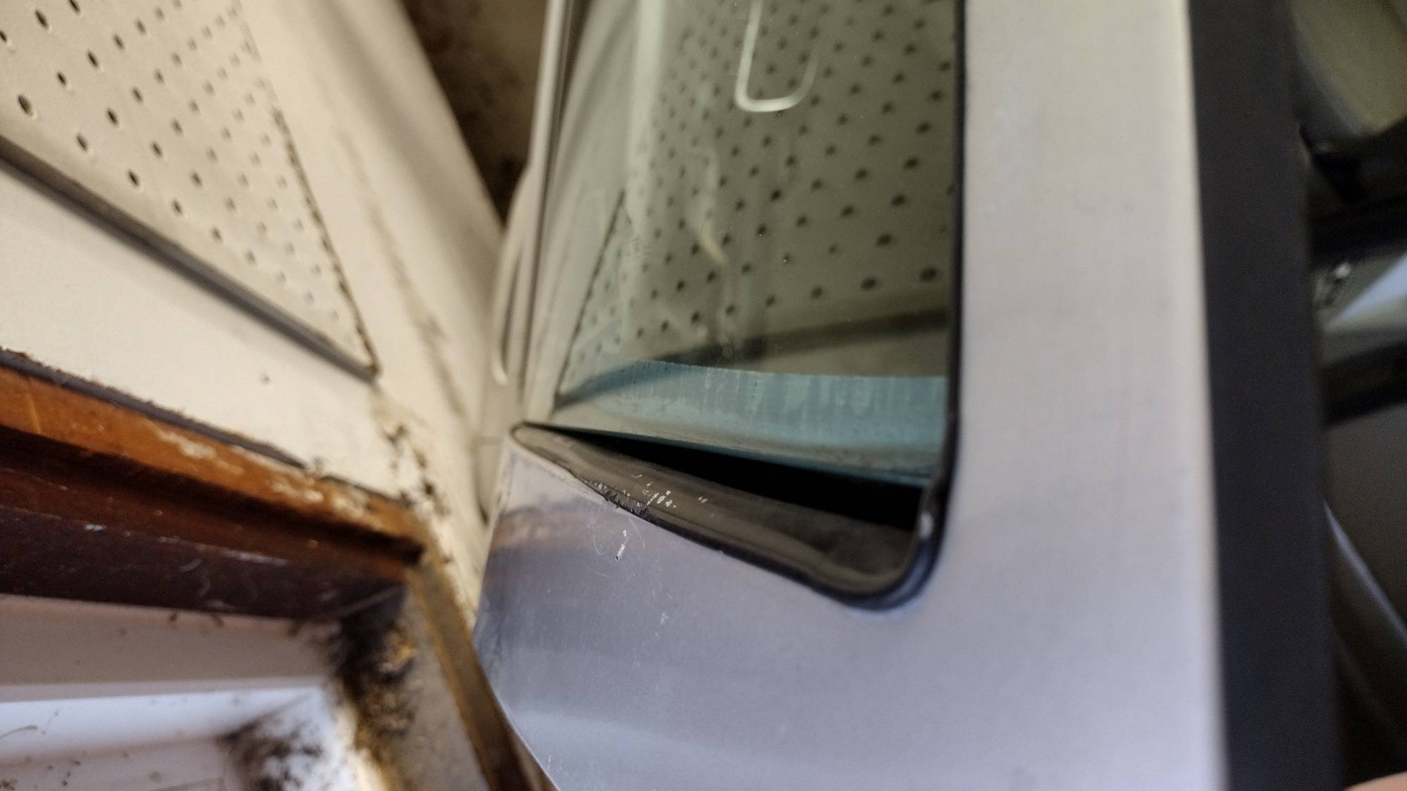

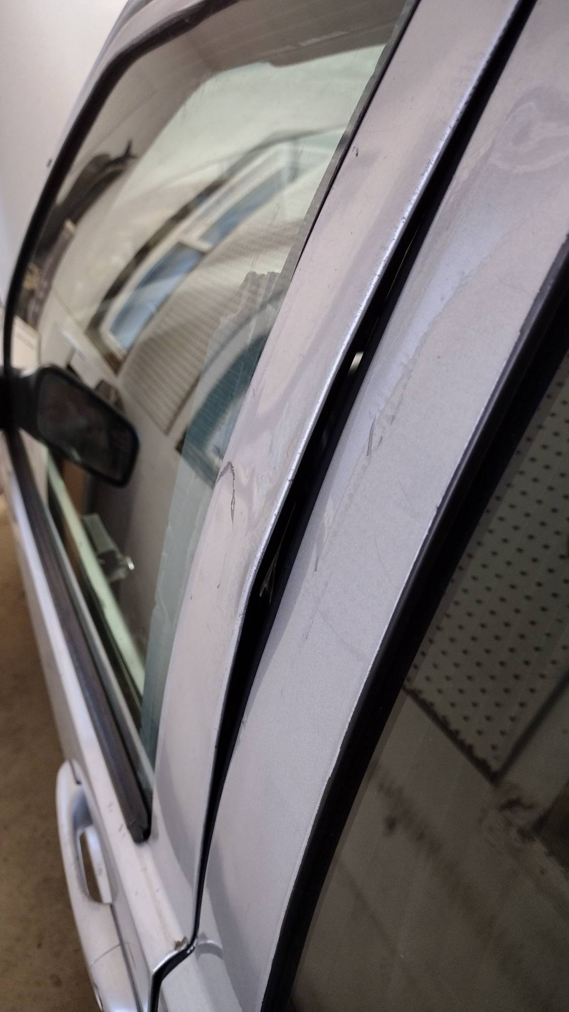

Finally got the passenger seat in. Heater core seems to be functioning well. The ECC is throwing a code for something.
Next on the list is the door gap. Unfortunately I think it's too bent up to be salvageable. The window is off track and that door gap is huge. I think the only good bits on that door are the mirror, handles, and speaker. I did pull a black (dark blue?) Door off an S70 that should be ready to go. Just need to swap the lock cylinders.

Ooof, yeah I think a replacement door is your best bet. It could probably be fixed, but it would take some patience.

I would talk to a body shop or a paintless dent shop if you know any good ones. You will be surprised what they can sometimes repair and without the need for painting which will likely be a lot more expensive. Looks like someone had the same issue as me last weekend when the only key and fob got locked in my friends car. The AMA (AAA in Alberta) used a large rubber wedge to bend the door outward, then used a small cell phone sized airbag to pump the door open and then slide a looped rubber around the door lock pull and it was open in a few minutes. This looks like the amateur approach was used!

scot850 wrote: 28 Jan 2023, 10:15 I would talk to a body shop or a paintless dent shop if you know any good ones. You will be surprised what they can sometimes repair and without the need for painting which will likely be a lot more expensive. Looks like someone had the same issue as me last weekend when the only key and fob got locked in my friends car. The AMA (AAA in Alberta) used a large rubber wedge to bend the door outward, then used a small cell phone sized airbag to pump the door open and then slide a looped rubber around the door lock pull and it was open in a few minutes. This looks like the amateur approach was used!
I was guessing it was broken into by more unsavory individuals, but I didn't bother asking. All the local body shops around here are either F rated or very expensive. I was quoted $1600 to fix a 1.5" x 6" rust spot on my roof and that didn't include paint, just sanding and bondo. I tried to have several shops work a crease out of my hood from a deer hit and none wanted to touch it. I do know a couple of former body guys I was planning to ask. But since I already bought a door, might as well use it for the time being.

If you don't care about the colour, then it is easy enough to remove and install with a bit of help. You could always keep the original door incase you can find someone to straighten it. You could try removing the glass and beat it with bits of wood and a hammer to see if you can straighten it enough.

I was able to get a front and rear door in my green color from a junkyard for $100 each with me pulling them (which is quite easy). They're not in amazing shape but replaced two which were hugely dented. Vastly cheaper than repairing, even including my time to get them and swap them. Consider looking for a silver one in your area instead of repainting the blue. My T5M has a large scratch on a door so I plan to carefully search yards for a top quality blue door to replace it. Heck, I'd consider buying yours if you're in the north east.

There was only a 98 S70 and a 00 XC available locally. I really needed a hatch and door, so unfortunately didn't have time to wait. The paint is completely trashed. So not too worried about color matching. The hatch has the typical XC rust under the decal, but it only looks like surface rust. Will sand and prime to stop it. The door I pulled is far from perfect. Lots of typical city parking related scratches.
