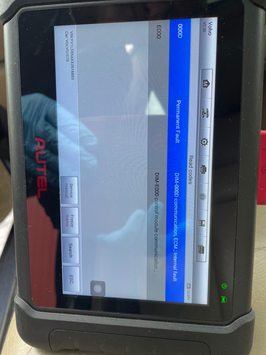

Ok, here are the two codes we unload from Mathilda, I want o dig I and understand if these are ECM faults or DIM faults

Link to an immobilized thread on a 1999 2000 with this code
viewtopic.php?p=589971&hilit=Dim+000D#p589971
One thing we didn’t check , a deep dive into the fuse box checking B+ and all the fuse box connections
